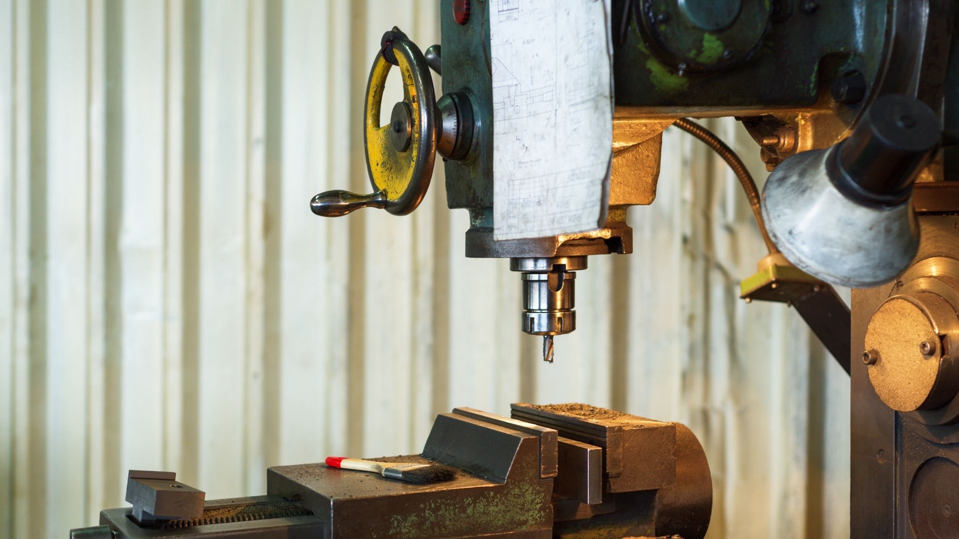

Tramming with a DTI
One of the most common methods for testing the tram of your machine is using a dial test indicator (DTI). The process is fairly simple, it’s accurate and doesn’t require a big investment since most of the tools required should already be in your toolbox. The method involves attaching the DTI to the spindle of the machine and test that the readings of the indicator are the same along two points of the X-axis and two points of the Y-axis.
Tools needed:
Step-by-step process
1 .Remove any vises and clean the tabletop thoroughly. It never hurts to use a brown India stone to remove any nicks and burrs that could give a false reading.
2. Attach the DTI holder to the spindle or insert it in the collet chuck.
3. If you are using 1-2-3 blocks or parallels, place them at an equal distance from the spindle along the X- or Y-axis, depending on which axis you are measuring first. The distance from the spindle, or radius, can vary. For accurate measurements, it’s generally recommended to set the radius at 6” or more.
4. Adjust the DTI holder to match the radius you selected.
5. Lower your quill until the tip of the DTI touches the parallel/table and zero it.
6. Swing the spindle 180 degrees and check the reading on the opposite side of the axis.
7. If the readings are the same, your machine is in tram. If the readings are different, adjust the head of the mill until the readings match.
8. Repeat the process on the other axis.

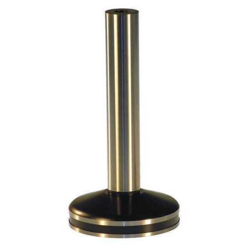

Tramming using a spindle square
Spindle squares make the tramming process more accurate and faster. These T-shaped tools are designed to fit into the collet chuck and feature two dial indicators at the opposite ends of a bar that is perpendicular to the spindle. To tram your machine using a spindle square, follow these simple steps:
1. Insert the spindle square in the collet
2. Lower the quill until the two indicators are touching the tabletop
3. Check that the readings on both indicators are the same
4. Adjust the head orientation
5. Rotate the spindle 90 degrees and check the tram on the other axis
Before getting started with this method, it is important to calibrate and zero both indicators. In one of the many great videos featured on his YouTube channel, Keith Rucker provides a great explanation on how to do that. Here’s the video.
If tramming using a spindle square, here are some of the tools we recommend:
Which is the best method?
Although all the methods listed above are simple and accurate, we’d recommend the spindle square method.  It’s simple, quick and accurate enough. The only downside is that you have to invest in a specific tool, but given the importance and the frequency of this process, it’s an investment that it’s worth making.
