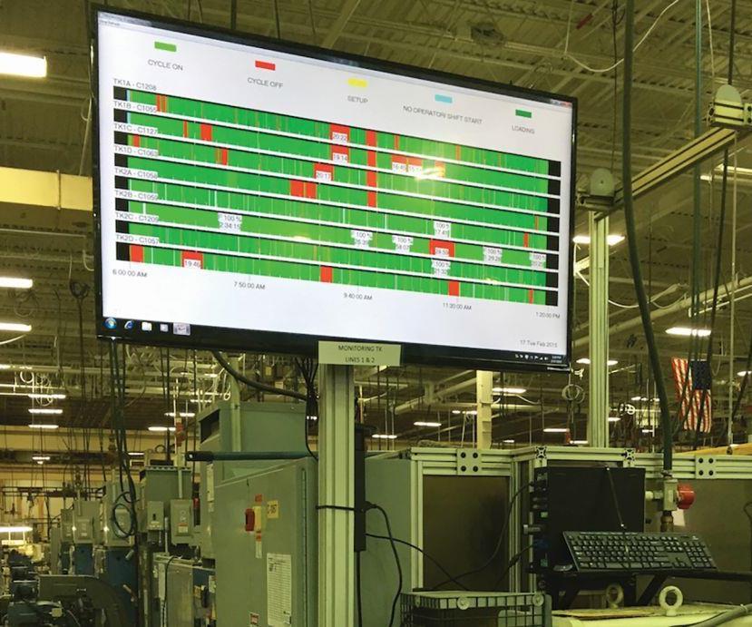

3. People Power in the Picture
Mr. Hosmon began by explaining that the productivity and the profitability of shopfloor performance has much to do with human behavior. How well operators are performing their duties to keep machines running and keep jobs on schedule is a major factor contributing to a shop’s success. The president of Refresh Your Memory Inc. (San Jose, California), the developer of the FactoryWiz Monitoring system, noted that customers are primarily preoccupied with concerns over machine performance and utilization. This is why OEE is a popular measure of shopfloor activities.
However, the data from machine-monitoring systems can also help a company enhance the contribution of shopfloor personnel in the productivity equation. In fact, this data can be a valuable tool for many human resource functions such as conducting employee performance reviews, managing incentive programs, setting goals and identifying training needs. To bring these observations to life, Mr. Hosmon relayed the experiences of Scott Shortess, the COO of Advanced Machining, a 55-person job shop in Owasso, Oklahoma. Mr. Shortess was unable to join the panel after a business conflict arose.
On his behalf, Mr. Hosmon explained that Advanced Machining was initially interested in machine monitoring because the shop tended to respond to production constraints by simply buying more equipment, despite the fact that added capacity was not always adding to the company’s profit picture. “We could see that Advanced needed more efficiency, not more machines,” Mr. Hosmon said. With the monitoring system in place, the shop could see where downtime, planned or unplanned, was impacting OEE. As the company found kinks in its workflow and started straightening them out, it also became apparent how much operator behavior had to do with machine output.
This led Advanced Machining to take a two-pronged approach to making effective use of the data from machine monitoring. One was a renewed focus on process improvements, especially as a result of more precisely targeted lean manufacturing techniques such as setup reduction and “next-job readiness.” The other prong was making the shop’s profit-sharing incentive program more effective. Mr. Hosmon said that the resulting data-driven performance reviews and corresponding payout policies were a big part of the effort Mr. Shortess led at Advanced.

A Gateway to Industry 4.0
I wrapped up the session by pointing out that machine-monitoring systems are affordable, manageable and likely to have a quick payback. I noted that most companies see a 10- to 20-percent uptick in productivity just by having performance data visible to the workforce. More importantly, once a machine-monitoring infrastructure and shop culture are in place, manufacturing companies can easily move to other opportunities for connecting machines and processes so data can be shared and responded to automatically. For example, self-correcting feedback loops linking machine tools, measuring equipment and programming software become practical. Likewise, it will be possible to predict and prevent downtime due to component failures or maintenance issues.
