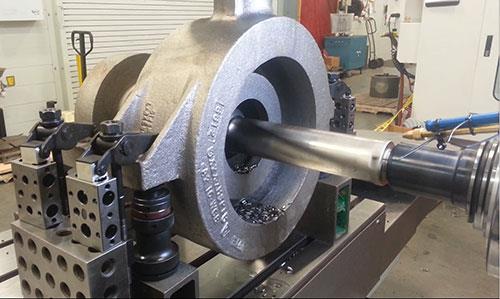

Hoosier Pattern has changed its business in a way that dramatically expands the design freedom available to its customers. Historically, the company has machined foundry patterns. Today, it uses 3D printing to create molds and cores directly from sand.

Mr. Murray’s message to customers has now changed. That’s because Hoosier Pattern has changed. In many cases, the company can now let customers cast precisely the parts they want to make. Rather than counseling customers to compromise, Mr. Murray now urges them to try to design the part that is optimal for the application. He often encourages them to look for ways that added complexity might remove unnecessary weight or improve the performance of the cast component. It is almost as if he is now able to say, Don’t worry about the manufacturability.
The reason for this new freedom is 3D printing. Hoosier Pattern recently expanded its capabilities—actually transformed its capabilities—by adding an ExOne S-Max sand printing system. This is a machine that 3D-prints mold components in sand without any need for a pattern or core box. The machine essentially makes sand molds without the middleman.
To established professionals in the foundry industry, this can seem weird. Pattern shops supply patterns and foundries pack sand around them to make the mold—that’s the way the industry works. For the pattern shop to skip the pattern and instead supply the sand mold is a change that Hoosier Pattern’s customers sometimes have had to pause to wrap their heads around.
However, this change both simplifies the casting process and overcomes many of its previous limitations. 3D printing of sand potentially makes casting both more efficient and more effective at the same time.
A pattern shop is a machine shop. Hoosier Pattern has around 30 CNC machine tools. For this reason, this company’s introduction of 3D printing is interesting not just because of its implications for casting, but also because of what it illustrates about 3D printing. As Hoosier Pattern’s example shows, 3D printing, or additive manufacturing, does not fit neatly into established manufacturing categories. That is, it does not directly take the place of processes such as CNC machining or conventional patternmaking, largely because its successes come from enabling parts that these conventional processes could not have produced. Rather than competing with any one existing process, additive manufacturing does something larger: It collapses the overall sequence of processes, and it rewrites many of the established manufacturing rules.
