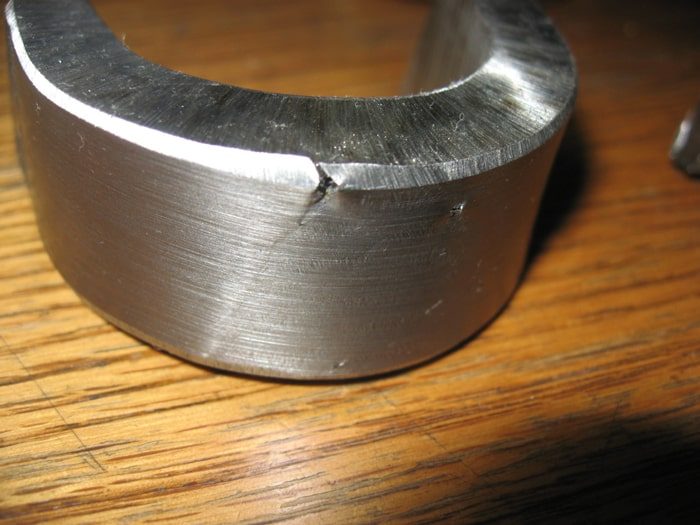

Flare bevel joints are common in structural fabrication. But for code-level work, welders must be qualified to weld this joint geometry.

Yet another common welder qualification issue has to do with the weld joint geometry. As Cameron explained, “Say a welder is qualified to weld on groove welds in the flat position, as well as fillet welds in the flat and horizontal position. That encompasses quite a bit of what’s done in a typical fabrication shop.”
That’s great—but then you see a worker welding a piece of square tubing. The tube is on its side, parallel with the base plate below. That square tubing has rounded corners, which produces a flare bevel groove weld joint geometry between the plate and tube. “I often walk into the shop and see this,” Cameron said. “The individuals welding these quite often aren’t qualified in that position.”

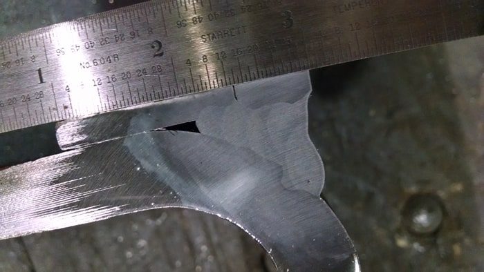

If a WPS cannot be prequalified, it needs a PQR based on a physical test, like a bend test.
