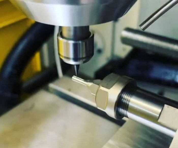

According to Mr. Davis, runout is one of the most common problems that hinder a micromachining application. The slightest error in the rotation of the tool can snap a tool or scrap a part when there is so little room to work with. Keeping the machine tool as rigid as possible reduces runout, as does investing in rigid tooling. The company says that collet chucks and shrink-fit toolholders are an excellent idea, but almost any steps a shop takes to keep the cutting tool steady will return the investment.
This mill is making cuts with a 0.080-inch ball end mill. Taking steps to keep the tooling and workholding rigid will help prevent runout that could harm the tool or finish of the part. (Photo courtesy of Alex Madsen from Madsen Machine & Design)
