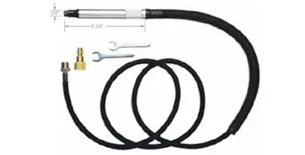

Nova Pneumatic 60,000 RPM Pencil Grinder
Order Now
This Nova Pneumatic pencil grinder includes a 1/8” collet, 2 wrenches, a hose and different air fittings. The maximum air pressure is 90 PSI so make sure this is suitable for your application needs. Although die grinders can get pretty loud, this pencil air grinder has a smooth and quiet operation.

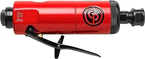

Chicago Pneumatic CP872 Air Die Grinder
Chicago Pneumatic CP872 – Air Die Grinder Tool
Order Now
The rear exhaust directs the air away from the workpiece and the built-in regular matches speed to the job. The Chicago Pneumatic runs a free speed of 22,000 rpm and has  a hose size of 3/8-Inch. The speed control mechanism will ensure you maintain optimum RPMs and achieve the highest levels of productivity.

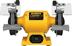

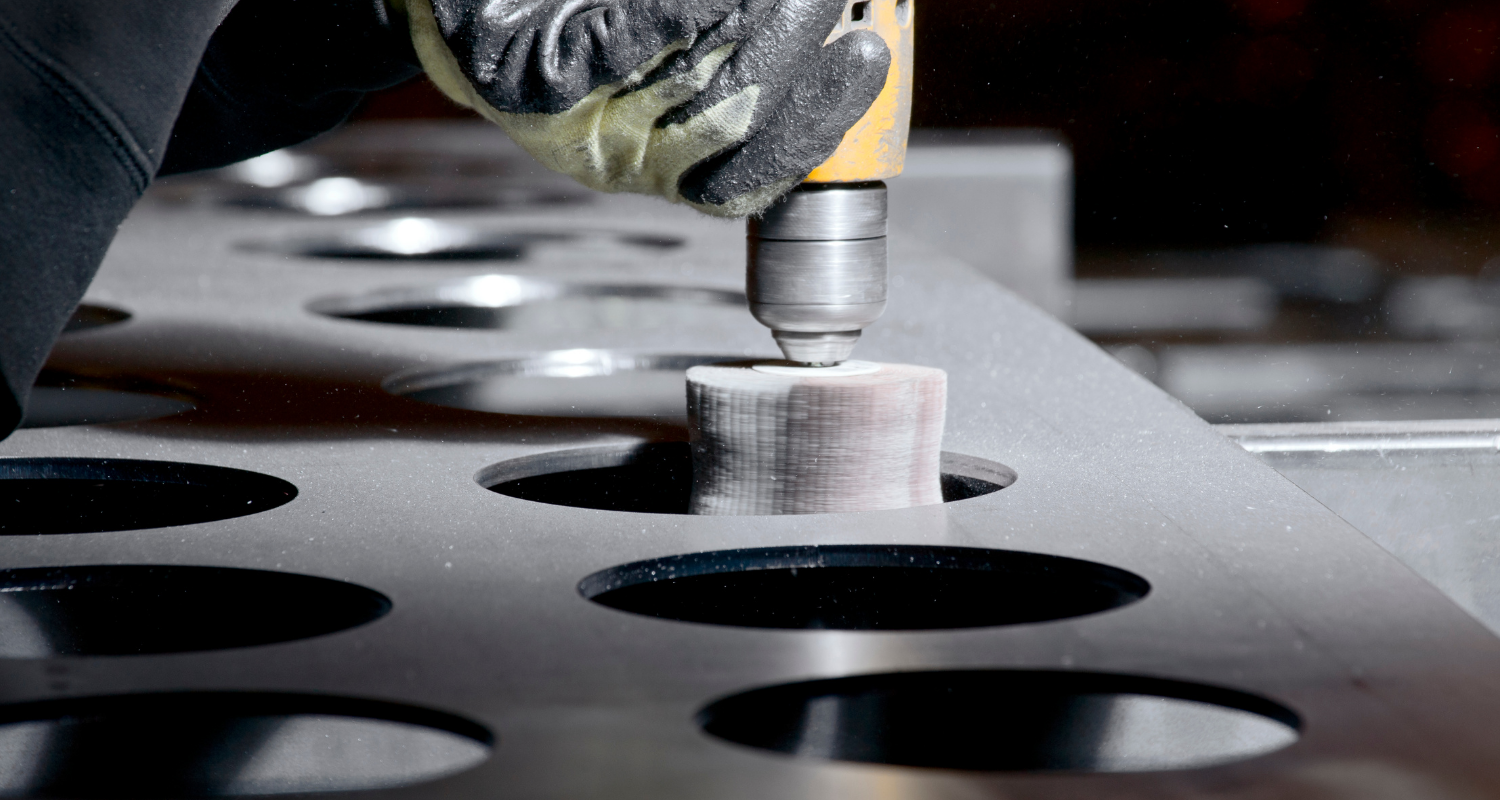

Using a grinding wheel is great for heavy material removal along one spot. Wheel grinders are used for both polishing and deburring, so it is important that the wheel you are using with your bench grinder is designed specifically for cutting. To learn a bit more about grinding wheel best practices, take a look at the video below.
DEWALT Bench Grinder
Order Now
This grinder features a powerful 5/8 HP induction motor for heavy-duty grinding operations and the motor runs at 3,450 RPM for high speed material removal.

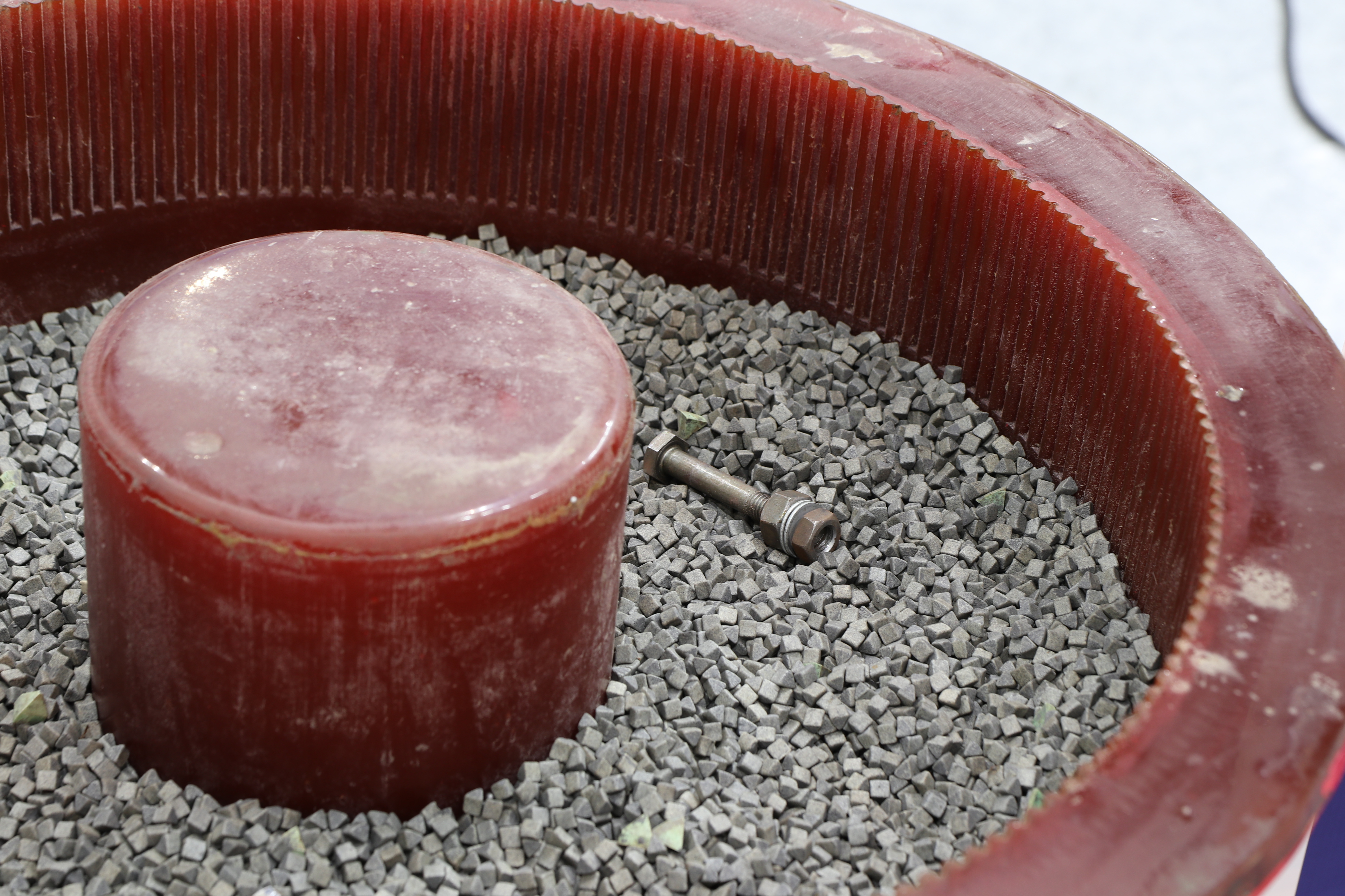

    And of course, TIME SAVERS AND PART TUMBLERS
