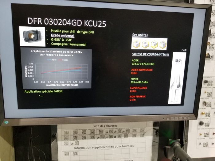

The customized page display shows all the information the machinist needs in one page; no scrolling is necessary. This PC is dedicated to this one purpose.

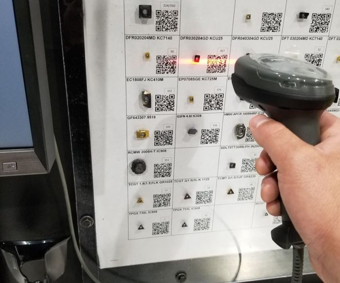

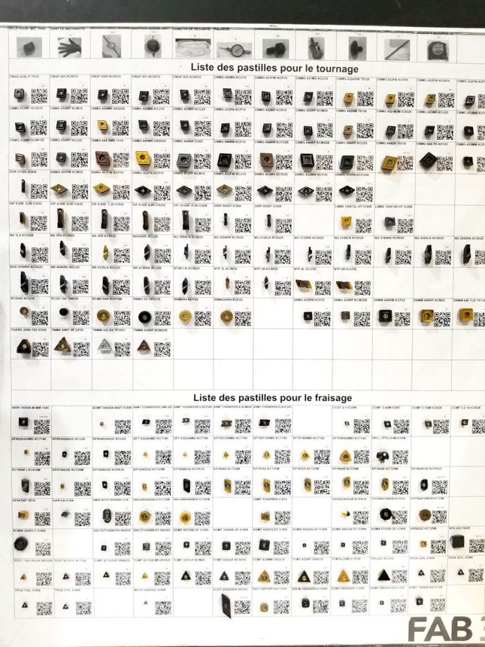

Eschewing a standard catalog, judging that most people would respond better to a visual format, “we opted for the real thing,” says Mr. Bellemare. This meant creating a display panel with a sample of each carbide insert glued onto it.
Next Fab3R needed a way to provide direct access to tool information. After considering a number of options — a push button, an NFC chip, a barcode — the team settled on posting scannable QR codes next to each insert sample. “QR codes are simple to create and to use,” Mr. Bellemare says. “As a bonus, they are free.”
A computer was installed next to the display board, having only one function: to read the QR codes. The app is the only thing allowed to run on the PC. “At any given time, we scan a code and we get the right page. Even those who had never touched a keyboard or a mouse can easily use it in seconds,” says Mr. Bellemare. That’s because the keyboard is not even necessary except for maintenance, since the machinist uses a handheld scanner to acquire the info from the QR code. Goal number one was thus achieved.
This board displays an actual insert of each type used, along with a QR code the machinist can scan to get the cutting data they need on the computer screen to the board’s left.
The next challenge was to get all the essential data displayed on a single page — no scrolling, no flipping. By “essential data,” Mr. Bellemare means only the information needed by Fab3R machinists.
“We don’t machine all the kinds of materials that exist, so we don’t need to show the cutting specs for those materials. It would only confuse the machinist and slow down research,” he says. So the team created their own cutting specs template. “We had an employee do the search for us in manufacturers’ catalogs and condense it in our template. We ended up with a very smart display with color codes and other visual cues.”
Another advantage of creating a template is standardization. Machinists face the same kind of display whether they are looking for specs on a carbide insert from Kennametal, Iscar, Tungaloy, Sandvik Coromant and so on. They don’t have to analyze different graphics, a new spreadsheet or various color code schemes. Goal number two achieved.

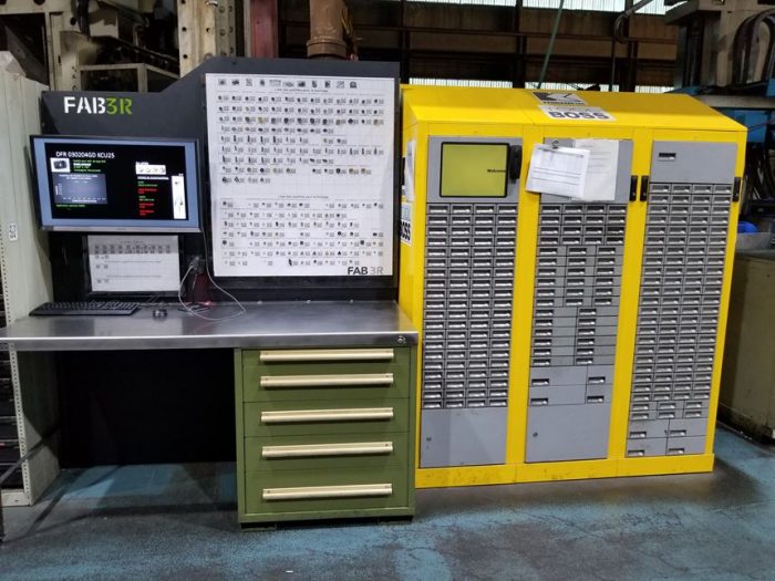

Here is a view of the entire cutting tool data station. The PC monitor, scanner and insert board are all placed right next to the Kennametal ToolBoss vending machine.

      • The station is located right next to the shop’s Kennametal ToolBoss vending machine. “From now on, no machinist should withdraw a carbide insert without knowing exactly how to use it,” Mr. Bellemare says. “Machinists will also have no excuses for choosing the wrong grade or chipbreaker.”
