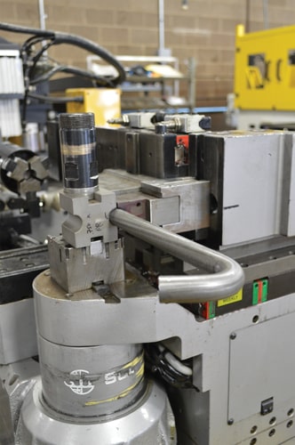

He started by selling off a handful of old bending machines and gutting the mess in the plant. Next, he upgraded two of their four tried-and-true benders, Pines models, built decades ago.
“I had them completely overhauled,” Coffey said. “They got new motors, new actuators, digital controls, and new wiring,” he said, effectively combining the strengths of two eras: well-built, robust machines from decades ago augmented with the latest hardware. These machines handle the bulk of the basic bends, doing much of the day-to-day work, in diameters from ¾ to 3 inches, with much better accuracy and productivity than they achieved before they were updated.
“The bend accuracy is in tenths of a degree,” Coffey said.
Capital Investments. He coupled these initiatives with new equipment purchases. He invested in three rotary draw all-electric tube benders, SOCO models SB-32, SB-52x10A, and SB-63AUTO. With model names that match the maximum diameters they bend—32, 52, and 63 millimeters, corresponding to 1.25, 2, and 2.5 in., respectively—they have the precise bending control associated with servomotor technology. The SB-32 and SB-52 machines do both right- and left-hand rotary draw bending and push bending. The 2-in. model has 10 axes of control, and the 1.25-in. machine has eight, enabling tight-radius compound bends, with or without mandrel.

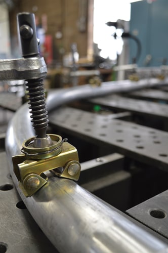

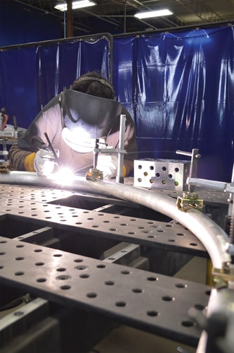

The homemade work table, the sheet of plywood teetering on a couple of saw horses, is long gone. The company welds a lot of assemblies, many of which are mind-bogglingly complex. It uses a BuildPro® modular fixturing system, which is based on a steel work surface, 5⁄8-in.-thick plate nitrided for corrosion and spatter protection. It has a grid of 5⁄8-in.-dia. holes laid out in 2- by 2-in. spacing to accommodate components to build temporary welding fixtures. The welder uses brackets, pins, stops, spacers, and clamps that are secured to the table by ball-lock bolts to build essentially any configuration imaginable.

ATF’s welders used to weld angle and other various leftover lengths of steel to a worktable to create each weld fixture from scratch. It worked, but it was cumbersome and time-consuming. A modular worktable with a variety of blocks, pins, spacers, and clamps has been a tremendous help in simplifying and speeding up the fixturing process.

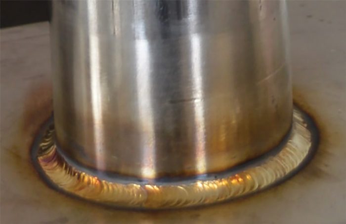

Even a simple butt weld looks great when done well. Because ATF does a little bit of everything, any customer can benefit from the company’s many certifications.
