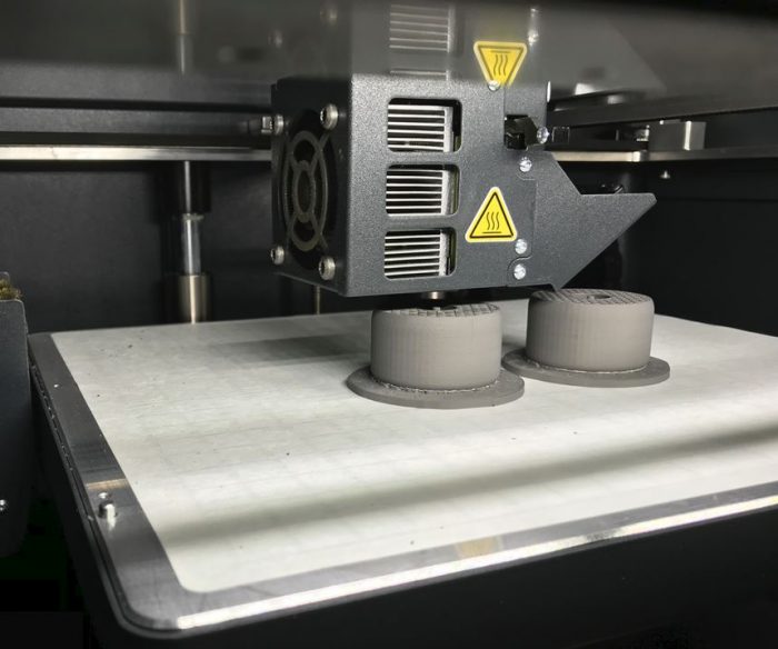

The Metal X is a fused-filament fabrication printer that builds parts by laying down layers of material, until a part builds up. Photo: Paul Hayes

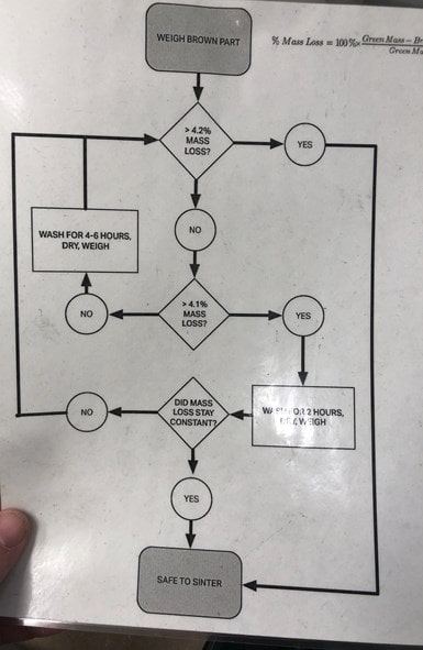

MarkForged provides this flow chart to guide users through the washing/sintering process. A printed part must be weighed before it goes into the wash in order to compare the percentage of mass lost during the washing process. Paul Hayes writes that weight on the bottom of the part for tracking purposes. If more than 4.2% of mass is lost, the part can be sintered. If not, it might need to be washed again.

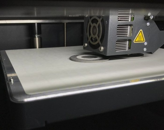

The Metal X is a fused-filament fabrication (FFF) printer that uses spools of  metal powder and binding agent enclosed within a plastic encasement. The second spool is ceramic powder enclosed within a plastic encasement. It works by feeding those spools through a heater block, where it is heated to the encasement’s melting point and fed through an extrusion nozzle. The nozzle first lays down layers of material mixed with ceramic where necessary, which will later act as the part’s release. (The ceramic can also be used to build support structures that once again will be removed at a later point). The nozzle then lays the metal on top of that, building the part layer by layer. The machine uses disposable print sheets that are held down by a vacuum table to improve bed adhesion and ease part handling. Once a part is printed, the paper is easily removed from the vacuum table. Able Tool’s typical batch sizes range from one to four parts. However, Mr. Trovillo says that if a part is small enough, he estimates that he could fit as many as 30 parts on the build plate. “It really depends on the size of the part,” he says. “You can print whatever fits in the build volume.” The shop’s smaller parts print in about two to three hours, while the larger parts can take several days, depending on part mass and complexity.
Before building a part, the printer lays down a support raft, which will act as the part’s release. The print sheet is held by a vacuum to the print table to make part handling easier. Photo: Paul Hayes
Printed parts are weighed on a digital scale before being submerged into the MarkForged Wash-1 heated washing system, where Opeteon SF-79 cleaning fluid circulates around the parts to break down most of the plastic and wax binding agent. After washing, the air-dried part is weighed again to determine if a high enough percentage of the binding agent has been removed. If not, it goes back into the wash to remove more binder. If it has, the part is considered ready to be sintered.

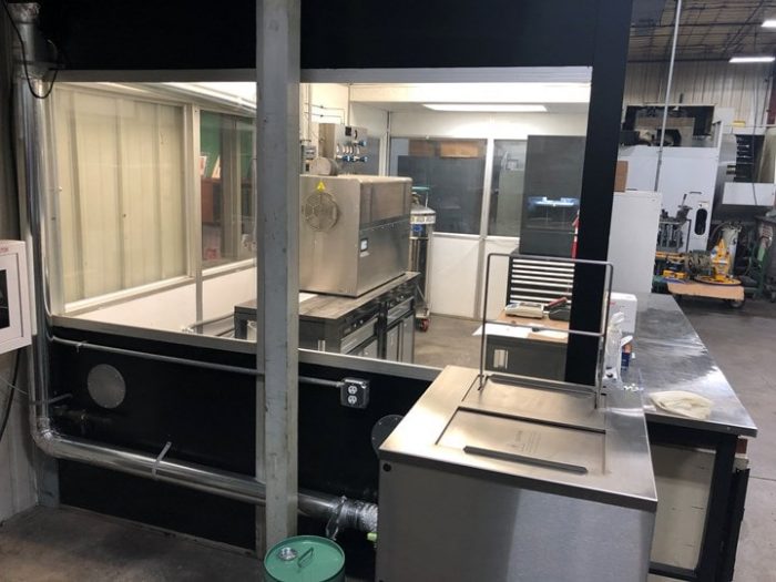

Able Tool keeps its 3D printing system mostly inside this vented room on its shop floor. After printing a part, the part is weighed and taken to the washing system outside the room (foreground). It is then air dried and walked back into the enclosure to be reweighed. From there, it goes into the sintering machine, located almost in the middle of the room, to fuse the metal. A large argon tank for the sintering machine is located in the corner to the left of the Metal X.

3. Find the right spot. Don’t let the small footprint of a 3D printer fool you. Just as much forethought should go into the machine’s placement as you would give a VMC or HMC. Consider electrical and ventilation requirements. Consider possible workflow of parts from your printer to secondary operations on your shop floor. Able converted a small CMM room into the company’s metal 3D printing area. “Unfortunately, we didn’t consider the fact that you need 12 inches of space surrounding the sinter,” Mr. Trovillo says. That meant the wash station wouldn’t fit into that room. “The outcome of this is that we have to exit the 3D printing room to access the wash station, which had to be positioned just outside. Once washed, the parts must be walked back into the room for sintering.” While this isn’t a make-or-break issue, a little forethought would’ve saved a minor workflow annoyance.
