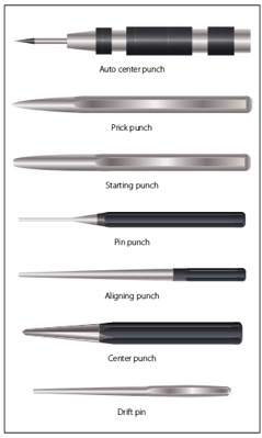

Depending on your needs, there are different types of punch tools. The diagram below showcases some of them. When trying to fully differentiate them from each other, it can be a bit confusing. Due to their similarities in application use, they are used interchangeably.
Image Credit: apexinds.com
Typically classified by the shape of their points, here is a bit more information about how those different points affect their performance. This will help you achieve the desired outcome.
Center punches and auto center punches are the most frequently used in machine shops. They are great for making large indentations in metal. This is necessary during pre-drilling operations and would assist in engaging a twist drill. Why can’t you just start with the drill, you might wonder? Bypassing the punch step often leads to the drill veering off center and damaging the workpiece.

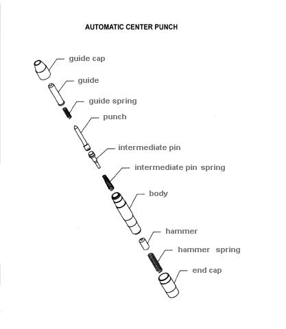

The only difference between these two types of center punches is that the auto center punch does not require a hammer. There is a mechanism that automatically forces the punch into the metal.
Check out this diagram to see how the automatic center punch works.
Image Credit: Wikipedia.com
Prick punches are ideal for creating reference marks on your workpiece. Why do you need reference marks? This is very helpful when transferring dimensional information from paper to metal. Just place the paper directly on the metal and punch! Prick punches are similar to center punches and are also used as a predrilling tool. However, a prick punch can create a deeper hole than a center punch. The indentation is then enlarged with a center punch.
Drive punches are often used with materials other than metal, however, they are extremely handy if you need to remove any damaged rivets, bolts or pins that are wedged in holes. The drive punch is not featured in the diagram, but the anatomy is similar to those listed. The only difference is that it has a flat face rather than a point.
Drift pins are typically used directly after the drive punch. When the drive punch has unwedged an object (like a damaged bolt) sufficiently, the drift pin is then used to finish the job and pluck out the object from the hole.
Starting punches and pin punches are often times used together as the starter punch loosens a stuck pin and the pin punch is used to finish the job. You will see that this is similar to the drive punch and draft pin system.
Aligning punches are similar to the drift pins in that they work with pins, rivets, and bolts. However, the aligning punch is ironically not designed to be hammered and its purpose is to align two or more holes so that an insertion can be placed properly for accurate fastening.
Transfer punches (not noted in the image above) are punches that are not tapered. The transfer punch is designed to be able to fit into an existing hole and then accurately transfer the size of that hole to another surface.
