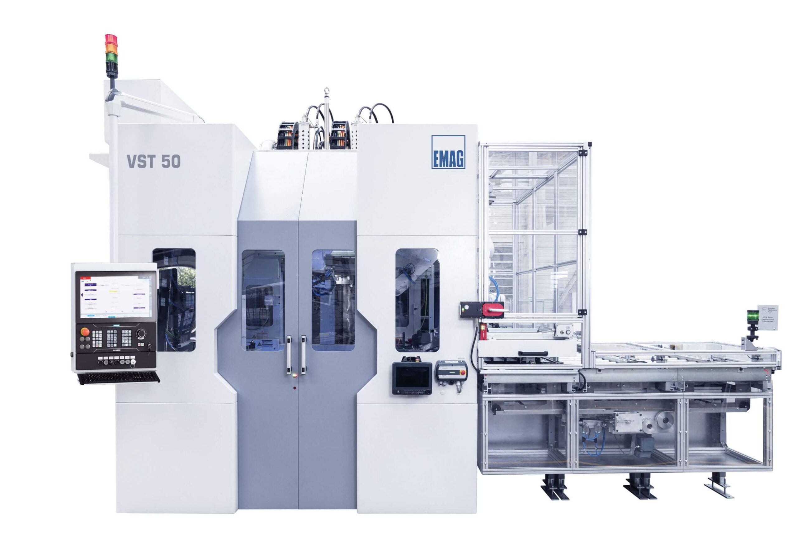

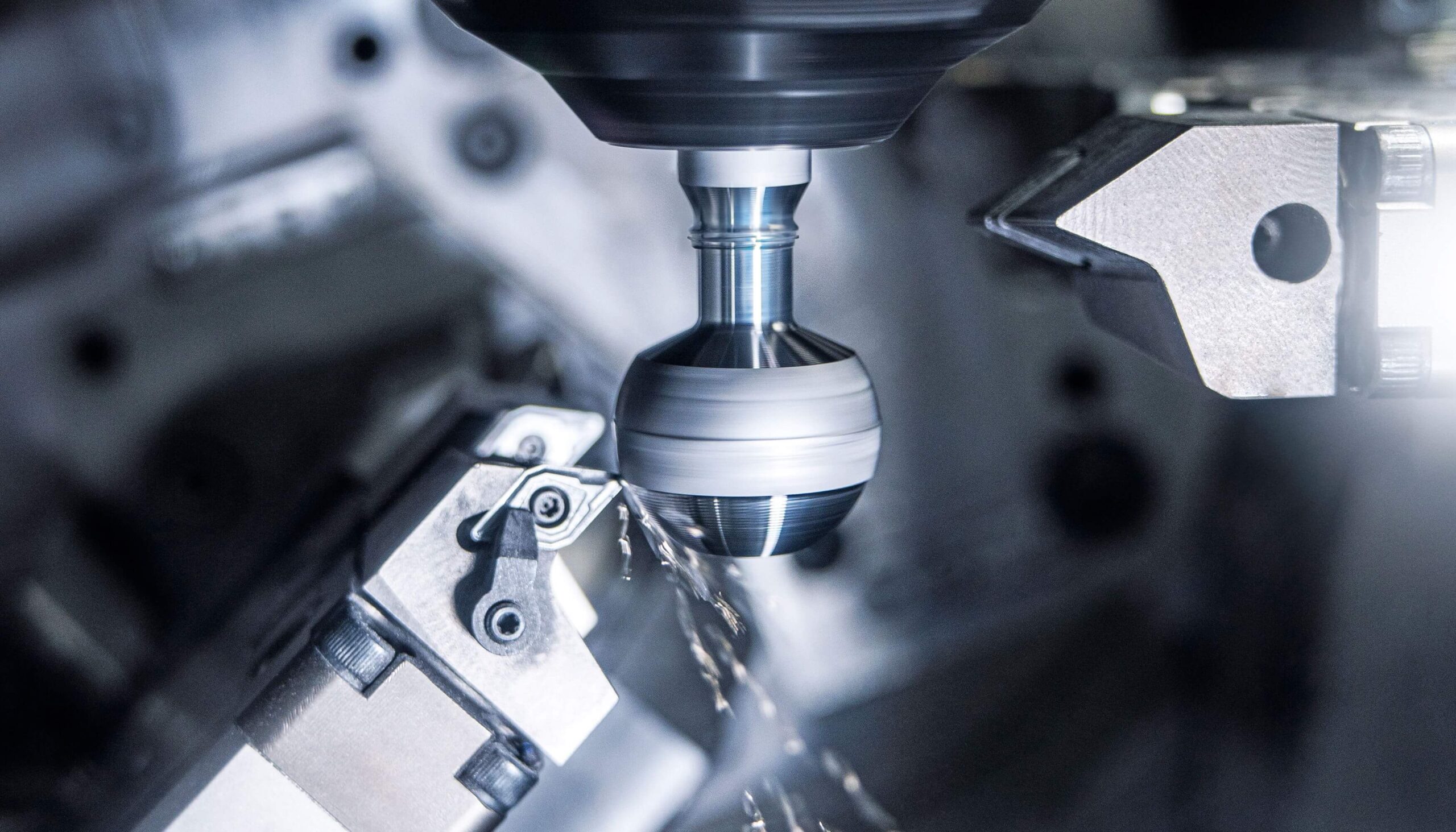

a simple look at this machine makes it clear: the designers have done a particularly good job here. On the one hand, the VST 50 has highly automated processes, including the use of three robots. On the other hand, it is easy to operate using the EDNA apps, which also include various measurements and the robots. For the actual turning of the ball and neck of the ball pin (only these areas are involved here), there are two suspended workpiece spindles that can be moved irrespective of each other. As a result, one spindle is always loaded and unloaded while the other is in use during the machining process. The associated tool compound slides are split in two: the tools on the left-hand side are mounted on a rotary B-axis, which enables the ball to be turned and smoothed with precision. In addition, the ball diameter and shape can be adjusted using a linear U-axis. Special tools for neck machining are mounted on the right-hand side.
High-productivity loading
Loading and unloading are in turn carried out by the three robots, which are arranged in parallel in front of the machine. Each is responsible for a different sub-process: The left-hand robot handles the workpiece between the transfer station and the first workpiece spindle. The middle robot performs the same task on the second workpiece spindle, while the right robot handles the workpiece between the transfer station and the outer automation assemblies. But why not use a robot that performs these three tasks alternately at this point? “That would certainly be possible,” confirms Haas. “However, we wouldn’t be able to achieve the extremely short cycle times. The various movements are sometimes carried out simultaneously. Our solution ensures that a finished workpiece leaves the machine every seven seconds and the chip-to-chip time is less than two seconds.”

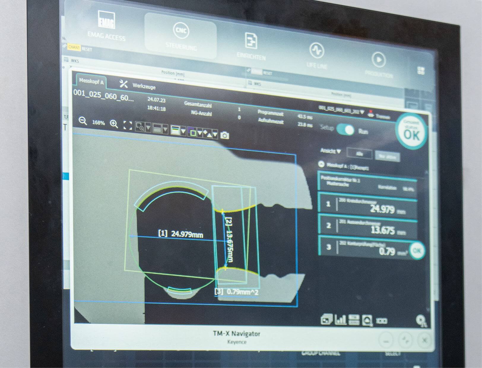

Finally, there is the issue of process reliability as a key economic factor for a component that must leave production without any error tolerance. Here, EMAG relies on a 100 percent solution: each component passes through a light-band micrometer, which determines the required measured values in fractions of a second, whereby the result is very comprehensive. The final ball and neck diameter is determined and any chips are detected at the same time. In addition, a high-resolution process camera is located directly in front of the loading hatches. Its live image appears on the panel at the touch of a button. The operator can easily check whether, for example, the chip formation is causing a fault in the process.
