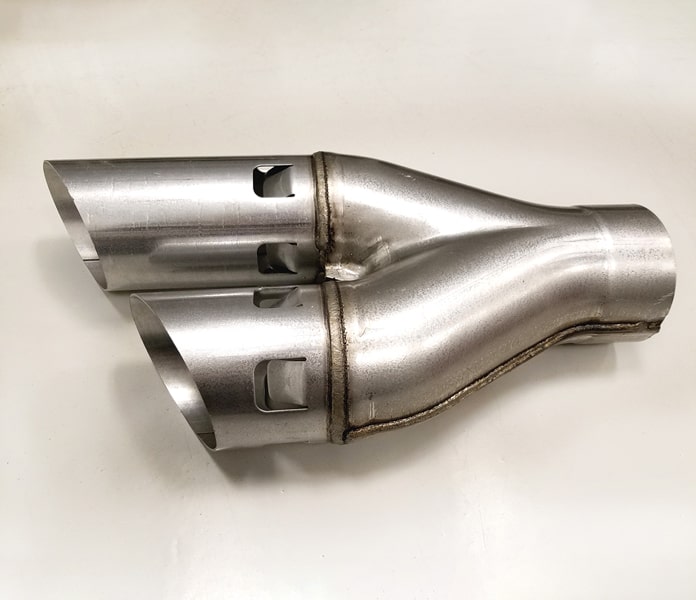

That chromium oxide layer may provide the stainless quality, but it’s also what gives welders so much grief. This helpful barrier increases the surface tension of the metal, slowing the formation of a fluid weld puddle. A common mistake is to increase the heat input since more heat increases puddle fluidity. However, this can affect stainless adversely. Too much heat will cause further oxidation and can warp or burn through the base metal. Add in the thin sheets used in high-production industries such as automotive exhaust manufacturing and that becomes a top-level challenge.
Heat can damage the corrosion-resistant properties of stainless steel in a beautiful way. When the weld or surrounding heat-affected zone (HAZ) forms a rainbow of colors, it’s a clue too much heat is being used. Oxidized stainless produces amazing colors from pale gold to deep blues and purples. The colors make for beautiful artwork, but can indicate a weld that may not pass certain welding codes. The strictest of codes prefer little to no coloring in the weld.

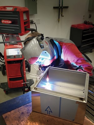

It is a widely held assumption that gas tungsten arc welding (GTAW) is best suited for stainless steels. Historically, this has been true in a general sense. It remains true when trying to bring out those bold colors for an artistic weave, and for meeting the highest quality standards of industries like nuclear and aerospace. However, modern welding inverter technology has allowed gas metal arc welding (GMAW) to become a production standard for stainless steels, and not just for automated or robotic systems.
Since GMAW is a semiautomated wire-feed process, it offers a fast deposition rate, which helps reduce heat input. Some professionals say it’s easier to use than GTAW because it relies less on the skill of the welder and more on the technology of the welding power source. That’s debatable, but most modern GMAW power sources use preprogrammed synergic lines. These programs are specifically developed to adjust parameters such as amperage and voltage based on user input of filler metal, material thickness, gas type, and wire diameter.
Some inverters can regulate the arc throughout the weld to consistently provide a precision arc, handle part gaps, and maintain high travel speeds to meet production and quality standards. This is especially true with automated or robotic welding, but also applies to manual welding. Some power sources on the market offer touchscreen interfaces and on-torch controls for simple adjustments.
