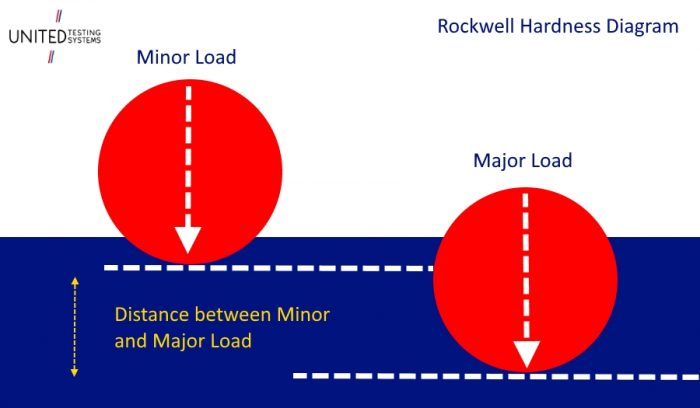

The hardness test is done through a series of pressure tests.  An indenting tool, typically a diamond or ball indenter, presses against the material’s surface.  After a specific hold time, the load is removed, and the indent is measured. This is repeated with a heavier load, called the major load, and then repeated for a third time once again with the preliminary load. The difference between the initial and final indentation is measured, then converted to a hardness number, and that is how the hardness of the material is calculated.
The applied forces usually range between 15 kgf and 3,000 kgf but varies depending on the test and the type of material.

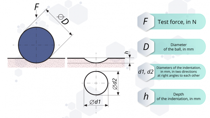

Here are a couple of visuals that should help you understand the concept.
Image Credit: https://www.unitedtesting.com/en-us/rockwell-hardness-testing
Image Credit: https://matmatch.com/learn/process/hardness-comparison

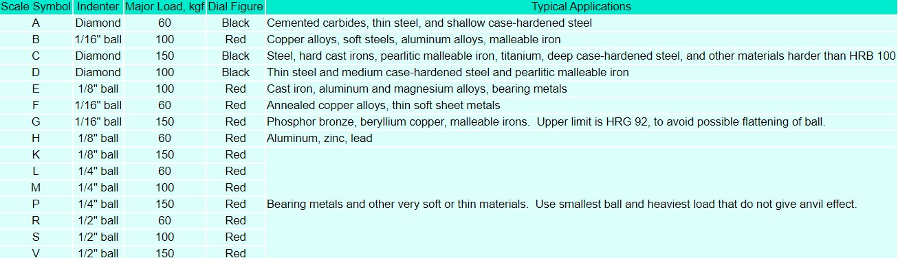

Factors like material type and thickness will require different scales. There are over 30 different Rockwell scales with their own distinguished test forces and indicator types. Make sure to select the scale right for your application needs.
Rockwell Hardness Scales (Testers)
The most common Rockwell hardness scales are B and C, however, there is a multitude of alternative scales. Check out this graph to get a better idea of which Rockwell hardness scale will meet your needs.
Image Credit: https://classes.mst.edu/civeng120/lessons/hardness/equipment/rockwell/index.html

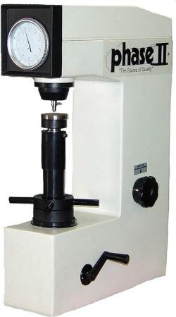

Phase Ii Plus, Analog Rockwell Hardness Tester
Order Now
Also conforming to the ASTM E18 hardness standards, this scale is perfect for any environment, including heat treatment facilities, toolrooms, workshops, etc. With a direct analog reading, this scale has an advanced design and is easy to operate.

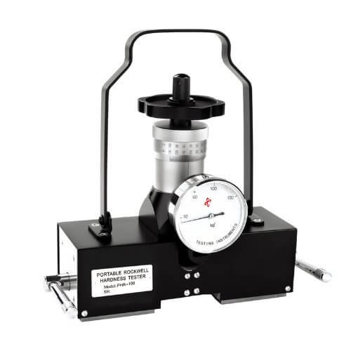

PHR-100 Portable Magnetic-type Rockwell Hardness Tester
PHR-100 Portable Magnetic Rockwell Hardness Tester
Order Now
With high accuracy and complying with ISO6508 and ASTM E18, this scale has good repeatability and features a similar reading system to a micrometer, making it easy to read. Test the hardness of steel plates, pipes, axes, molds, huge forgings, and huge and medium-size heat treatment parts.

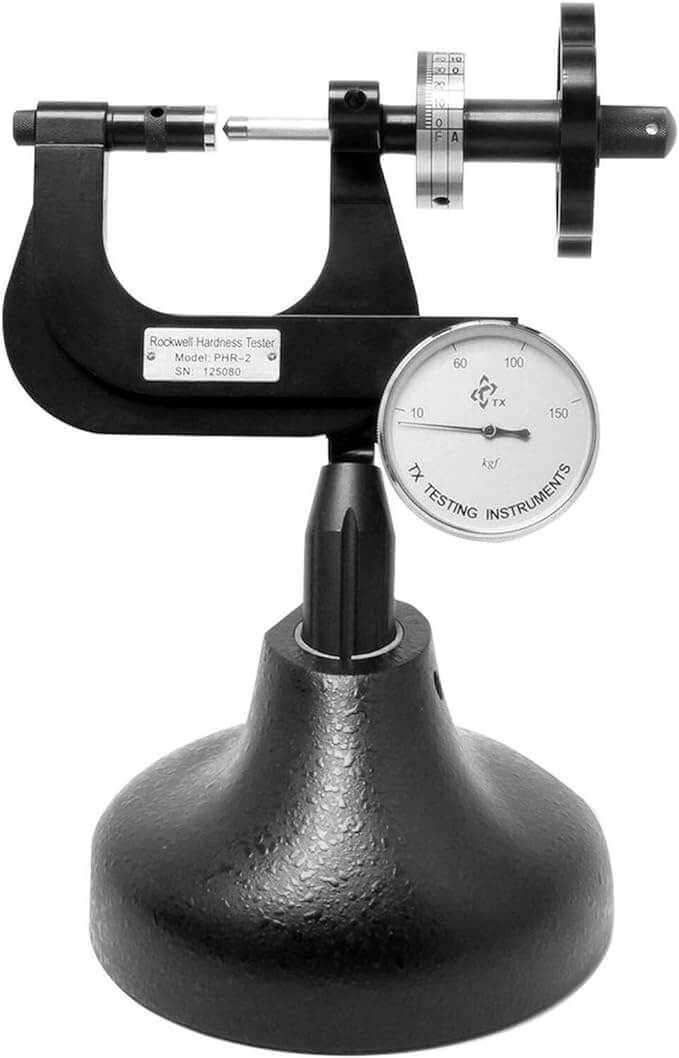

YJYGR PHR-2 Common Metal Workpiece Small Parts Portable Rockwell Hardness Tester Meter
Order Now
This tester is compact, light and weighs only 1.2 kg. It is as accurate as desk testers and complies with the basic designing principles of Rockwell hardness testing. It is used to test thin and small parts, such as thin plates, thin tubes, thin axles, small balls, small stamping parts, and small supporting surfaces.

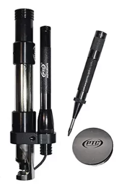

PTC 316 Steel Hardness Tester: Portable C Scale
Order Now
Not technically a Rockwell tester, but this tester measures the hardness of metals in the range of 20 to 65 HRC on the equivalent Rockwell C Scale.  It is exceptionally useful where the test piece is too large or heavy to test on a bench-type tester. This high quality, affordable, portable tester is a must for large workpieces, small machine shops, heat treaters, quality control personnel, and engineers.

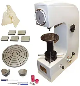

Bench Top Rockwell Hardness Tester HR 150 A Testing Table
Bench Top Rockwell Hardness Tester HR 150 A Testing Table Test Block HRC HRA B
Order Now
This Rockwell tester can handle loads of  60kg, 100kg, 150kg with a max test height: 6.7″ and depth of 5.3.” A storage case with accessories is included and the weight of the unit is approximately 150 lbs.
