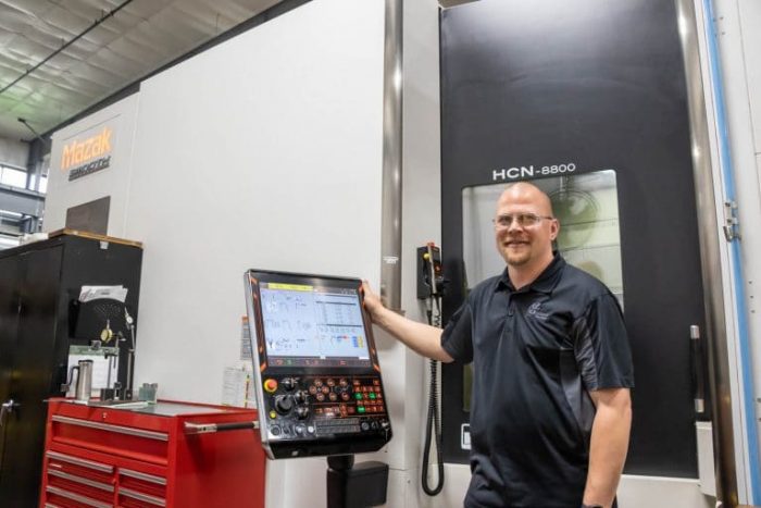

Marc Manteufel, lead manufacturing engineer, said A to Z Machine selects its machining centers like this Mazak HCN 8800 for dependability and speed in rapid traverse and tool change. (All images provided by Mazak)
When it comes to the machine tool aspect of its business strategy, A to Z Machine acquires the right machines for the job, particularly those that allow it to do multiple operations in single setups. This boosts efficiency and part quality. Another machine tool strategy is that the shop opts for larger size equipment that reduces the amount of competition it faces in the market.
“We look for machines that are dependable. We also look for speed, how fast it rapids, how fast it changes tools, and so on,” explained Marc Manteufel, A to Z Machine‘s lead manufacturing engineer. “In a production setting, a second faster here and there adds up to savings of minutes and hours for us. Our machines must also be accurate and repeatable, heavy-duty and with high horsepower. This allows us to take full advantage of the new cutting tool technologies, which require rigid and robust machine tools to push such tooling to its limits. We can then take deeper cuts and run at faster feed rates,” Manteufel said.

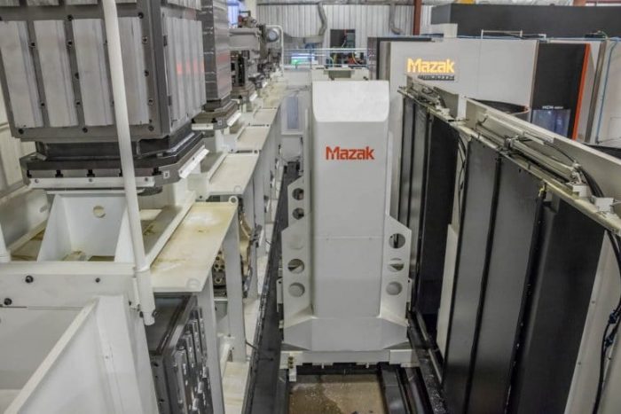

A to Z Machine has paired a Mazak 28-pallet Palletech System with the shop’s HCN-6800s to run a growing number of parts on the two-level, two setup station automation system.
Paired with the HCN-6800s, the shop’s 28-pallet Palletech System features two levels and two setup stations. A to Z’s job forecast for this cell is growing and many of the system’s pallets are set up for multiple part numbers. About a dozen different part numbers are run during the course of one shift.
“With one HCN-6800 and Palletech, we produce the same output as two standalone machines,” explained Manteufel. “But most significantly, we also run unattended on second shift and have basically eliminated the setup time for all the 18 (and growing) different parts currently running in that cell.”

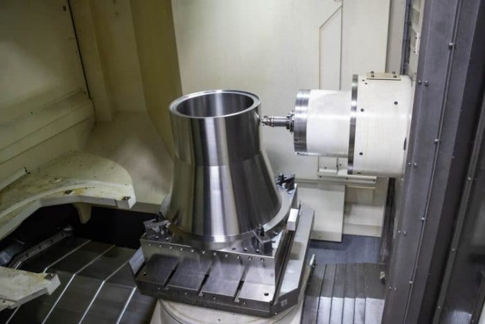

A to Z Machine does some work for extremely high-tech customers. At any given time it can have upwards of 1,500 active open jobs circulating around the shop floor. Workpieces at A to Z range in size from small to very large, such as 20,000-lb (9,071-kg) cast and billet parts made from gray and ductile iron, steel, aluminum, brass, stainless steels, and high-temp alloys. Job lot sizes range from one to 500 parts.
A part used in the mining industry and made from duplex stainless steel is loaded for machining. Workpieces at A to Z Machine typically range in size from small to very large, 20,000-lb (9,071-kg) cast and billet parts.
