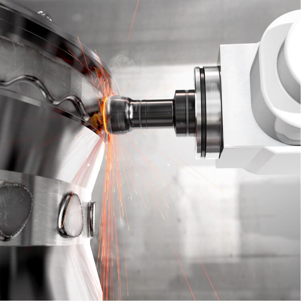

Aerospace OEMs are increasingly turning to materials like HRSAs to manufacture aircraft parts that face extreme performance demands due to their high strength at elevated temperatures.
However, HRSA components are needed to make this work. Such materials are metallurgically composed to have high strength at temperatures of up to 1,000 degrees Celsius. But this also means that the stresses generated when machining these materials are high. The unique capability of these nickel-, iron- and cobalt-based super alloys to perform close to the melting point of their basic metal gives them generally poor machinability.
However, tool providers are offering tooling solutions to help. Sandvik Coromant offers a number of tooling solutions to support cost-effective, high-quality machining of HRSA aero engine components. One such method is high-feed side milling. This technique involves a small radial engagement with the workpiece, which allows increased cutting speeds and feed rates and axial cutting depths with decreased heat, chip thickness and radial forces.
To support this method, Sandvik Coromant developed the CoroMill® Plura high-feed side milling (HFS) range. The range features a series of end mills with unique geometries and grades and is made up of two optimized versions, one for HRSA materials and one for titanium. Chip evacuation and heat are specific challenges when machining titanium, so the first version presents a solid version of the tool for normal chip evacuation conditions. The second version features internal coolant and a new cooling booster for optimum swarf and temperature control.
A customer trial was performed to test a 12 mm diameter CoroMill Plura HFS end mill against a same-sized competing tool. This trial involved machining a low-pressure turbine (LPT) case made from aged Waspaloy 420 nickel-based alloy using a horizontal machining center with an increased axial depth-of-cut and reduced radial depth-of-cut. The outcome was that metal removal rates were increased substantially with CoroMill Plura, leading to an impressive 198 percent productivity increase for the customer. The solution has also been applied to blisks, as well as turbine disks and casings, machining blades and weight-reduction scallops.

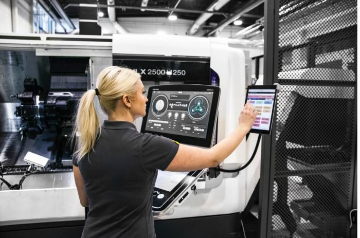

Digital tools, and the data they generate, can give levels of insight that traditional machining lacks. This is particularly key in heavily regulated industries such as aerospace, where accuracy and efficiency are crucial at every stage. To support aerospace OEMs, Sandvik Coromant offers several solutions to improve machining processes and to ensure the quality and reliability of components. These solutions include the CoroPlus® Tool Library, which allows users to build and manage their tool inventory and features data on over 900,000 items from several cutting tool manufacturers. The cloud-based library allows aerospace component manufacturers and CAM programmers to easily create tool assemblies adapted for specific machining tasks or receive specialized recommendations for each application, saving valuable time by removing the need to manually find and input tool data and reduce the margin for error involved in sourcing data from different systems.
Digital tools and the data they generate can give levels of insight that traditional machining lacks, which is key in heavily regulated industries such as aerospace, where accuracy and efficiency are crucial at every stage.
Sandvik Coromant also offers CoroPlus Connected with Silent Tools Plus, enabling data-driven process automation to optimize output quality. CoroPlus Connected is particularly effective in complex processes such as production of jet engine components and landing gear, where visualization is difficult and operators may struggle to accurately see inside components due to their complicated structures or challenging materials. Silent Tools Plus adaptors are equipped with sensors that can measure important parameters such as height, temperature and load and transmit this data automatically to the machine, minimizing tooling setup and improving operator control when the tool is in cut.
Finally, Sandvik Coromant’s CoroPlus Machining Insights offers operators a centralized oversight of machine data, allowing them to visualize the process from start to finish. Real-time and historical reports let engineers see machine and tool use, errors and performance, giving insights into areas for improvement and process optimization. This can improve overall productivity and highlight risk areas in manufacturing.
