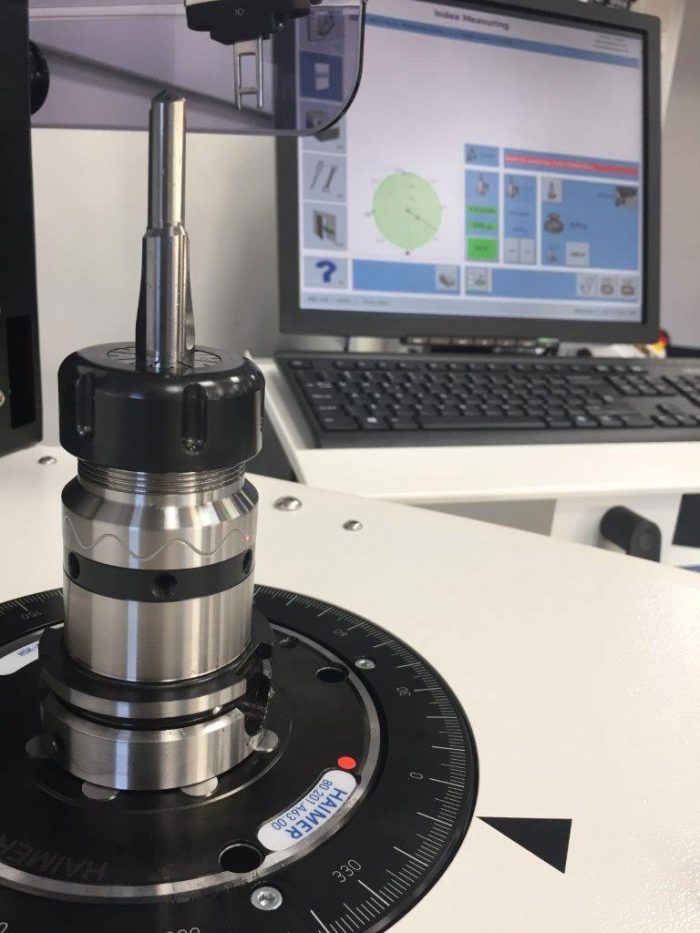

Precision Tool installed this Haimer Tool Dynamic TD 2009 Comfort Plus balancing machine, which has improved part surface finish and allowed it to take on high-precision jobs that other machine shops cannot handle.

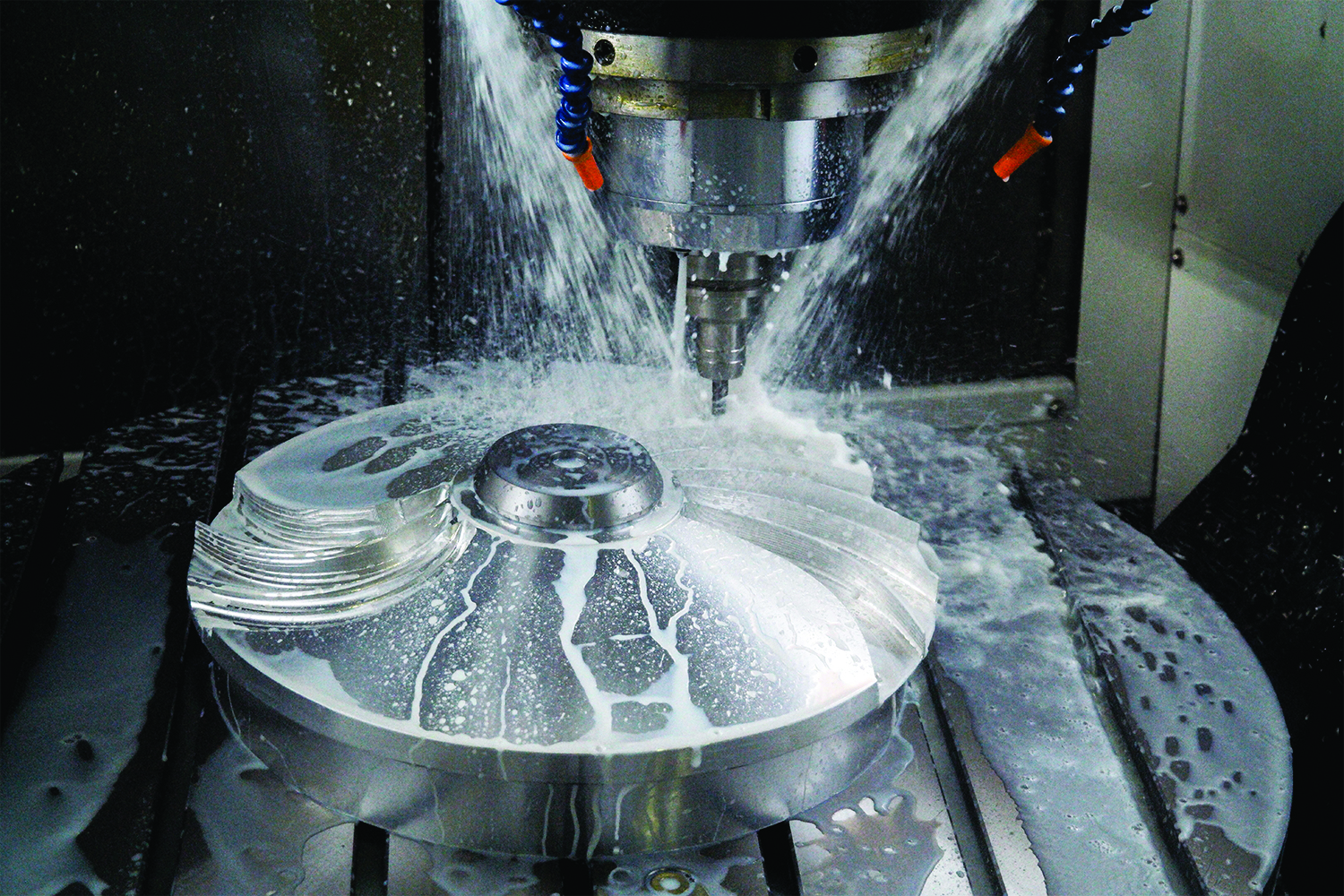

Balanced tool assemblies like these allow Precision Tool to master harmonics when machining, which improves part surface finish.

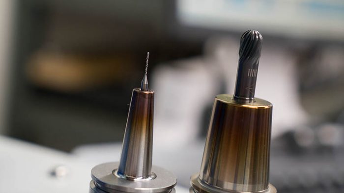

Quality Tooling and Equipment: For Precision Tool, this meant Haimer HSK tooling and shrink-fit systems (no collets, side locks or Weldon flats). Shrink fit provides repeatability and helps reduce tool stick out. Precision Tool worked with Andrew Skoog, the local Haimer manufacturer’s representative, to put together the right package.
Balanced Assemblies: To say that Precision Tool is a fan of balancing is an understatement. According to Technical Advisor Gary Goerges, “Haimer raised our awareness of how good things can be if you balance tool assemblies. In our situation, surface finishes on our equipment are now pretty spectacular. With the Haimer Tool Dynamic TD 2009 Comfort Plus balancing machine, we can get very particular on how close we want to balance something.”

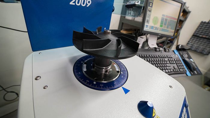

The Haimer Tool Dynamic TD 2009 Comfort Plus balancing machine offers optimized touchscreen usage, integrated PC, and storage for balancing accessories, among other features.
The Haimer balancer made all the difference. Precision Tool manufactured the part and sent it back to its customer, which was impressed with the outstanding accuracy and finish. “Nobody could make the part to the finished specs that they wanted,” remarked Jim Goerges. “We did it and a big part of that was how exact we were able to get in terms of balancing special machine tooling to achieve the surface finish on the internal features. In fact, we would not have been able to perfect the harmonics without the Haimer balancer.”

Precision Tool could make the part work. While its version of the attachment carried a premium price the customer saw the value that the superior part would bring to the overall quality of its seeding machine. This was all due to Precision Tool’s ability to utilize the Haimer balancing machine on not just toolholder assemblies, but on physical parts as well. The TD 2009 machine was able to identify unbalance and accurately designate the exact position where weight correction was needed.
