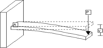

The length to diameter “L/D” ratio
 Vibration occurs when machining long, small-diameter components or during internal machining using boring bars with a long projection length. This is particularly the case if L/D > 4, where L= length of the workpiece and D= diameter of the workpiece
The deflection of a cantilever beam (for example a tool clamped on one end and free on the other end, being forced to bend thru cutting forces), is proportional to the cube of the free-hanging length. Thus the longer the length of the tool, that much higher the deflection, leading to proportionally higher amplitude of vibrations

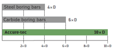

Boring bar materials
Typically, up to L/D= 4, a standard steel boring bar works just fine. Up to L/D=6, a carbide boring bar gives good performance. Beyond L/D > 6, an anti-vibration boring bar, such as Accureˑtec boring bar, is required for vibration-free operation.

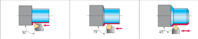

Approach (lead) angle
Similar to insert clearance and included angle, a feature that is the best for rough turning/boring, in general, leads to a negative outcome on the vibration characteristics of the boring operation. An approach angle of 90O ensures majority of the cutting forces go into the spindle axially, thus the radial forces are nearly zero. This reduces the tendency of a long, thin workpiece to vibrate. The more the radial forces, the more the tendency to radially deflect, the more the tendency to put the forces into the chuck, the more the tendency of the workpiece to correct itself radially, the more the tendency to vibrate. For this reason, a 75O lead angle would be worse than a 90O lead angle, and a 45O would be the worst because of the forces and vibrations induced into the boring operation. This is also why there are a lot more external turning holders with 45O lead angle for roughing, compared to internal boring tools.

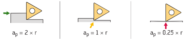

Depth of cut
Not only does the corner radius play a role in reducing or increasing the vibrations in a machining operation, but the correlation of depth of cut to the corner radius also plays a big role in the dynamic. Ideally the depth of cut should be at least 2 times the corner radius, thus ensuring a substantial amount of cutting forces go into the spindle axially rather than into the workpieces radially. This is somewhat counter intuitive, as many machinists are intuitively tempted to reduce the depth of cut to eliminate the cutting forces. However, as shown in the pictures below, the smaller the depth of cut (for the same corner radius), the more pronounced the radial forces. Thus, for a shallow depth of cut [picture showing depth of cut (ap)= 0.25x corner radius (r)], a substantial amount of forces are in radial direction, and the tendency of vibrations is much higher.
It is also important to note that typically higher depth of cut “stabilizes” the cut when using a steel or carbide boring bar because of the reasons stated above. However, for the pre-tuned anti-vibration boring bars, this strategy does not always pay off. So, when using anti-vibration boring bars, it is important to follow the specific cutting tool manufacturers’ recommendations for the depth of cut.
