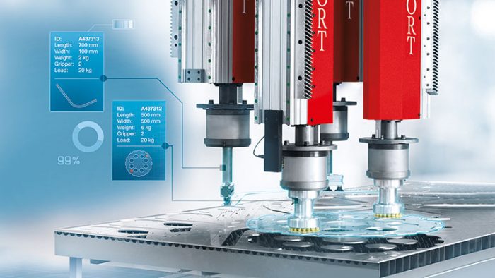

The ASTES4 premium sorting solution has four pick-up arms, so it can remove four parts at once after they are laser cut.

Recognizing the continued importance of automation, Mitsubishi Electric Corp. (the parent company of MC Machinery) purchased the Swiss automation specialists ASTES4 in 2018. “They specialize in part removal [and sorting] from sheet automation, something that will be demonstrated this year by us,” said Hahn. “The challenge our customers are seeing, even with automation, is sorting the parts. When you buy a high-speed machine, even with high-speed material handling, somebody still has to physically go through and sort out and de-nest the parts.”
That starts to create a bottleneck, which the latest MC Machinery automation system developed by ASTES4 is designed to alleviate. It is a pick-and-sort system with four pick-up arms, so it can remove four parts at once. “And while that system is picking up four parts at a time, we can still be cutting on the machine and going to conveyors with sheets,” he said. Sending those parts that need sorting and de-nesting down conveyors creates multiple de-nesting points throughout the system.

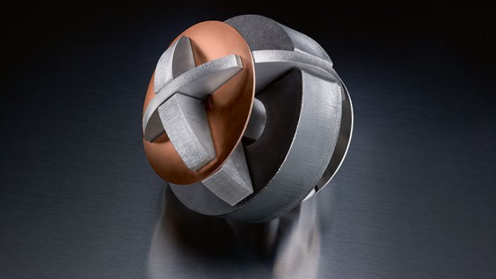

All components of this part were produced on Trumpf’s solid-state laser. The entire part was cut with a single cutting head.
“What people are looking for is not necessarily higher power, but faster and less expensive parts,” said Brett Thompson, sales engineer-TruLaser for Trumpf Inc., Farmington, Conn. “The power question is just a byproduct of that.” He also noted that powers up to 6 kW continue to be big sellers.
Trumpf produces multiple solid-state laser formats, including fiber, rod, and disk. For 2D flat cutting, Trumpf uses the disk format for its robustness and stability. “The disk laser is unique in being able to maintain a consistency within one percent of its original laser power over the life of the laser; you buy a 10 kW TruDisk laser today, it’s still a 10 kW TruDisk laser five years from now,” said Thompson. “This is the major advantage of the disk architecture. There’s not the continual loss of power that can frustrate the cutting process.”

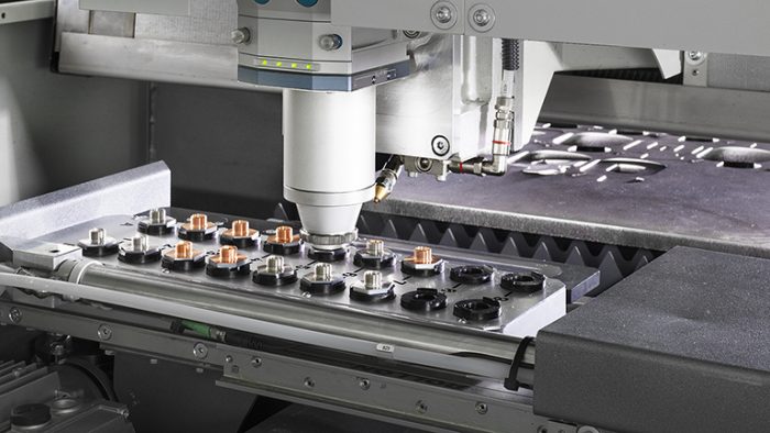

BLM Group’s LS5 laser sheet cutter Active Nozzle Changing feature helps improve cutting performance.

Cotton also agreed that all the peripherals such as gas and beam delivery, nozzles, and automation contribute to faster and less expensive cutting as well as better quality cuts. As an example, the BLM Group’s LS5 Flat Sheet Laser and LC5 Combo machines are currently available in wattages up to 8 kW. The solid-state fiber laser makes it appropriate for cutting reflective materials (copper, brass, aluminum and stainless) as well as mild and galvanized steels.
With the development of new cutting nozzles for the reduction of gas flow and improved edge quality, it is imperative users monitor nozzle quality. In 2018, BLM introduced an automatic nozzle monitoring and changing function to its LS5 product line. This feature automatically monitors, via a camera, the wear of the cutting nozzle and swaps it out from a choice of 18 available nozzles based upon the conditions set within the controller. This feature is critical to maintaining consistent edge quality and the ability to run unattended (lights out) operations.
