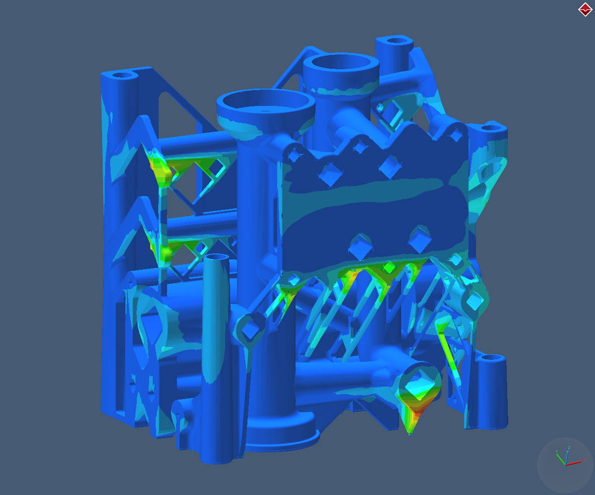

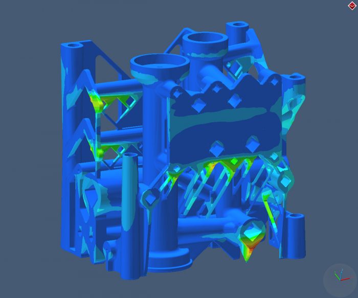

Take, for example, the setting of parameters on a high-capacity metal-AM machine. There can be as many as 200 of these input parameters, all affecting part outcomes. Simple positioning of the part and the location of support structures could make a huge difference in getting it right and (more often than not) getting it wrong. Incorrect positioning can result in an energy-consumption increase of as much as 160 percent. Today’s reality is that perfecting the AM production of a bracket may take as long as two years.
And, getting it wrong is expensive. Consider that at current speeds, AM production of metal parts can take one to two days, so the cost of getting it wrong in terms of machinery, material and power is significant.

Much attention has focused on topology and shape optimization, with much expectation that strangely shaped yet structurally sound parts can be generated on a computer. What companies have come to learn is that just going from CAD to STL to machine is by no means sufficient. Manufacturers are realizing that, prior to tying up an expensive machine and delaying time to market, it is vital to first run a simulation of that process.
Successful simulation requires software tools that:
  • Help the user position parts most appropriately for the machine parameters
  • Create only the support structures substantially needed to minimize distortion and prevent build job abortion.
  • Provide analysis results quickly enough to guide the user’s decision making.
  • Enable ease of use in the proper setup of manufacturing parameters, which are key to achieving repeatability
  • Predict microstructures in the part
  • Include simulation of the hot-isostatic-pressure (HIP) process to reduce residuals stresses in the part, ensure that there is no porosity, and simulate the cutting process, which while removing the support structure may also remove needed stiffness.
