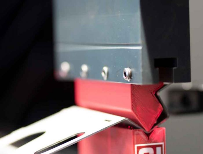

“Insert” is the key word. As Watson explained, fabricators with 3D printers might choose to print the entire punch or die, but this takes time. At FABTECH he showed a die that took a printer seven hours to print next to a punch that took six hours.
For a truly flexible bending environment using printed tools, Watson suggested that shops start with standard tool bases. Then, when a custom job arrives, the shop can design the exact punch tip and die geometry required. This shortens the printing time and, if the base is made of steel or another strong material, increases the tool’s overall strength.

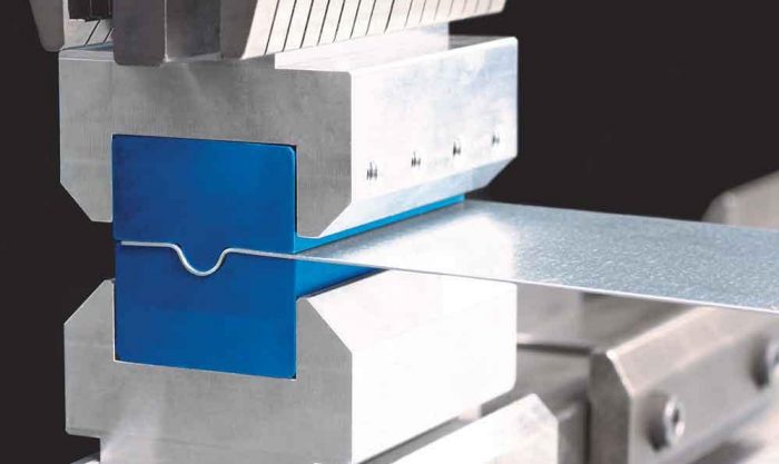

3D-printed inserts also can work as adapters. Say an operator needs to bend cosmetically critical material; a printed insert can slip over an existing V die and serve as an alternative to a urethane drape. The insert also can serve to narrow the die opening to achieve a specific air-bent radius. In fact, one common long V die could hold two different inserts that provide two different V openings side by side.

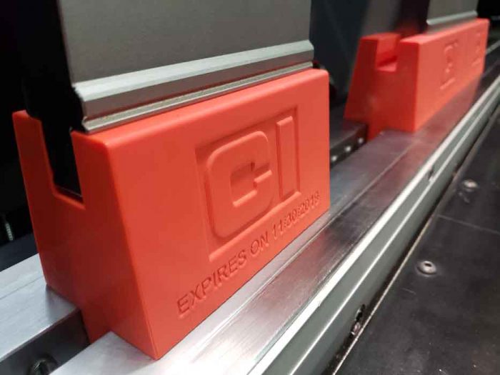

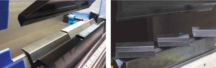

Risers also present opportunities for 3D printing. At FABTECH Cincinnati showed how printed die risers could lift the bending plane enough to give sufficient room for negative flanges to clear a laser-based angle measurement device positioned just below the tools. These risers also happened to have expiration dates printed onto them.
“Say the operator uses these risers, then removes them and puts them near a window to the outside,” Watson said. “The UV light [coming through the window] could make the printed material in these risers brittle. So I put an expiration date on them for one month. But again, it’s only $20.”
Printed custom risers could also help create common-shut-height tool sets for a staged setup. “Let’s say you have an offset die next to a V die,” Watson said, “but the right-hand station will crash unless it has a riser.” Problem is, to create a common shut height would require the riser to be 1.19 in. “Where do you find a riser that’s 1.19 in.?” Here, using 3D printing can make a world of sense.
Brown added that printed risers or die holders wouldn’t have the same precision as tool-steel holders made to machining-level tolerances. But 3D printing tolerances might be close enough, perhaps with a 0.002-in. difference between stations. “And remember, we’re not in a high-tonnage environment,” he said.
“For low-tonnage applications, these would work just fine as a die holder. You’d design the strongest tool to bottom out with no material, but if it’s only 0.002 in., you’re not going to be able to see it. And the application’s not going to care,” Brown said.
