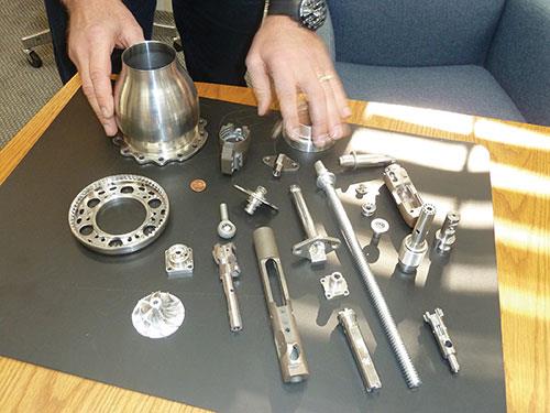

The best thing about keeping a file of bids you couldn’t quote in the past due to part complexity and the limits of your shop’s capabilities is that, once you do invest in the right equipment, you can revisit that record and hopefully win the bid the second time around. That’s what Sussex Wire has been doing since purchasing a CNC Swiss-type lathe for micromachining production parts as well as making small-batch prototype runs.
Having used standard turning machines for years, the company is now reaping the benefits delivered by this more advanced technology with signature sliding-headstock design including the ability to perform both turning and milling; machining parts complete using the main and subspindles; reduced cycle times; savings from being able to buy smaller diameter barstock; and the ability to perform unmanned machining. Plans are already in place to begin lights-out machining in the near future.

Founded in 1973 and located in Easton, Pennsylvania, Sussex Wire specializes in designing and manufacturing highly engineered parts and components for markets including medical, semiconductor, automotive, energy, aerospace and the military, among others. The company is known primarily for its expertise in cold forming, which involves transforming metal wire and specialty alloys at room temperature into precision micro-miniature components. This method is faster and more cost-effective than machining many of the parts the shop produces, but not in every instance, in which case it would turn to its turning machines. Yet, although these older machines were still making parts well within tolerance, they were somewhat slow and limited in terms of their capabilities, so the company decided to invest in the latest CNC Swiss-type technology.
The shop was drawn to this machine platform for a number of reasons. Unlike conventional lathes on which the part is stationary and the tool moves, a Swiss-type turning center allows the part to move in the Z axis while the tool remains stationary. The barstock is held in the machine and advanced via sliding headstock through a guide bushing. Only the portion being machined is extended from the guide bushing, allowing the material to be held very near where the tool is cutting, and therefore minimizing deflection and increasing accuracy. This requires ground stock, which has a more uniform diameter and will not jam in the guide bushing. Some models enable the guide bushing to be removed, so shorter, stockier workpieces can be machined that do not need support.
