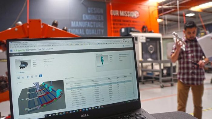

For Elite Aerospace Group, an aircraft component design, engineering, and manufacturing company based in Irvine, Calif., an acquisition was the impetus to get into PLM. As Stuart Weiler, director of CAD/PLM explained, Elite started as a low-complexity, high-volume manufacturer and then acquired a company that was a low-quantity, high-complexity manufacturer. The RFQ processes didn’t mesh, plus the company had people in five different states working on projects, increasing the risk that something would fall through the cracks.
Elite Aerospace opted for Windchill PLM from PTC, Boston, which includes ERP and Customer Relationship Management (CRM) components. Using Windchill, Elite follows a well-defined process, regardless of where the RFQ originates or its format, everything from “a job shop with a request for 50 widgets and paper print, to a 50-page RFQ from an OEM with a zillion requirements,” said Weiler. “Windchill allows us to create an item and then attach all of the other relevant information, such as the drawings, the specs, the processes. Now when you look up that item number, everything’s collected together and you don’t have to go searching. Everything is linked nicely to make it a lot easier and more accountable.”
Weiler also made the point that requests to change a part are handled like a new RFQ, which is logical because any change will likely result in a change in the cost. “In the past, we weren’t always doing that,” said Weiler. “Now, because we’re using the system to do that same review, all the right people oversee the process and we eliminate the risk of someone deciding that a change is ‘no big deal’ without fully understanding the implications.”
Weiler added that one of the biggest wins in moving to a PLM system is finding you can “reuse an existing design rather than designing the same thing a second time. People have a very hard time keeping track of what they already have, including the designs from five or ten years ago. Inventory gets out of control. You wind up with identical parts that have different part numbers. And, because they are being ordered at different quantities, the parts cost different amounts. With better organization, you have just one part number, you’re ordering a higher quantity of that item, and you don’t have all of the inventory costs of keeping multiple items in stock.” The converse is that the system enables you to keep track of many more items, so designing ever-more customized components “is no longer as consequential as it used to be,” observed Weiler. This fits well with the advent of additive manufacturing and a “build it when you need it” approach.

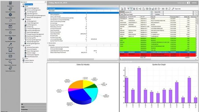

The start-page for the M1 ERP package at Horberg Industries shows open jobs and critical statistics at a glance.
Bob Leety, president of Horberg Industries Inc., Bridgeport, Conn., offered a perspective from the other end of the size spectrum. Horberg specializes in manufacturing small dowel pins, taper pins, and precision shafts to extremely tight tolerances, generally in the high-chrome, high-nickel, high-cobalt materials that are used in high-temperature aerospace applications. With only 15 employees, Horberg was still faced with the need to document compliance with AS9100 plus a number of other onerous requirements, like being able to prove it didn’t use “conflict minerals” (tin, tantalum, tungsten and gold mined in or smelted in the Democratic Republic of Congo or adjoining countries). Managing this with such a small staff drove Horberg to adopt the M1 ERP package from ECI Software Solutions Inc., Fort Worth, Texas, more than 15 years ago. Leety credited M1 with making it manageable, though he added that “the people implementing it need to understand what compliance looks like in order to reach the end game. M1 makes it possible. It doesn’t make it painless.”
Leety also lauded M1’s ability to search for things like all the non-conformances and group them by the root cause. “If you see a pattern, like a lack of training, then you know you need to set aside resources to better train people. Or if it’s a particular vendor, you know you need to put them on notice or find another one. It really helps focus your efforts.” Leety said Horberg also bar codes all of its gages and records each use in M1. So, if later it finds a gage had a problem it can trace every single job on which it was used and quarantine the affected parts.
“We also use a feature that automatically generates e-mails to alert the proper staff on what jobs are due to be released and what jobs or inputs are overdue. It gives you the data you need right on your desk instead of having to dig for it.” Horberg also customized the product to track and alert the qualification status of its suppliers so it isn’t caught depending on a company that lacks the right credentials. Leety also observed that dealing with outside vendors that don’t use ERP can be frustrating. “It’s usually much slower to get information back, and you’re not apt to get equally accurate information.”
One of the sweetest rewards of a good QMS is a short and successful quality audit. Leety said Horberg’s audits typically run two to three days. “We have a computer set up with a projector and a big screen and we’re looking at M1 through the whole audit.”

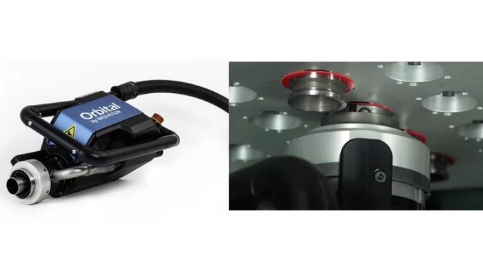

A portable Novator orbital drilling machine and a close-up view of the drill jig and bushings to which the machine is clamped for each hole. RFID tags in the drill plate and machine ensure only the correct hole is drilled.
The introduction of orbital drilling to the production of the Boeing 787 Dreamliner offers an excellent example. As Hans-Petter Andersson, CEO of Novator AB, Spanga, Sweden, explained, carbon fiber composites make up half the aircraft structure and most of that is stacked with aluminum, titanium, or both. Drilling these components with conventional methods is a nightmare and Boeing quickly realized that making the 787 efficiently called for “more tools in the tool box,” as Andersson put it. Luckily, Eric Whinnem, a now-retired associate technical fellow at Boeing’s Long Beach research center, had already identified the potential in orbital drilling. And Novator, then a tiny Swedish start-up, had been working on just such technology.
Orbital drilling rotates the cutting tool around both its own axis and about a principal axis while feeding through the material. (The tool diameter is smaller than the hole diameter and because the tool cuts axially and radially, it’s technically a spiral milling cutter rather than a drill.) Whinnem explained that because of this and the intermittent tooth engagement, chips have room to be evacuated, avoiding the overheating, excessive tool wear, and composite delamination that occurs with the conventional method. But creating a production-ready solution required many design iterations in both the orbital drilling machine and the cutting tools. Based on feedback from Whinnem, Novator further refined the machine and Sonic Tools, Ashland, Va., optimized the cutting tools. Whinnem said both partners delivered the kind of creativity and responsiveness needed for timely development, not to mention friendly pricing—attributes he didn’t always experience with larger vendors. (Walker echoed that OEM R&D departments never have enough money.)
Ultimately, Whinnem’s team created a process that differed in almost every respect from the conventional drilling process, which used Quackenbush motors and “guys up on step ladders stretching to reach the highest points,” as he recalled. “We needed to address every part of the workcell, including properly configured vacuum systems, correctly programmed lubrication systems, and optimal locations for the mechanics, control boxes and motors within the workspace,” said Whinnem. “We ended up improving the ergonomics and were able to reduce the drilling time to about one-third of the conventional approach. And with no mistakes, which was what they really liked about it.” One reason for that last advantage was the introduction of an RFID system that ensures the Novator machine is in the correct position in the jig before permitting it to drill the hole.
The first implementation was on small areas of the wings and body joints and they’ve moved step-by-step through other areas of the 787. According to Andersson, the approach has proven so successful that it’s now being applied to other aircraft and even influencing design decisions. “Right now it’s mainly a technology for relatively large holes in deep stacks where you have enough access for the machines to fit,” he said. “But for the 777X they moved the holes for the upper side of the wings and the body joint in order to get our machines in. That’s pretty cool, isn’t it?”
