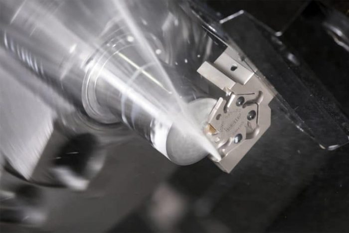

High-pressure coolant is essential for optimum performance in many applications, as shown here with Iscar’s LOGIQ5GRIP cut-off tool. (Provided by Iscar)

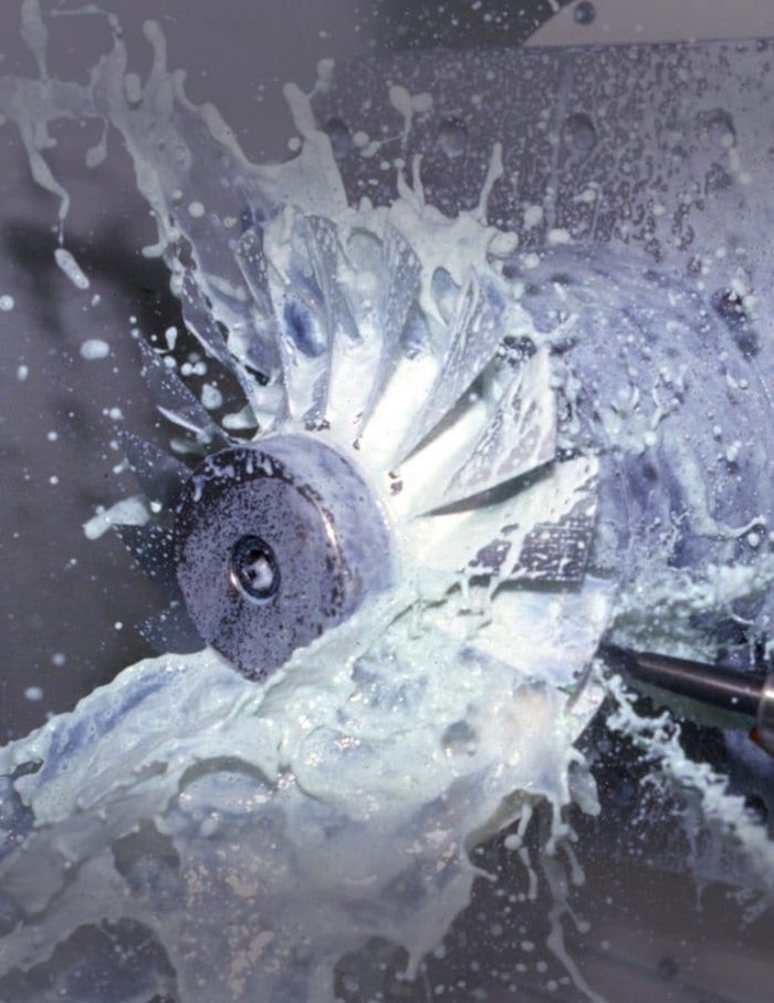

A blisk, such as the one being machined here on a Mitsui Seiki machine, is a good example of the complexity, amount of material removal, and volume of coolant often involved in aerospace part applications. (Provided by Mitsui Seiki)
“You really need to analyze the spindle characteristics. And when you get into really heavy cutting, the spindle might be adequate but do the motors driving your linear and rotary axes also have sufficient torque to perform the operation? It all needs to work together,” he said. Walker added that the machine must adequately handle the harmonics created in the anticipated operating range.
But he also pointed out that excessive vibration sometimes occurs at lower than ideal operating speeds. The counter-intuitive solution is to run harder and faster to find the sweet spot. Finally, he suggested prospective buyers consider a machine builder’s reputation in meeting tolerances and MRRs. Examine what machines the OEMs and their suppliers are using for the same applications. “A machine is usually aimed at doing tight tolerance work or it’s capable of high MRRs, but not necessarily both. With Mitsui, you can have both for a very long period of time,” said Walker.

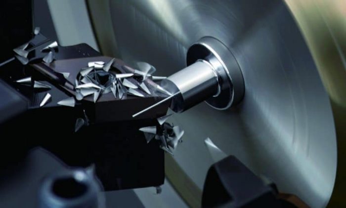

Citizen’s low-frequency vibration technology oscillates the Z axis while cutting to consistently break chips. (Provided by Marubeni Citizen-Cincom)
In turning, Such of Marubeni Citizen-Cincom explained that “Swiss machines often need to take extreme depths of cut to get parts processed.” But most cutting tools and machines can’t handle these extremes. In some operations, the chip will not break, blocking critical coolant from the tool and destabilizing the process. So Citizen developed low-frequency vibration (LFV) technology that oscillates the Z axis while cutting. Such said the tiny movement is timed in sync with spindle rotation to consistently break the chips.Large OEMs are now making some aerospace engine parts by casting a relatively inexpensive material and then using hybrid machines to selectively apply Inconel. He also sees the line between parts traditionally milled vs. turned is becoming blurred.
“There are programmable ways to make the tool enter and exit the cut repeatedly while cutting, and the programmer can still cut two-axis angles or radii with tool nose radius compensation, all with the exact same CNC code they’ve always used,” he said. “Just turn LFV on and it’s done. LFV is also great for axial drilling or live tool cross drilling. Both of these cuts can better perform while in Citizen LFV mode.”

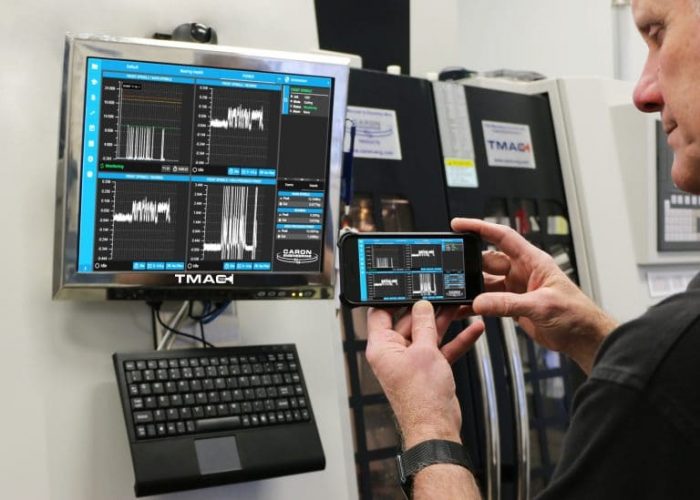

Rob Caron and his team at Caron Engineering Inc. in Wells, Maine, have developed a suite of solutions for aerospace. Since aerospace manufacturers focus on achieving a stable process that minimizes scrap—and many aerospace materials are hard or abrasive—machinists tend to run conservatively. Caron created an adaptive control product that automatically makes continuous, real-time adjustments to the machine’s feed rate as the tool moves through the material.
“This enables users to program more aggressive cuts knowing that if the tool will break or the material has some hardness anomalies, we’ll automatically slow the tool down at that point,” explained Caron.
The company’s system, Tool Monitoring Adaptive Control (TMAC), is not just software. Nor does it rely on the machine’s inherent torque sensing. Instead, Caron adds a “far more sensitive device for measuring cutting power than what the controls deliver. It’s infinitely scalable and we can change the sensitivity on the fly based on what type of tool is cutting and how much it’s cutting.”
Interestingly, while Caron said a few machine tool builders resist the addition of TMAC, “the control guys are fine with it. Most of them really want it and come to us. The big guys, including FANUC, Siemens, and Okuma, want us to integrate.”
For example, an OKK HMC equipped with a FANUC 310is-A control was profiling and scalloping the flange on a 718 Inconel jet engine case with a 1/2” (12.7 mm) end mill and assorted drills. Due to the varying cutting conditions, the feed rate had to be set to accommodate the worst material condition, resulting in a part cycle time of about 25 hours. After implementing TMAC, the shop reduced scallop milling time by 60 percent.
TMAC also looks at both tool vibration and bearing health. “By monitoring changes in the level of tool vibration in a cut, we can alert the user to problems,” explained Caron.
Caron Engineering’s TMAC system can display multiple sensor channels at the same time, even on a handheld device. (Provided by Caron Engineering)

Finally, there is strong agreement that, except for some composite materials, high-pressure coolant (up to 1,000 psi) is essential for maximizing throughput. Look to companies like ChipBlaster and MP Systems to add this capability to existing machines. Iscar’s Sullivan praised a new feature that enables the machine control to tell such add-on pumps to change the coolant pressure for different cuts, as programmed. That is important, he explained, because some tooling is pressure sensitive. For example, one insert might work best at 600 psi while others cannot get enough.
Cutting Tool Considerations
Both Iscar Metals and Sandvik Coromant, Fair Lawn, N.J., focus on aerospace and both have placed a premium on delivering high-pressure coolant to the cutting zone. Scott Lewis, Sandvik Coromant’s aerospace industry specialist, calls his company’s concept “high-precision coolant.” The toolholder includes nozzles that direct the coolant to exact locations on the cutting edge to optimize tool life and the performance and consistency of the tool. Lewis said coolant aids both heat and chip removal, depending on the shape of the insert. “Most of our holders have above and below coolant flows,” he added.
Iscar’s approach is similar in its LOGIQ turning and cut-off line. Sullivan explained that cut-off tools are by their nature susceptible to failure “so getting coolant to the tip of the cutting tool is a huge advantage and you need high pressure to do that.” Sullivan also pointed to his company’s LOGIQ drill line, which includes indexable, helical drills with screw-on heads that deliver coolant to the tip even up to 12xD.
