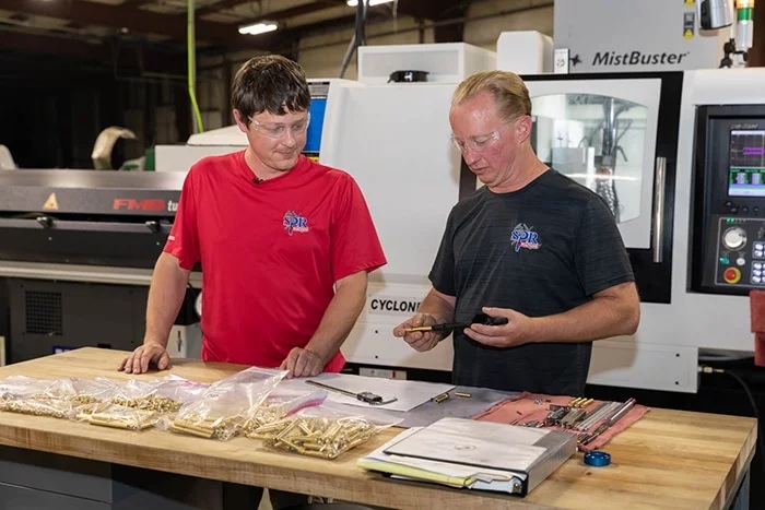

CNC operator Dave Burton (left) and Scott Pater, co-owner and co-founder of SPR Machine, inspect brass parts machined on a seven-axis Swiss-style Ganesh Cyclone GEN TURN 32-CS lathe. (All images provided by Copper Development Association)

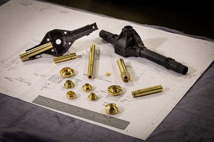

The opportunity arose when co-founder and company vice president Scott Pater combined his passion to race off-road and radio-controlled (RC) cars with a friend’s engineering expertise. When the friend created a reengineered version of an RC part and began marketing it to hobby shops, Pater showed him that SPR would make a better supplier than a vendor in China, especially given that off-shore ordering meant waiting months for parts.

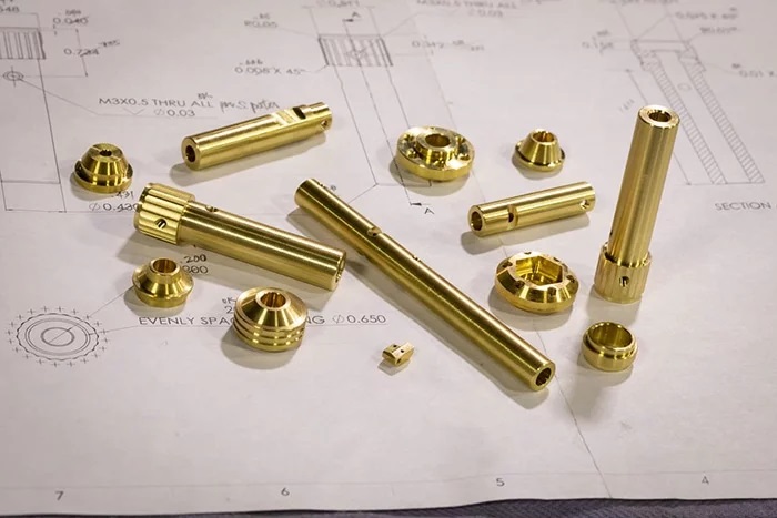

The initial design specified 12L14 steel, a material that corroded and swelled once it was in use, making it difficult to remove the part. Aluminum solved the corrosion problem but lacked the strength and weight needed for stability in a small vehicle with a low center of gravity. Brass offered both, along with an attractive appearance, which was important for a consumer product. In addition, brass didn’t produce the long, stringy bird’s nest chips SPR experienced with other metals, especially in a part with a nearly 4″ (101.6-mm) long drilled through-hole. “Brass is quicker to machine [and produces] chips that flow smoothly out of the machine, and customers like what they see in the finished parts,” Pater said.

In addition to turning, the part initially required ball milling, drilling numerous deep holes, and boring out a bearing surface in the inner diameter. The GEN TURN 32-CS’s multiple spindles and axes saved production time, but Burton’s initial production program yielded a six-minute, 17-second part cycle, which translated to 76 units per eight-hour shift. After SPR implemented TechSolve’s recommendations, cycle time was reduced to two minutes and 20 seconds, and parts per shift skyrocketed to 191.
To achieve this optimization, TechSolve identified several areas in which SPR Machine could reduce cycle time. Instead of ball milling, SPR could substitute broaching, ganging up parts and machining five slots at once. That’s a strategy that most likely would not have worked if the part had been made from stainless steel or steel. SPR saved still more time with a carbide drill for pecking, more-aggressive feeds and depths, and fewer retracts, along with an increased depth of cut for roughing. Balancing the workload between the two spindles meant that neither waited for the other to complete a process, which increased throughput. Finally and most importantly, the machinability of brass meant that the process could proceed at high speeds and feeds.
