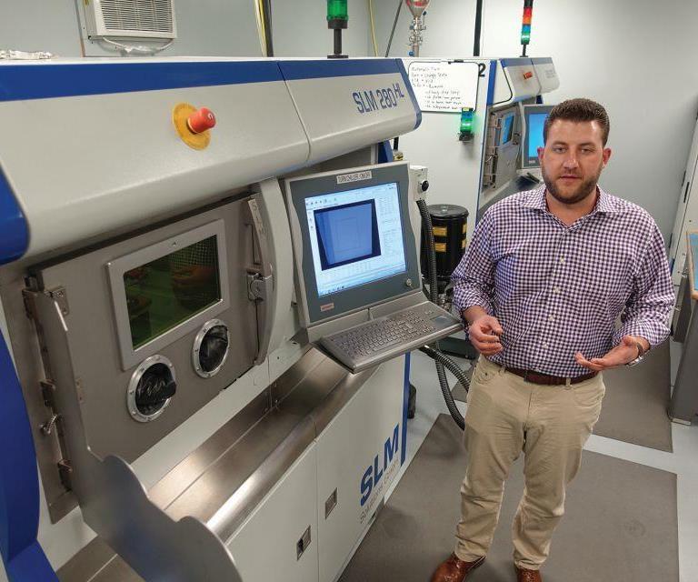

The heart of Imperial Machine & Tool’s additive-manufacturing operations are these two SLM selective-laser-melting machines.

SLM machines: The heart of Imperial Machine & Tool’s additive-manufacturing operations are these two selective-laser-melting machines, the first delivered in 2013 and the second, with a twin-laser design, in 2015. After about 2 years of trial-and-error, the company found its groove and has been producing components via a 3D-printing/precision-machining hybrid process ever since.
