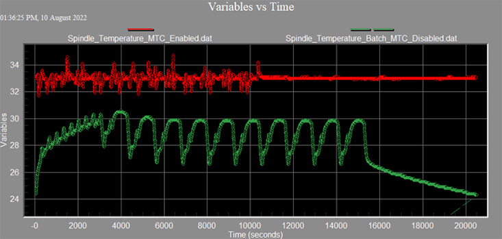

A near universal approach to precision machining is to run the machine in a warmup cycle to bring all the elements of the machine to some level of thermal stability. Typically, this warmup cycle will take approximately half an hour. Using MTC, this time can be reduced to around 5 minutes. Figure 1 shows the impact of MTC on actively heating the spindle to reach working temperature quickly.

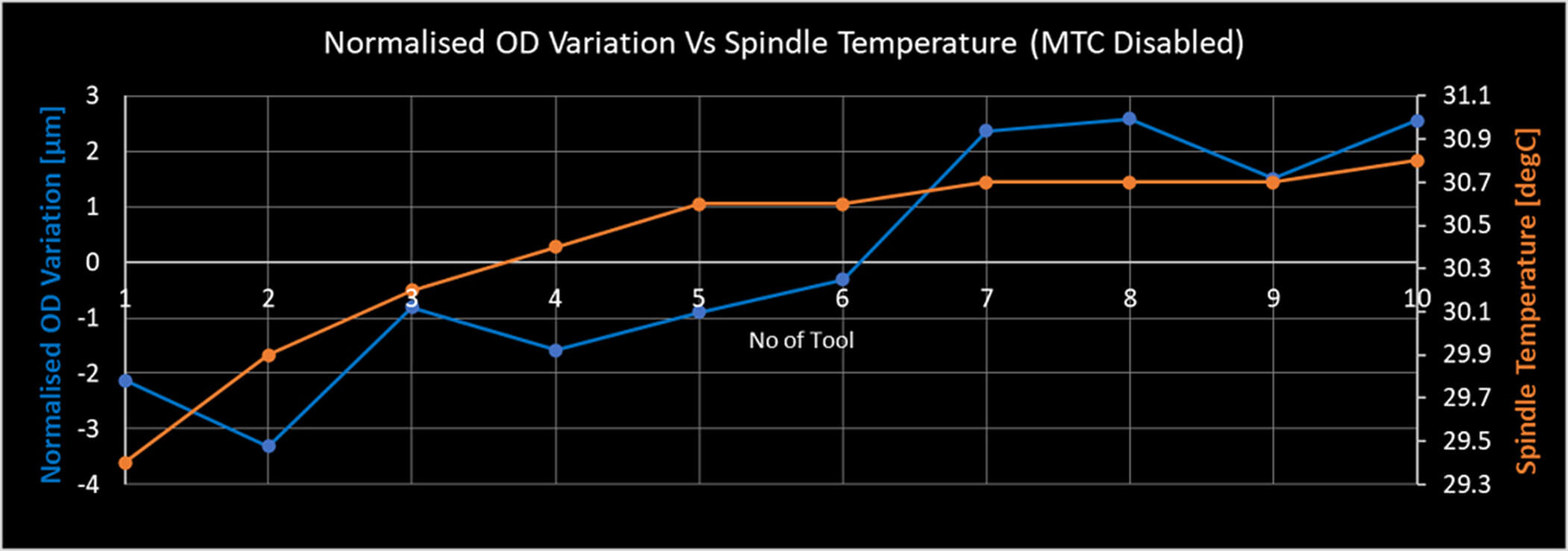

Stability in batch grinding of endmills

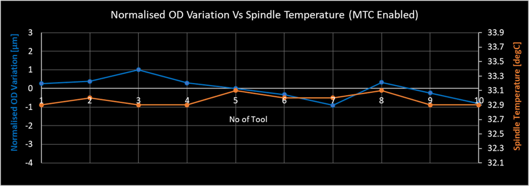

Figure 2 shows the results in grinding two batches of 6mm diameter endmills, with and without MTC.

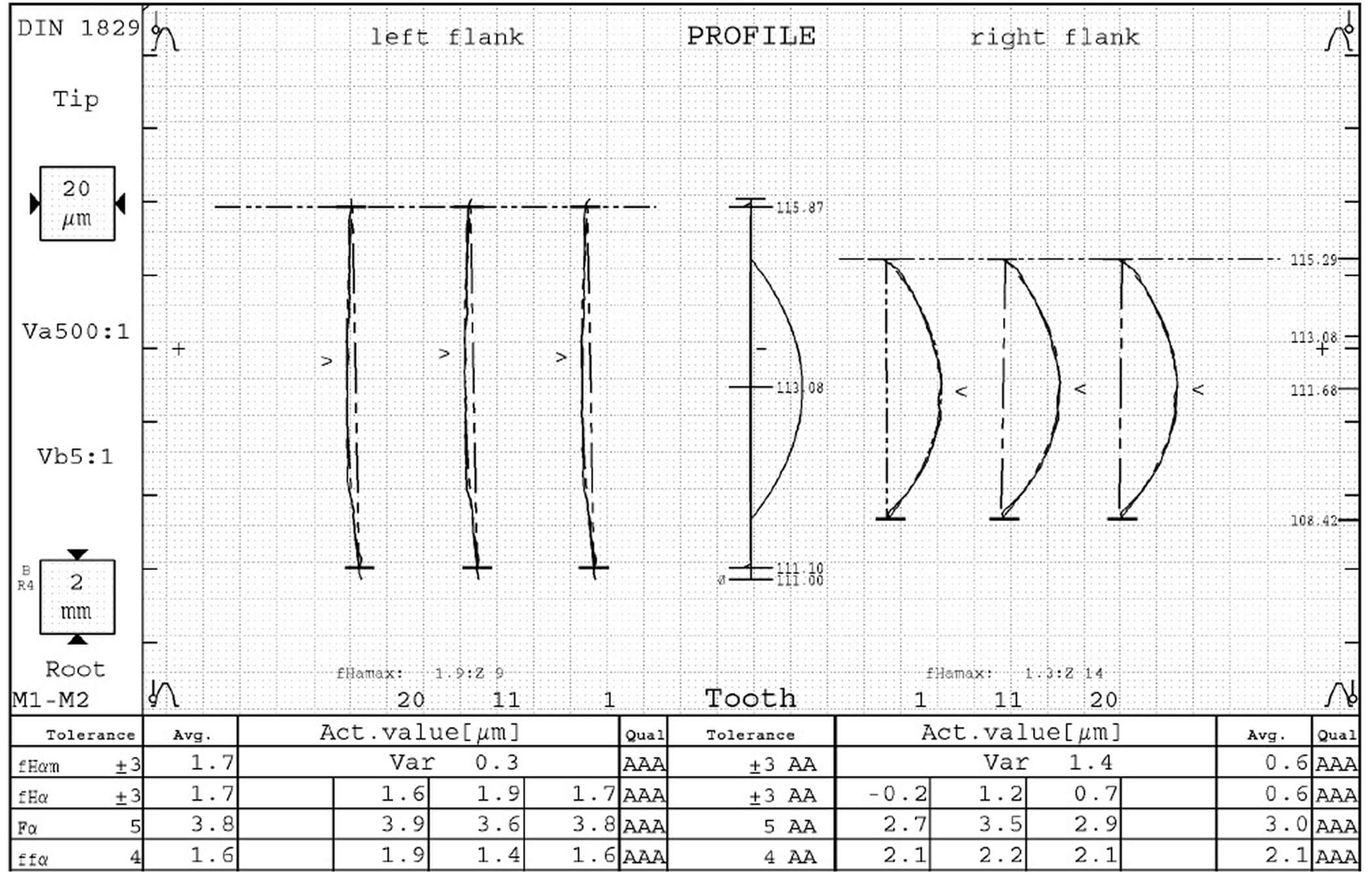

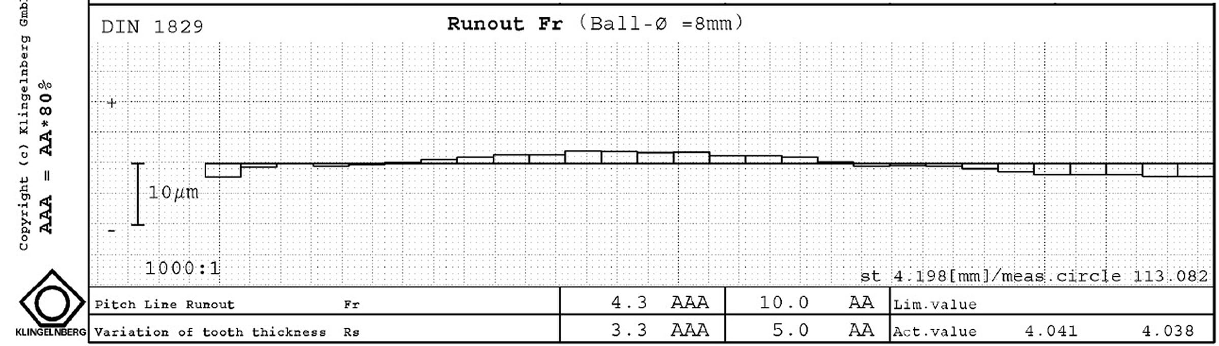

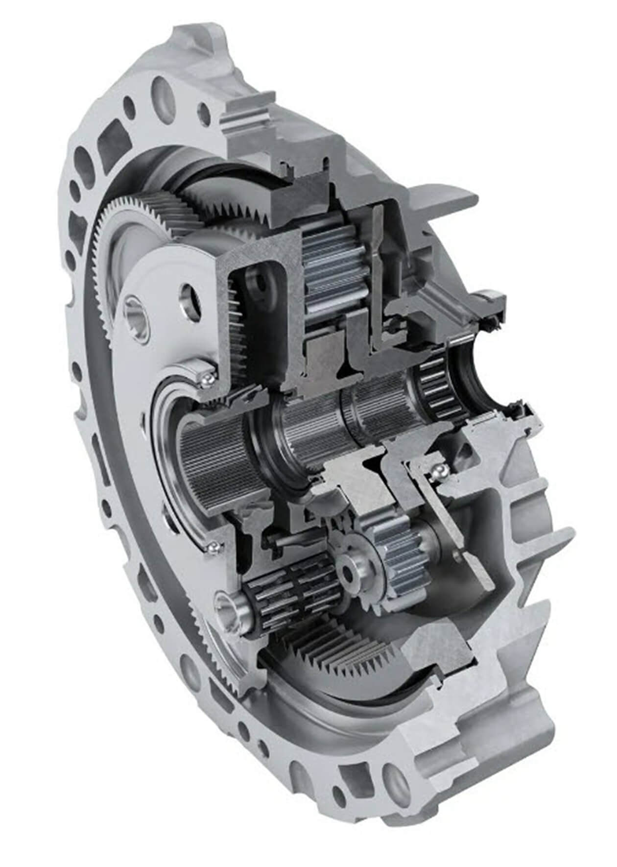

Electric vehicles incorporate a high-speed gear box in their drivetrain. The accuracy of the components of this gear box will impact on lifetime, efficiency, and noise of the electric vehicles.  Figure 3 shows a typical skiving cutter which is used to manufacture internal and external gears and will determine their accuracy. ANCA manufactures a special machine, the GCX, for grinding this class of tools. MTC is a key enabling technology for this machine to produce cutters to AAA class. Firstly, it is used to control the temperature of a dressing spindle which is used to create a high accuracy profile on the grinding wheel. MTC is also being used to control the main grinding spindle temperature during up to 12 hours of continuous grinding. Figure 4 shows the measurement results for contour accuracy of a tooth and index accuracy for all the teeth.
