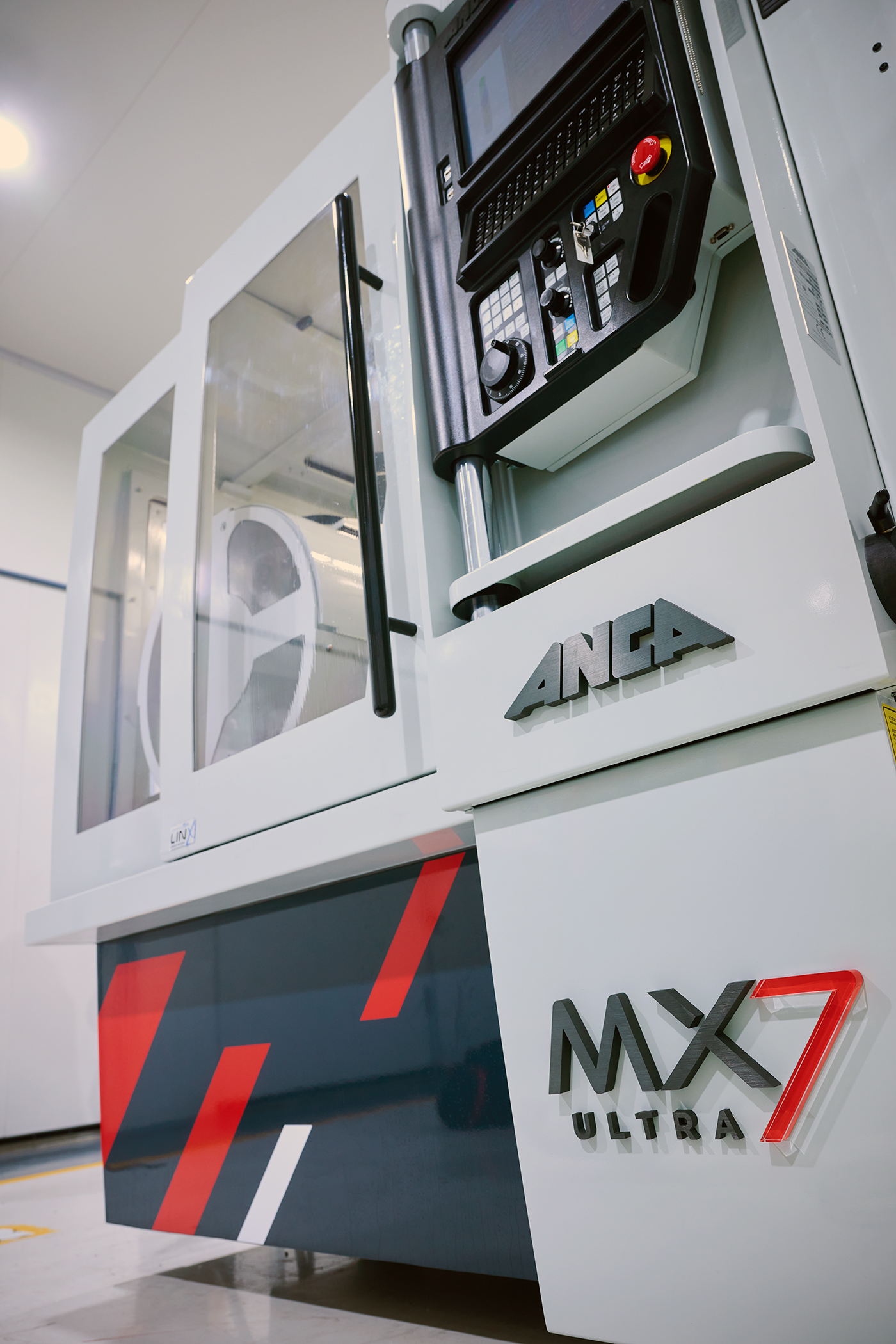

Introducing one-nanometer axis resolution, the new MX7 ULTRA machine’s performance can maintain less than +/- 0.002mm line form accuracy of any profile which includes ballnose and corner radius endmills. See the ultra-performance machine at IMTS – Booth #237406.
The new MX7 ULTRA can manufacture large volumes of endmills and other cutting tools of the highest accuracy and quality. The minute size of a micron is beyond the human eye, but in becoming even more precise and moving from micrometers to nanometers, ANCA will offer the highest accuracy and quality in a cutting tool in the market. New software, hardware and design features are combined to make significant advances in surface finish, accuracy, and controlled runout, to deliver batch consistency from the first ground tool to the thousandth.

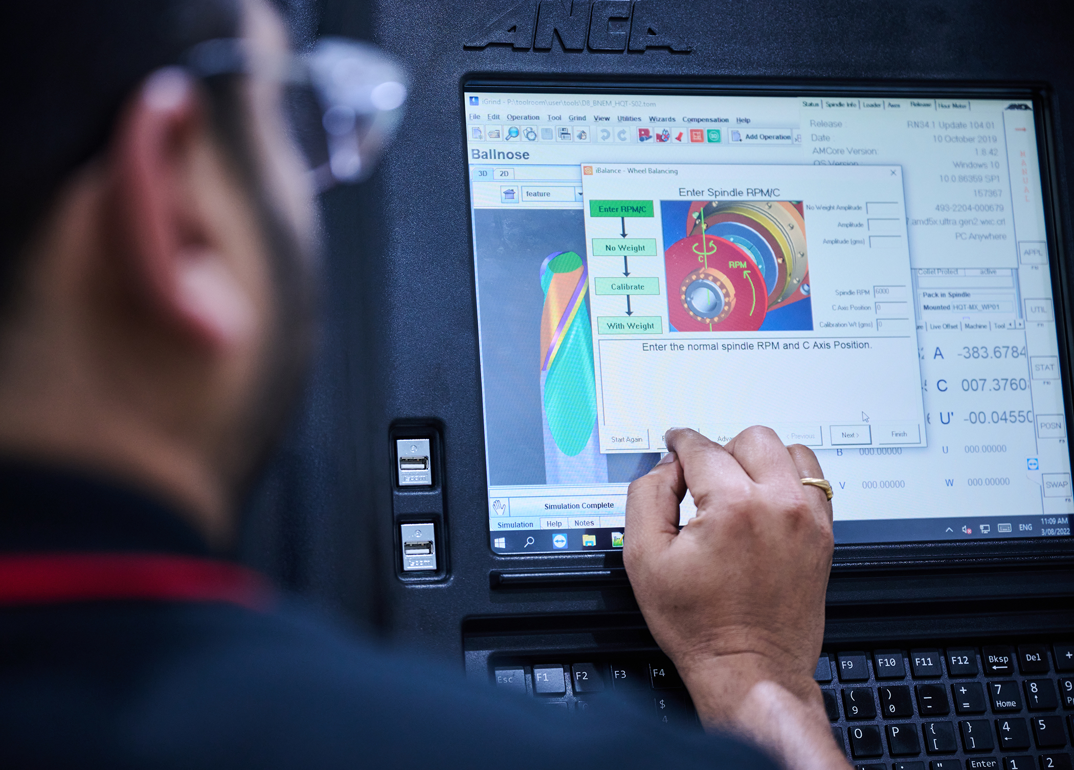

Increased wheel life and better-quality tools: Tool and wheel performance can be further optimized by the iBalance software, which guides a user to the optimal grinding position and RPM for vibration monitoring and balancing the wheelpack inside the machine. Correctly balanced wheel packs result in superior surface finish and reduced wheel wear due to the elimination of wheel vibration.

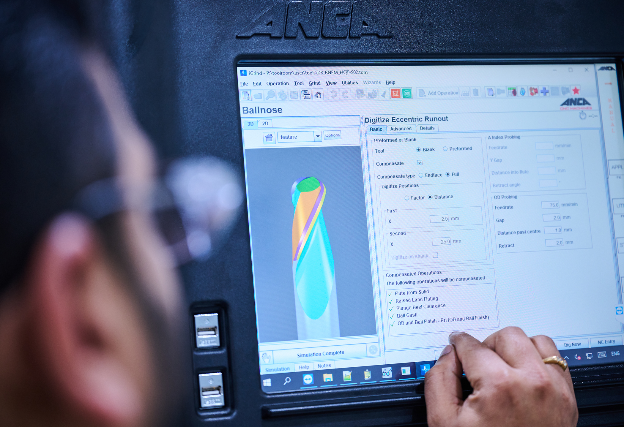

Consistency in finished tool quality: A major inclusion in the MX7 ULTRA package is the total tool runout measurement and compensation operation in iGrind. When an endmill is in rotation it is important that each tooth hits at the exact same spot along the workpiece for longer tool life and efficient cutting. Every tool in the batch can be measured and compensated for runout to make sure the entire batch is within a tolerance of 0.002mm. It is another piece of assurance that the first endmill will be as good as the last.
