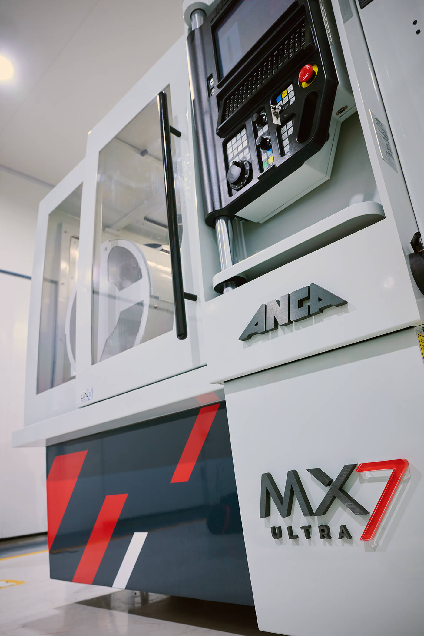

MX7 ULTRA – ACHIEVING NEXT GENERATION ACCURACY AND QUALITY
The Maserati of machine tool manufacturing – the new MX7 ULTRA can manufacture large volumes of endmills and other cutting tools of the highest accuracy in the market. A micron is already smaller than a human eye can see, and ANCA’s latest technology now offers even more precise nanometer accuracy for cutting tools.
New software, hardware and design features combine for significant advances in surface finish, accuracy, and controlled runout, to deliver batch consistency from the first ground tool to the thousandth.
“The ULTRA machine is truly market changing. It is the culmination of ANCA’s elite technology, deep industry knowledge, and customer experience in grinding,” says Thomson Mathew, ANCA product manager for the MX series and software products.

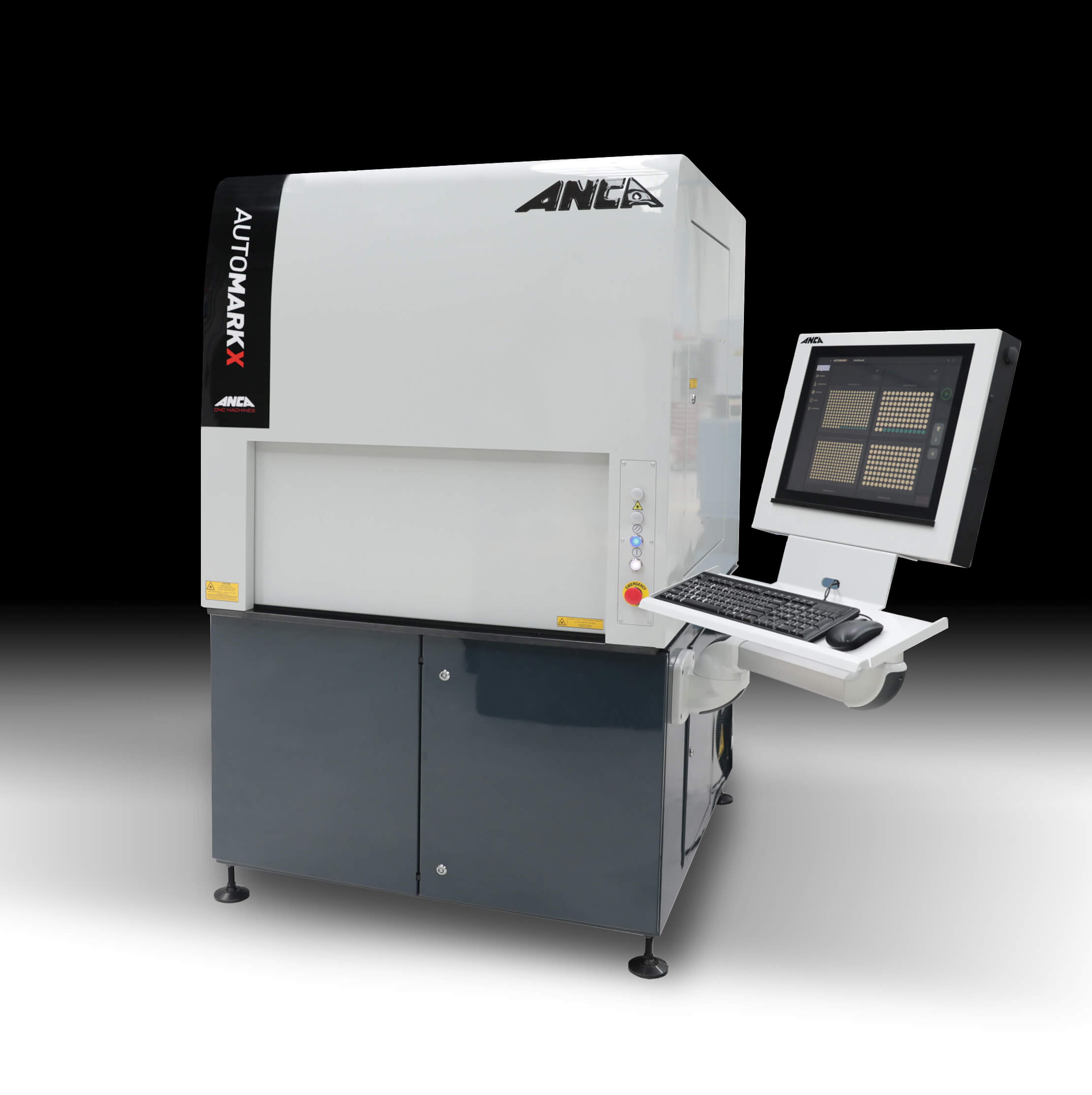

AUTOMARKX: ANCA’S AUTOMATIC LASER MARKING REMOVES COSTLY MANUAL HANDLING
AutoMarkX is an automatic stand-alone laser marking station replacing manual and labor-intensive processes. Automating this saves you money and by avoiding manual handling, tool quality is protected by eliminating risk of chipping. It is AIMS Ready, which means it can be used as a standalone machine but could be easily integrated to your lights out, unmanned AIMS manufacturing cell with automatic pallet transfer using AutoFetch robot.
AutoMarkX accepts up to two full pallets of tools, which means you can mark a large batch of tools unmanned. Flexible marking means the message could be etched on a single side of the shank or, using the AMX’s new rotary workholding, on opposite sides of the shank as well as at the end of tool.
This latest laser marking option is particularly useful for applications where a unique tool identification code (e.g. Datamatrix) needs to be etched on the tool. Typically etched on the shank, they risk exposure to excessive surface wear which renders them unreadable. The end of tool is the best location to etch this type of code and overcome this issue.

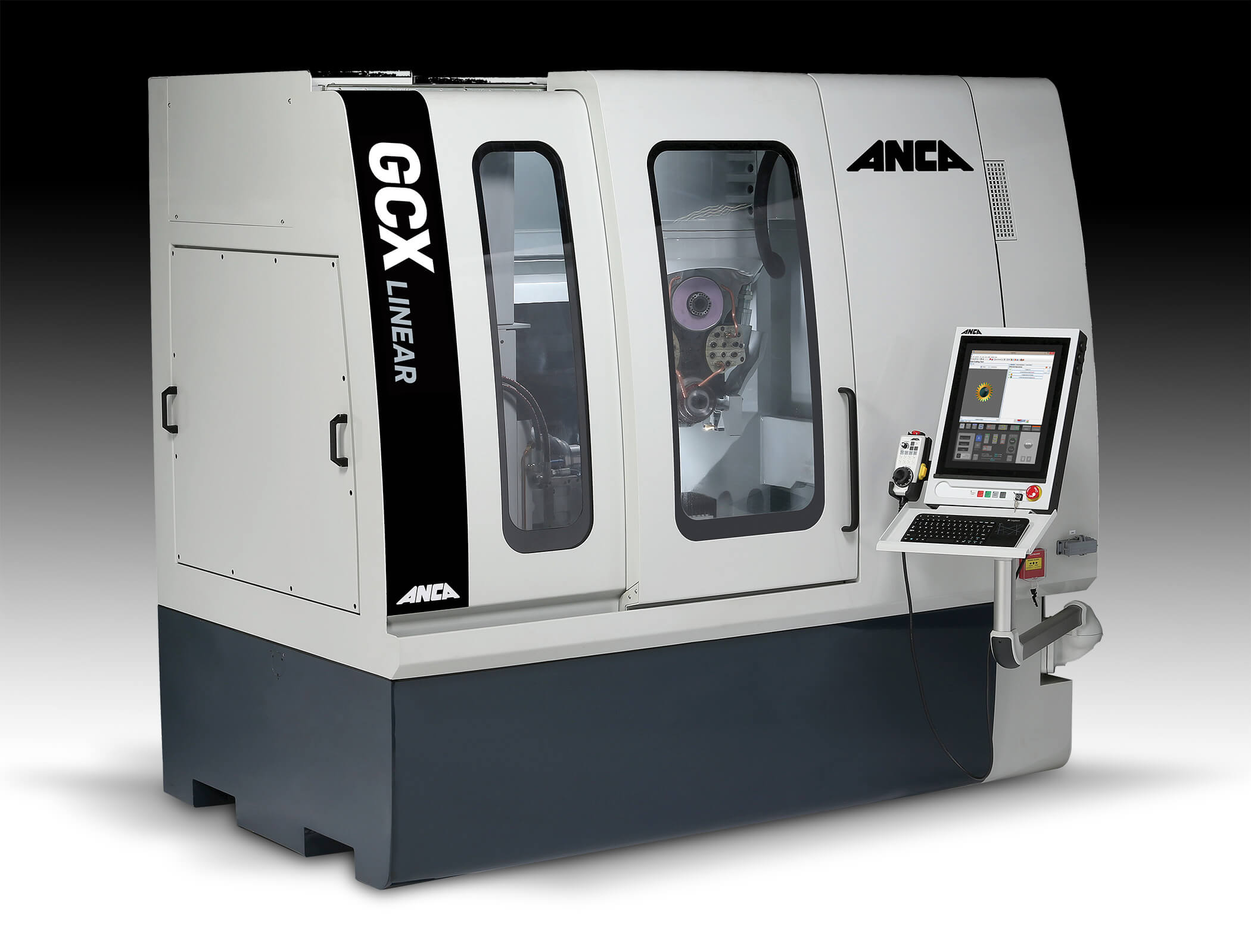

GCX LINEAR: GEAR UP FOR THE EV REVOLUTION
The rise of electric vehicles (EVs) is here and the demand for skiving cutters has seen 30% year on year growth. The GCX Linear provides a complete solution to tap into this rapidly developing market, including the ability to produce skiving cutters, shaper cutters and regrinding of hobs. It offers advanced stand-alone software to design and optimize the tool, neatly interfaced with the gear tool package inside ANCA’s renowned ToolRoom software.
The machine is designed for accuracy with features including all axes with LinX linear motors and an enhanced headstock. GCX Linear boasts a series of technologies: AEMS dressing, MTC on grinding spindle and dresser spindle, integrated gear tool measurement and direct compensation – setting the new standard for producing skiving tools that achieve the highest DIN AA quality class.
ANCA has developed a world-first integrated gear tool measurement system, which enables all the grinding-measuring-compensation to be done in the machine.
