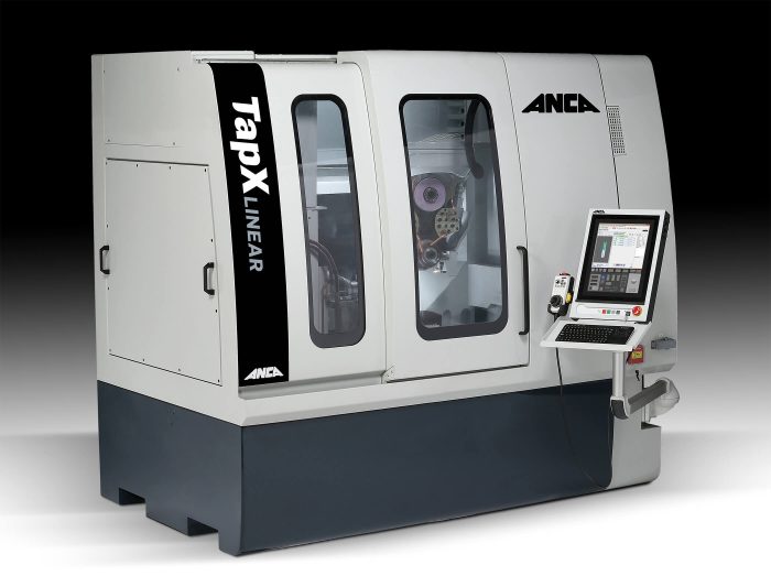

With the boom of automotive and aerospace applications, ANCA sees great potential for the future of the high-end tap market. ANCA’s years of experience working with tap manufacturers has given the company valuable insights into the industry challenges, making it well-equipped to offer the right solution. The TapX is a machine specifically designed and integrated with automation to ensure high productivity in mass production. As a one-machine solution with single clamping, it guarantees substantial benefits for manufacturing standard and special taps by eliminating the traditional requirement of needing several grinding machines.
Flexible, precise and efficient one-stop tap grinding is simply unimaginable on ordinary grinding machines, as high-speed steel taps, carbide taps, micro taps and non-standard taps require different and detailed solutions. The difference lies in the performance of a single grinding process, a parallel grinding process or a combined grinding process. In addition, several grinding machines are usually required, each performing a specific tap grinding task. TapX integrates the various processes into one machine.

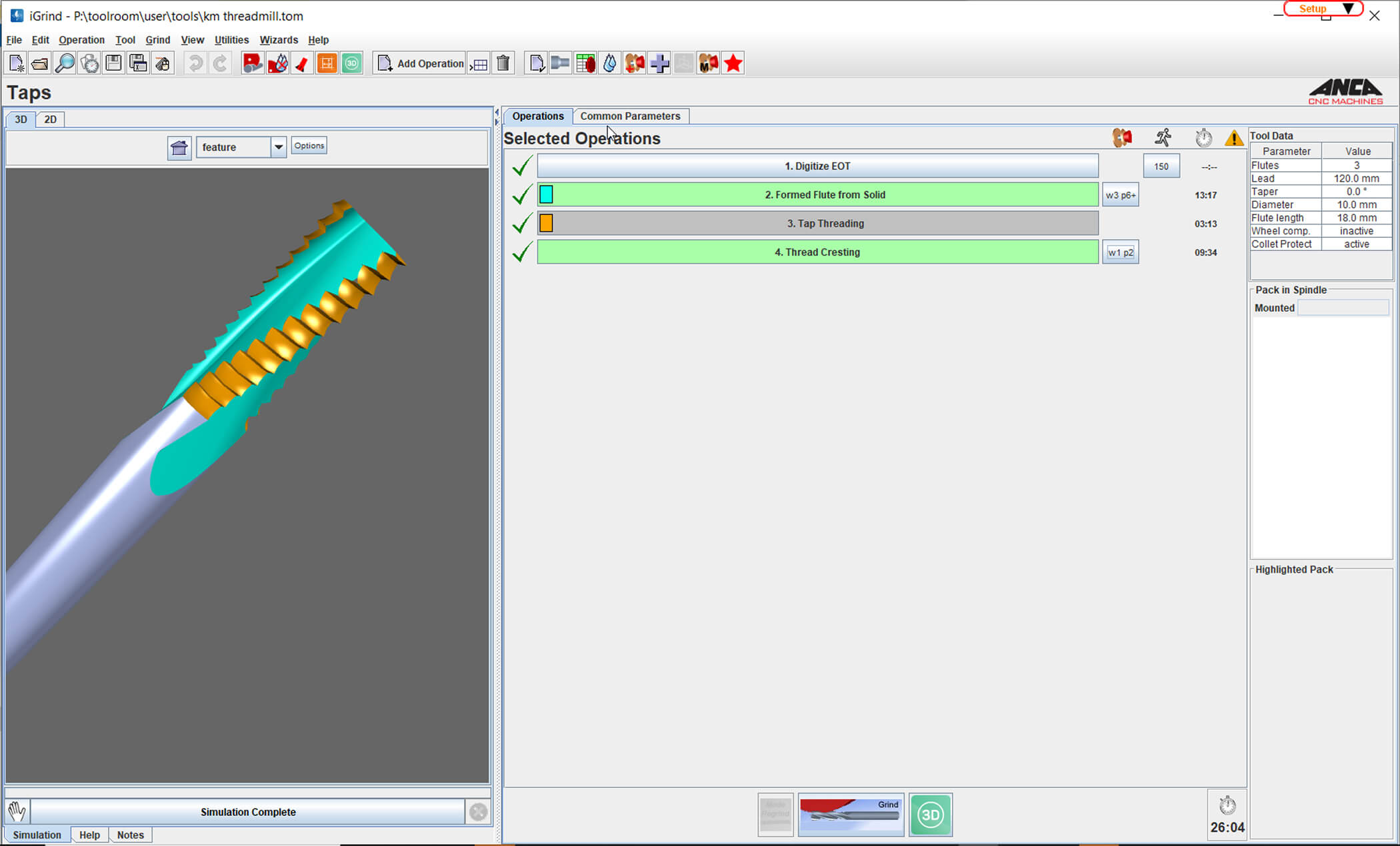

Flexibility is a key feature of the tap grinding process on the TapX. The specially designed machine and powerful ToolRoom software ensure a vast range of tap types and sizes can be designed and manufactured in one set-up. Combine this with the benefits of quick changeover time and it’s not hard to see how TapX can increase productivity and reduce lead times.
The production of taps in different materials is an example of how this highly flexible solution can contribute to productivity. Taps are mainly made of HSS and carbide materials, which require high precision, surface finish and reliability for grinding. TapX is suitable for the complete production of HSS or carbide taps. With a single set-up, it can grind various types of standard taps, micro taps and non-standard taps. Its excellent rigidity guarantees repeatable, high-quality results, while its CNC control plus programmable force of the center ensures reliability of high frequency movements.
The TapX uses ANCA’s own LinX motor technology for all linear axes and direct drive technology for all rotary axes. By eliminating all belts, pulleys, and gears, the TapX is not only a more precise machine, but a more reliable one as well.

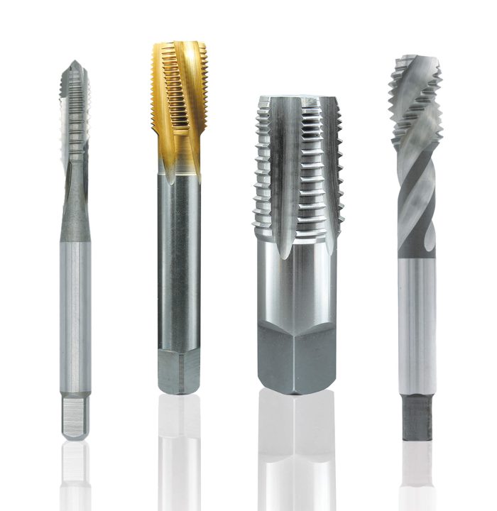

Although HSS will remain the dominant material of choice, carbide tools are growing in popularity with the increase in thread milling applications and introduction of more exotic materials. Compared with HSS, carbide offers high rigidity, good machining quality and long service life. Consequently, the production of carbide taps presents challenges for machine productivity, accuracy and dressing of special thread grinding wheels.
TapX offers the perfect solution with its single clamping to optimize the grinding process. Combined with greater flexibility in wheel selection and process deployment, this revolutionary solution means more flexibility, reduced costs and increased tap production output. The total set-up time for multiple general machines is reduced from three to four hours to one hour for one TapX machine, which significantly reduces lead time for small to medium batch production, urgent order response and customer changes. In recent years, ANCA continues to innovate and has developed a unique solution for dome carbide taps with a wider application. Its superior performance is unmatched in the industry.
Recognizing the efficiency, accuracy and reusability of TapX, customers have begun to expand their product range to include spiral, straight flute and forming taps, and even micro parts. Micro taps are mostly used in smartphones, glasses, consumer electronics, aviation and military industries. Any miniaturized part may be machined with a small or micro tap.
