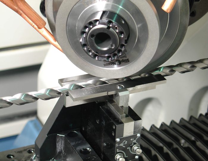

One challenge is the need to control grinding forces consistently throughout the entire length of the tool. This is crucial because long drills are designed to create holes that are not only accurate but also maintain their straightness over extended distances. The reduction of deflection caused by grinding forces is important. When fluting the drill in the shortest possible time, high feed rates and forces are necessary. It becomes crucial to find ways to minimize deflection while maintaining the required machining efficiency.

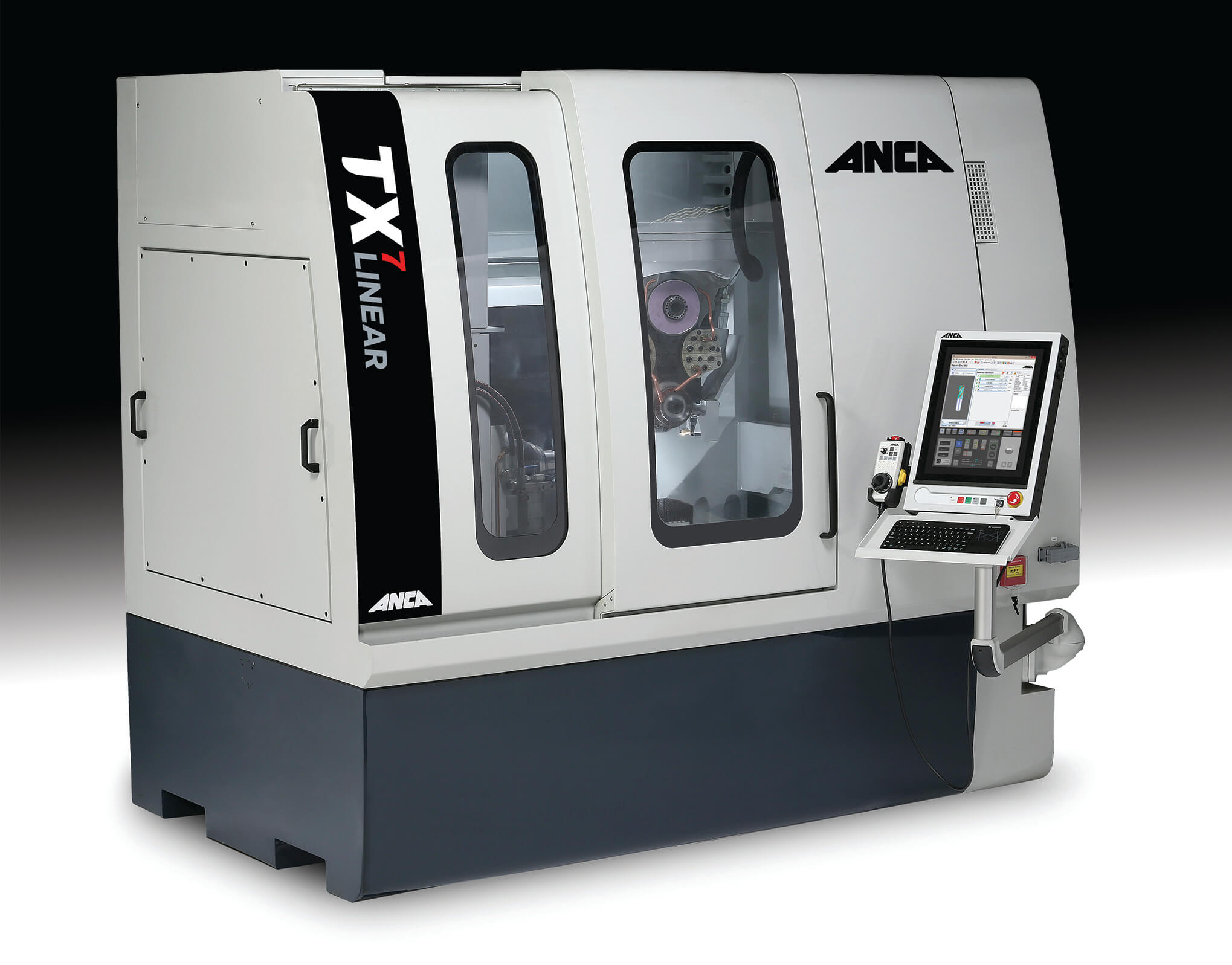

ANCA’s TX7 is the machine for long drill production
ANCA is the only CNC grinding machine manufacturer with complete vertical integration in its manufacturing process. This integration not only fosters innovation across all aspects of design and production but also enables ANCA to respond swiftly and effectively to demanding requirements with unique solutions.
The TX7 machine’s powerful 37kW (49hp) direct drive spindle, facilitates the efficient grinding of long drills without putting excessive strain on the machine. It boasts a spacious working envelope and a 6th axis with a traveling steady support that can be positioned strategically to provide support in the grinding zone, allowing for the accommodation of tool lengths of up to 480mm. This setup eliminates deflection and minimizes vibrations caused by grinding forces on the tool. It also addresses the issue of runout, as the steady supports enable compensation control to mitigate runout errors effectively.
