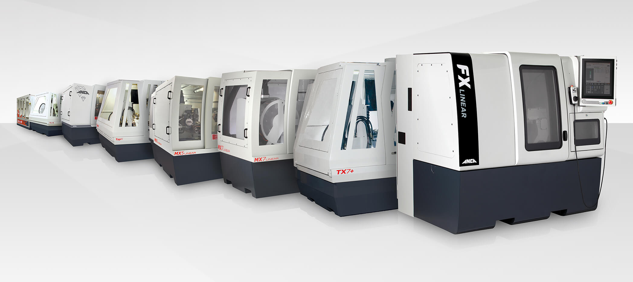

An essential component of achieving good accuracy and repeatability when grinding a cutting tool is the base. Having a stable foundation for a machine is paramount to achieving stable production. As part of ANCA’s commitment to vertical integration, in the late 1980s Pat McCluskey decided to replace the bases that were then outsourced with an ANCA designed and manufactured base.
McCluskey’s research was conducted primarily in Europe in conjunction with Aachen University who had carried out some research in polymer concrete in machine tool applications. He worked with German and local consultants to develop ANCA’s recipe for concrete base manufacture. The base molding technology they developed has since been an important part of the rigid ANCA bases.
The first base was poured in late 1989. Further pouring and testing followed until everyone was fully satisfied. Now called ANCAcrete, this technology would provide the best possible foundation for precision CNC grinders, reducing vibration and increasing the overall rigidity of the machine.
Since 1991 we have been using the polymer base technology which forms the stable foundation base of all ANCA machines. Customers often ask us to explain the benefits of polymer concrete and we explain that polymer concrete by its very nature has a high thermal mass, so our bases are good at absorbing a lot of heat.
That means that throughout the production processes, their growth and contraction are very controlled and it takes a long time which means that the process is very, very stable. The second main part of polymer concrete is that when we designed the mix over 20 years ago, it was made to mimic the expansion thermal coefficients of cast iron very closely. This means that as our machines heat up and cool down, we can control the expansion and contraction of the machine – which in turn, gives us control over the production processes to make sure that the machine aligns to how we want it to react.
Between the large thermal mass, the very closely linked thermal expansion coefficient to cast iron and also the vibration absorbing characteristics, ANCAcrete significantly contributes to the overall rigidity of the machine. For our customers this translates into highly accurate tools with a superior surface finish.
