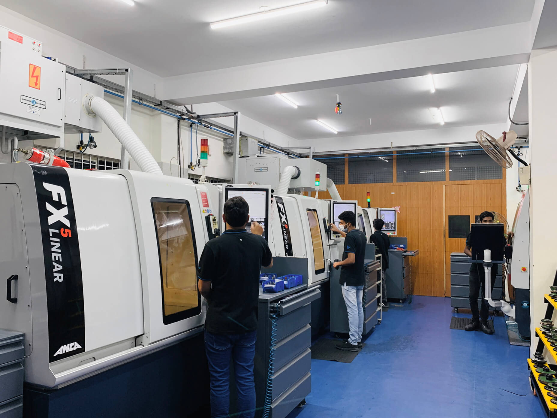

SST Cutting Tools added an ANCA FX3 with linear scale technology, which can produce tools with an accuracy of three microns. “We were amazed by the machine’s output and speed. Our efficiency and accuracy went up. This provided a boost to our much-needed confidence and now we’re out in the market looking for precision cutting tools requirements,” says Kumar.
As orders increased, the company grew. A plot of land was purchased and construction of its factory began in 2016. “We were small players, but I always maintained one thing – never compromise on technology. Moving to the new factory in 2017, we added a Zoller tool inspection machine, which could measure any kind of tool profiles with the accuracy of one micron,” he explains.

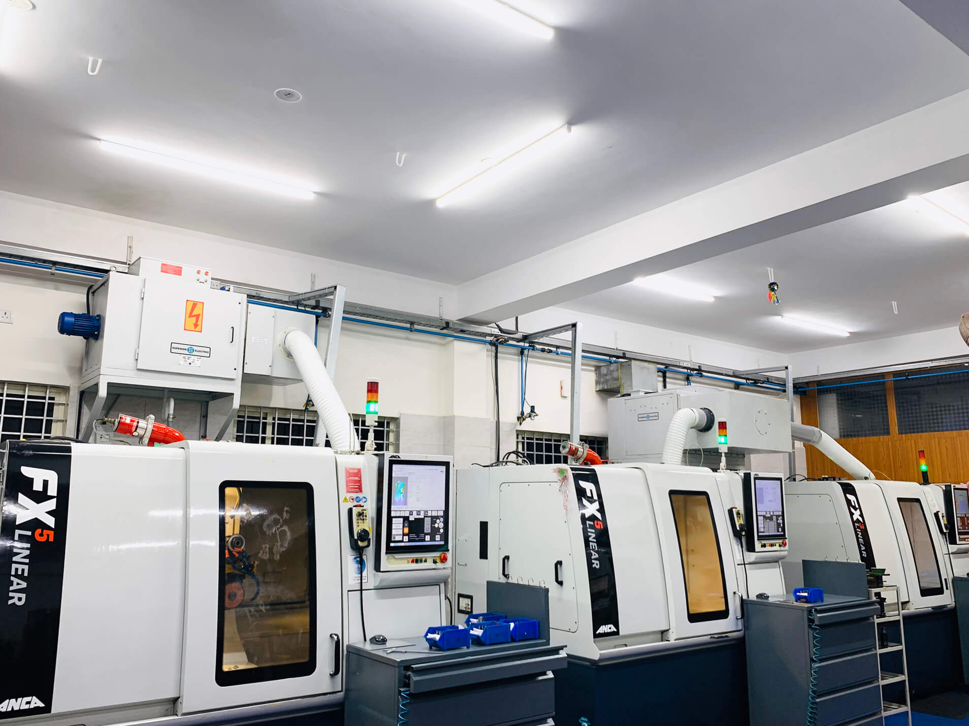

The company started taking precision cutting tool orders, with many happy customers. “We received several repeat orders and a lot of new inquiries. We needed to enhance our efficiency further by reducing the setup time. I discussed this challenge with the ANCA team, and they suggested the ANCA FX5 fully automatic linear machine. I saw the demo, observed all the features, and opted for it in March 2018. It was the perfect match for my requirements. The machine is equipped with a 2-wheel changer that helps us reduce the number of setups,” informs Kumar. SST added one more advanced version of the ANCA FX5 in 2019. It is fully automatic and provides high accuracy and an in-process measuring camera.

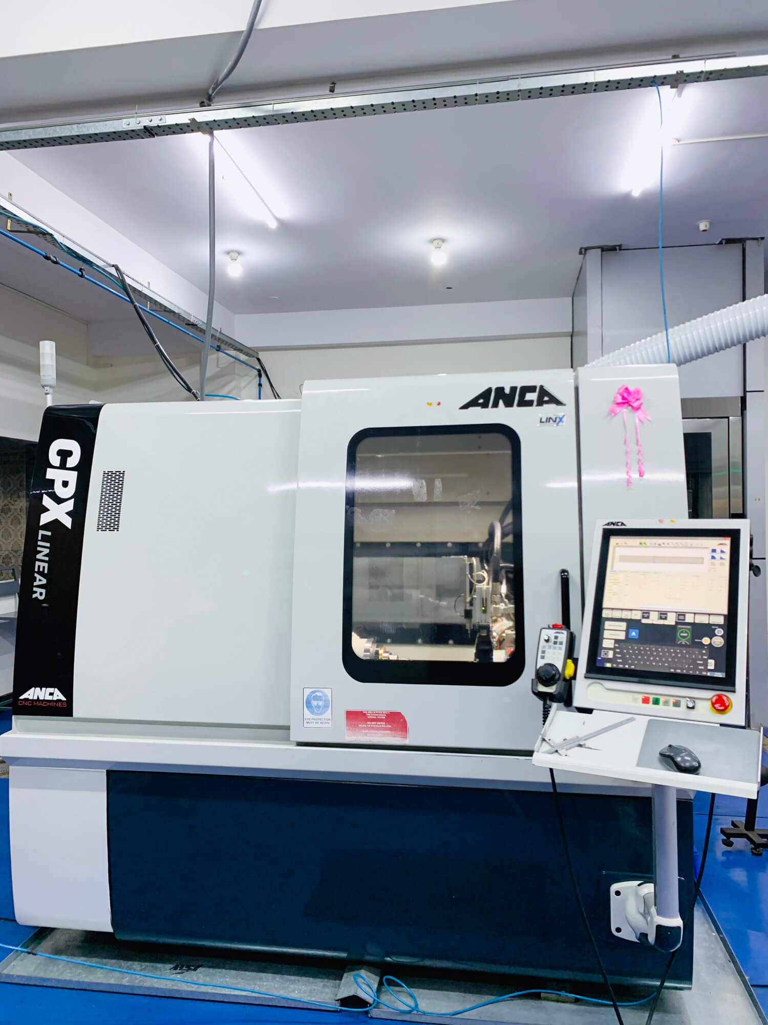

One of the most important and challenging activities for cutting tool manufacturers is to prepare precision blanks with close tolerances. The right blank can define the overall cutting tool. “With time, customers have also become very demanding. They want a cost-effective and accurate product on time. However, in 2021, the volume of orders we had in our current setup needed an upgrade, especially for the preparation of blanks. I wanted to reduce the blank preparation time with 100% accuracy and decided to opt for the ANCA 4 Axes CPX blank preparation machine,” says Kumar.
The CPX Linear is capable of achieving a surface finish better than 0.2Ra with a run out of less than two microns. “With the addition of a CPX Linear, we can make tools in a few hours, thereby meeting urgent requirements,” he adds.

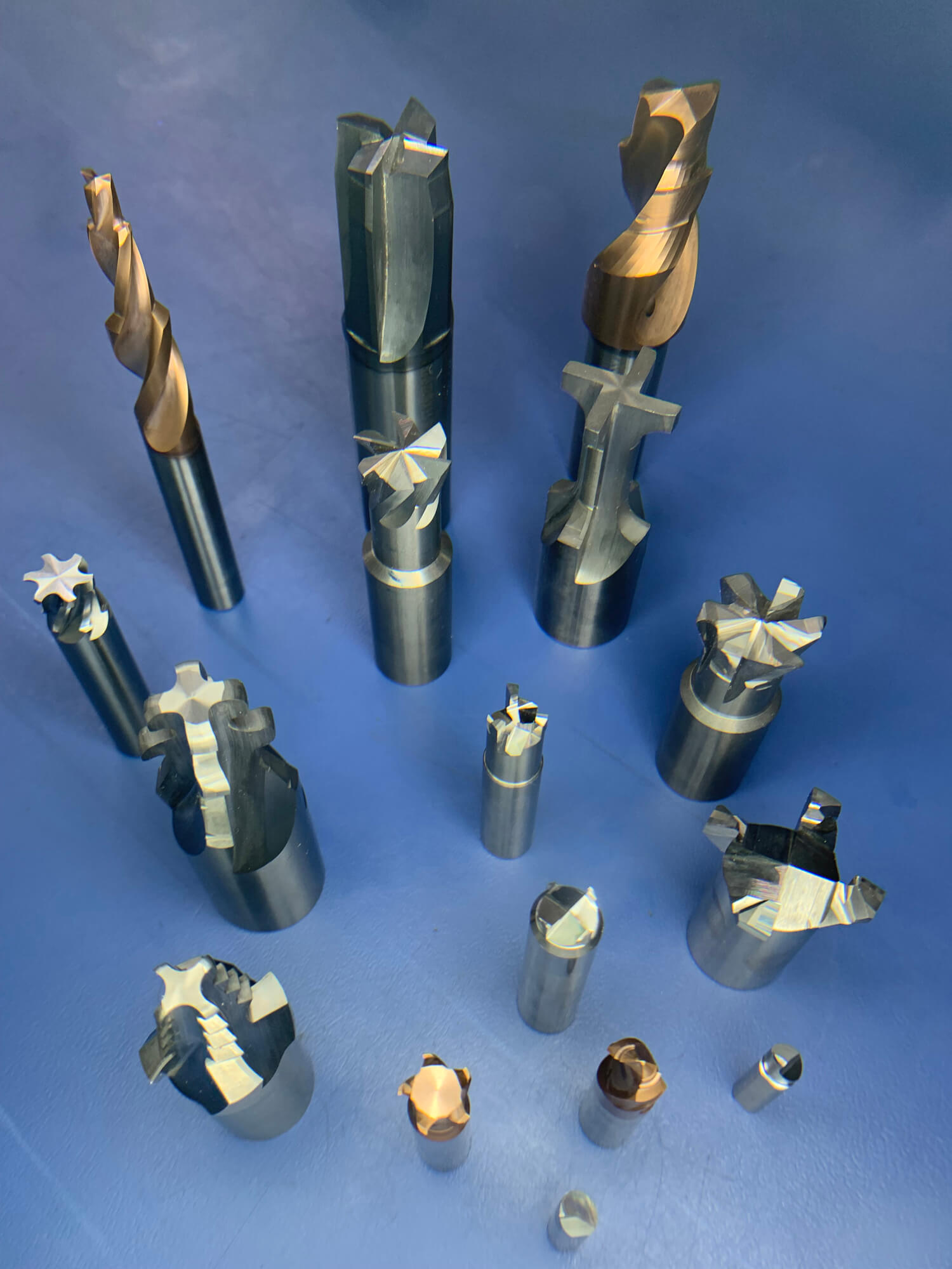

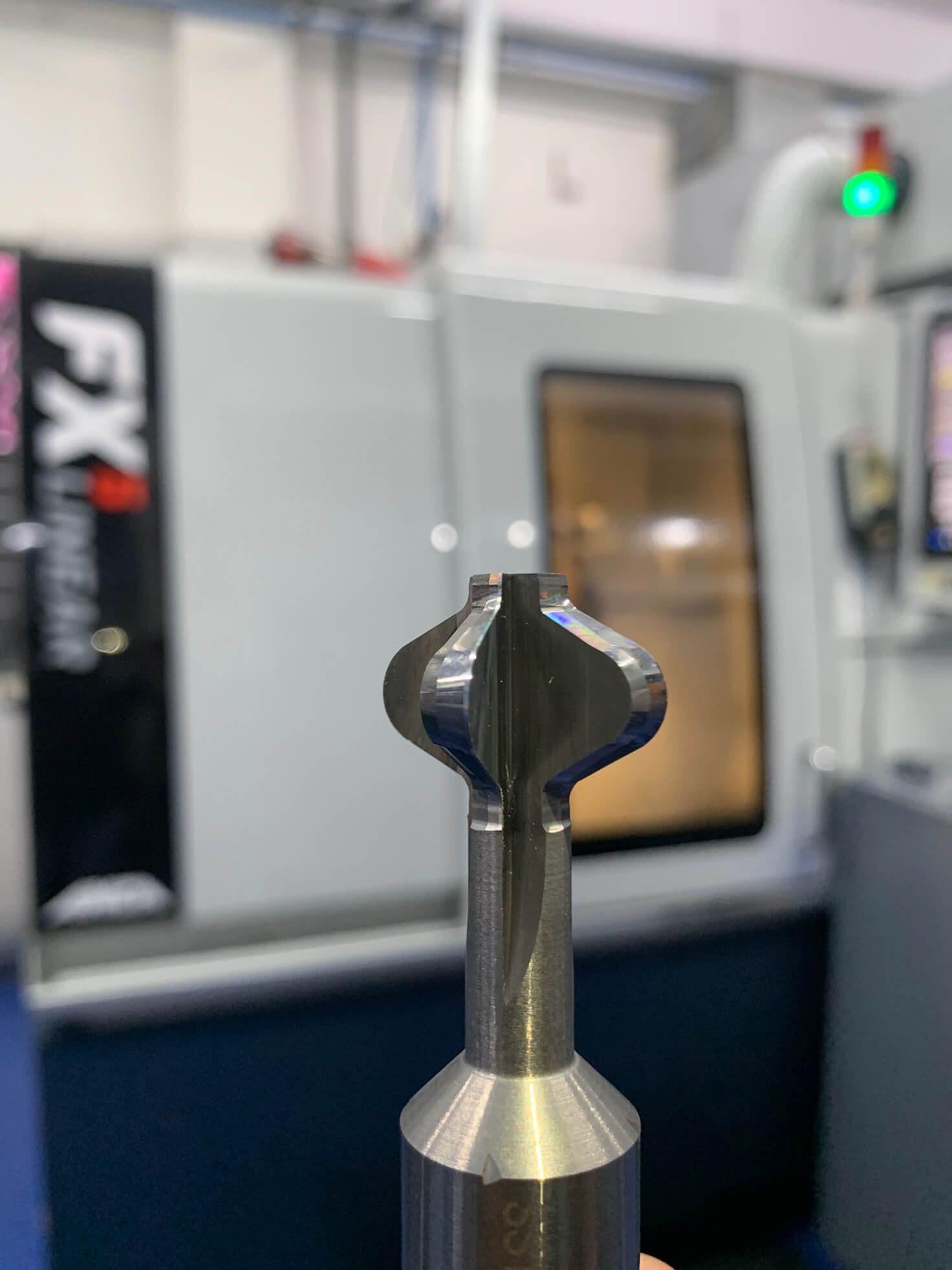

The company specializes in customized cutting tools such as drills with sizes ranging from Ø1 to Ø25 with the L/D ratio of Ø X 12; endmills with sizes ranging from 0.8mm to 25mm and 2flutes to 12flutes; and reamers and holemills, with sizes ranging from 1mm to 25mm, within the tolerance of 0.002 mm. Additionally, the company works with threading tools, boring tools, ID and OD grooving tools, pico bars, and angle grooving tools.
