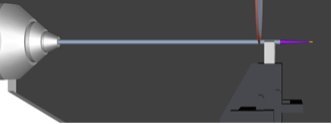

ANCA’s advanced grinding solutions offer seamless finished tool grinding in a single setup, including blank preparation. This setup features the P-axis Arobotech, which supports blanks at the grind point, enabling the efficient production of various tools with a surface finish below 0.2 Ra. This process significantly reduces cycle time while boosting productivity. The 3000 RPM headstock on the MX7 platform further enhances performance, allowing the tool to spin at optimal speeds for this application.
The MX7 platform, equipped with six wheel packs as recommended by ANCA’s application team, supports the grinding of various tool shapes in a single setup, eliminating the need for wheel changes. Depending on the tool’s shape and geometry, grinding can be performed at either the 3 or 12 o’clock position. Additionally, a specially designed hydraulic pump controls the clamping pressure based on diameter, including up/down pressure, to achieve faster cycle times.

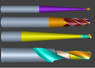

  • Capability to handle small to large diameter taper ballnose, corner radius, lollipop cutters, step tools, and more in a single setup – reducing cycle time and enhancing productivity and accuracy

  • Arobotech pads can support a range of diameters: 3 to 10mm, 10 to 16.5mm, and 16.5 to 25mm, all in a single setup
