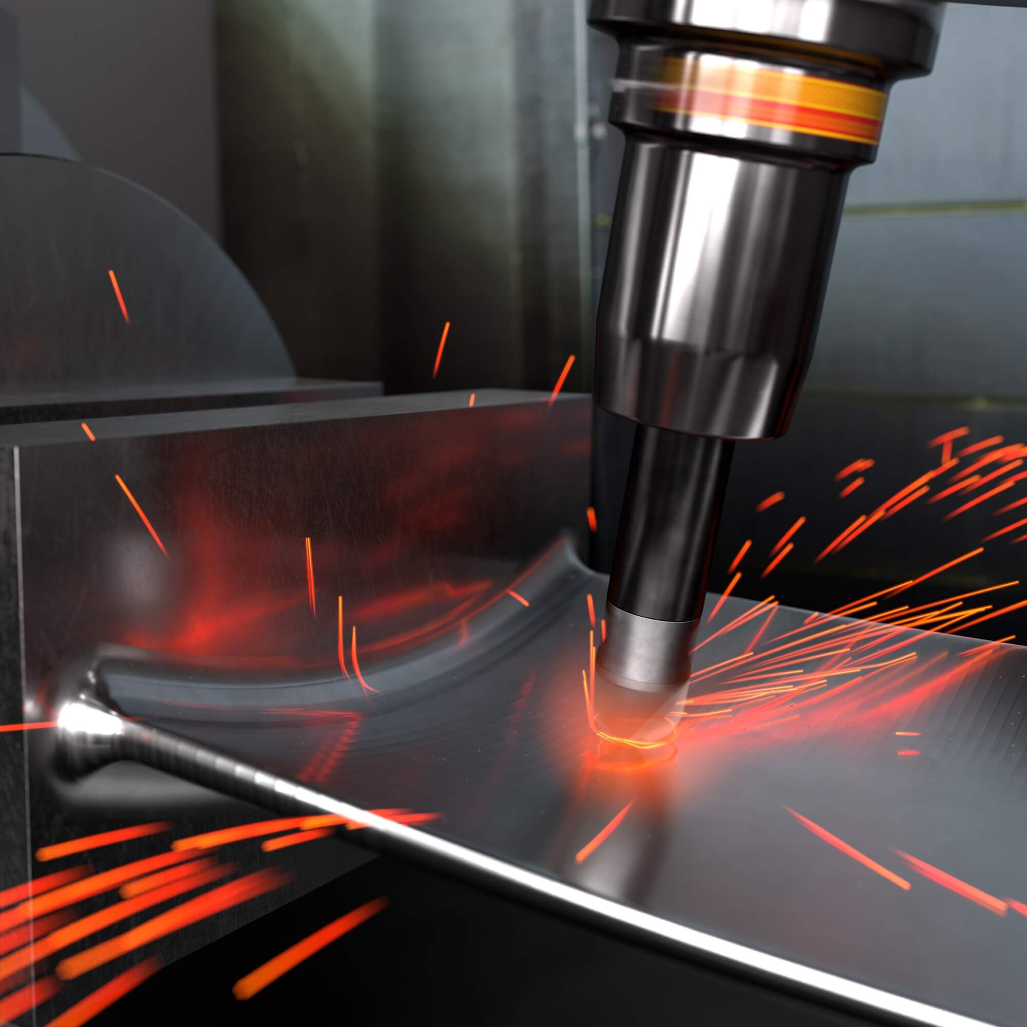

Solid ceramic end mill cutting
Solid ceramic end mills machine dry, use heat as part of their cutting mechanism, and operate at cutting speeds up to 20 times that of carbide tools—all while significantly extending tool life in hard alloys.
