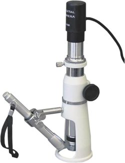

AmScope 100X Portable Shop Measuring Microscope + USB Camera
Order Now
This model is considered a high-quality, widefield shop microscope. It includes a digital camera that features advanced editing and processing abilities, along with measuring software.

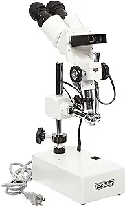

Fowler 53-640-280 Xtra Range Microscope
Order Now
This measurement microscope has a measurement range of 7.878 to 8.27″ and is accurate to +/ – 0.00006″. The gauge in this system has constant spring pressure for repeatability and includes FastFit measuring heads for rapid measurement.

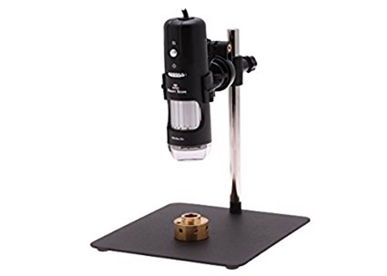

Aven 26700-209-PLR Mighty Scope Digital Handheld Microscope
Order Now
This digital inspection microscope features 10x to 200x magnification, a polarizing filter to reduce glare and enhance contrast, and a 1/4″ color CMOS image sensor. The setup includes an adjustable, metal tabletop pole stand and focus wheel for optimal resolution.
