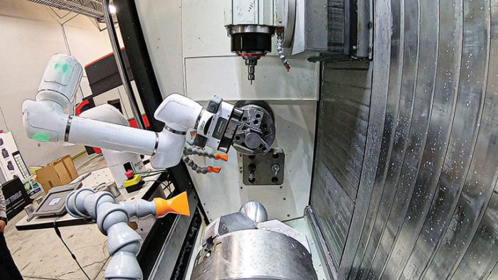

An OB7 cobot loads a raw blank into the main spindle of a nine-axis Quicktech S-32 ATM mill/turn center.

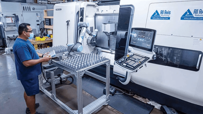

All Axis Machining of Dallas struggled to automate the operation of old machinery. When the company discovered the open integration architecture through the Universal Robots+ platform, it automated six operations with cobots.

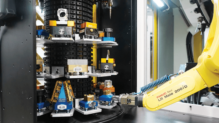

An LR Mate robot taking workholding from the carousel to be loaded into the RoboDrill.

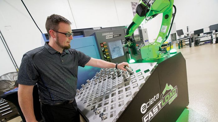

“The FastLOAD CX1000 and CR2000 systems are intended to be easy to use for first-time robot users,” he said. “Our touch screen interface for the CR2000 makes it very easy to run the robot with different part sizes. The operator only needs to enter the part parameters, and the system automatically adjusts the program to run the new parts. The robot grippers and part fixturing are flexible for a wide variety of part sizes so that many different parts can run on the same system.”
Changeovers on the CR2000 can be done in minutes, and the CX1000, CR2000 and DR2000 systems are designed so the robot can continue running while the operator is loading or unloading parts. “This enables the machines to work nonstop during breaks, lunches and even outside of shifts as long as there are enough inbound parts.”
Mounted on wheels, the CX1000 is easy to maneuver on the shop floor. It is also available with multiple quick-change fixturing cart options and uses FANUC’s CRX-10iA/L robot, “which has a very easy-to-use touch screen interface with drag-and-drop programming icons,” said Corning. “When your challenges are more complex or larger scale, our custom solutions can also be designed for high-mix, low-volume part runs by using technologies such as vision, end-of-arm tool changers, and flexible fixturing.”

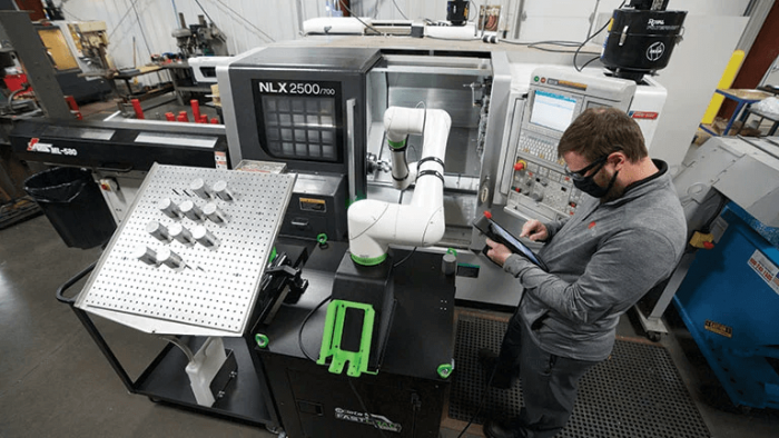

For job shops automating for the first time, a great starting point is the collaborative CX1000, Corning said. By freeing up workers from repetitive tasks, automation lets them “learn how to program or do maintenance on a robotic system. An operator who previously tended one machine can now manage robotic systems on multiple machines.”

For lower-volume parts, even as low as lot sizes of one, Methods offers the Plus-K and Plus-K 60 robotic rotary storage carousel systems. “We’re not making the robot part-specific; the robot is set up to bring generic workholding in and out of the machine, whether it’s a little vise or pallet. The robot is set up to grab a common feature on the front of the workholding.” Parts are loaded into a manual vise, and the robot is pre-programmed to act like a pallet loading system; no end-user programming is necessary. This system also enhances the standard tool offering on the RoboDrill, going from 21 to an optional 161 tools.

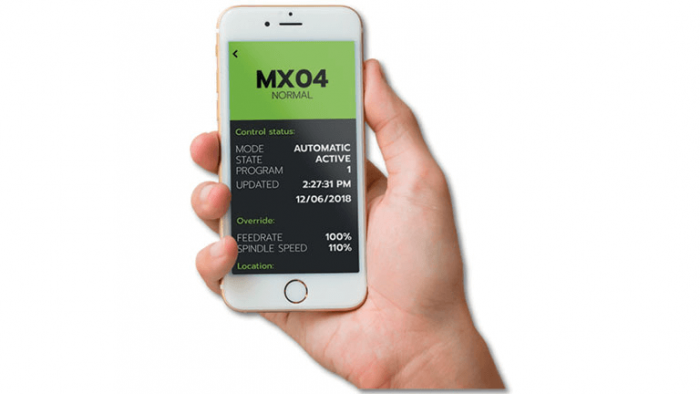

To help shops keep jobs on schedule and run more projects unattended, Mitsubishi Electric Automation Inc., Vernon Hills, Illinois offers its MTConnect-based Integrated Machine Analytics (IMA) for machine monitoring. The IMA Mobile app offers an easy-to-install entry into machine monitoring.
With IMA, shops “are able to better understand production, which helps with accurately scheduling jobs to take full advantage of their available machines and work hours, as well as more accurately bid for more jobs,” said Robert Brodecki, IMA mobile service product manager for Mitsubishi Electric Automation.
The only hardware required is Ethernet cabling and a hub/switch if connecting multiple machines, and it takes as little as 5-10 minutes a machine to set up, he explained. “With the low cost point, users can see ROI within days, especially if they’re running unattended or lights-out production and have lost production time due to a machine faulting out and not finding out until later on. With IMA Mobile’s notifications, you’ll know within 10 to 15 seconds if a machine has stopped cutting, no matter where you are.”
Machine monitoring improves throughput significantly, he added. “Just looking at execution state, a lot of job shops usually have machines running jobs between 25 and 40 percent of their available time. Through simple monitoring of current status via IMA Mobile, they can quickly move that to 50 percent or more by being able to immediately attend to any machine that has stopped production for any reason. This is actual data straight off the machine, too; it removes the guessing game of how long the machine was cutting, in idle, or off.” Available machine hours are expanded by running more shifts with fewer workers—or unattended—without lost production because of an unexpected stoppage.
With IMA Mobile, operators can move to value-added tasks “knowing that the app will notify them when the job is finished or interrupted by something that needs attention.”
