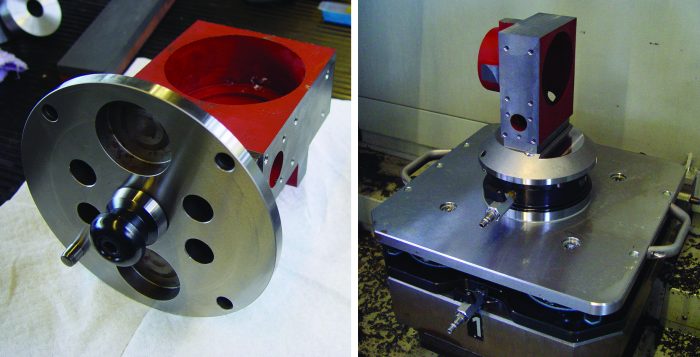

Quick, accurate and stable gripping can be done easily, regardless of the workholding form, when the fixture workpiece is transferred in and out of the machine tool with something like the Unilock zero-point clamping system from BIG KAISER. In fact, systems like this provide the best solution for two of manufacturing’s toughest setup problems: repeatability of location from one fixture or workpiece blank to another, and transfer of work from one machine tool to another (more on that in a minute). These kinds of systems aren’t new, but they’ve grown alongside advancing approaches to machining and can now adapt to workpieces of virtually any shape or size.
With this kind of system in place, a workpiece reference location need only be established once. Alignments for the chuck are established from its center line, and that data can be captured electronically and kept in the machine’s CNC program. Work can then be moved from turning center to a grinder or from a milling center to a CMM without having to re-establish the reference point. You can run any fixture at any time.
