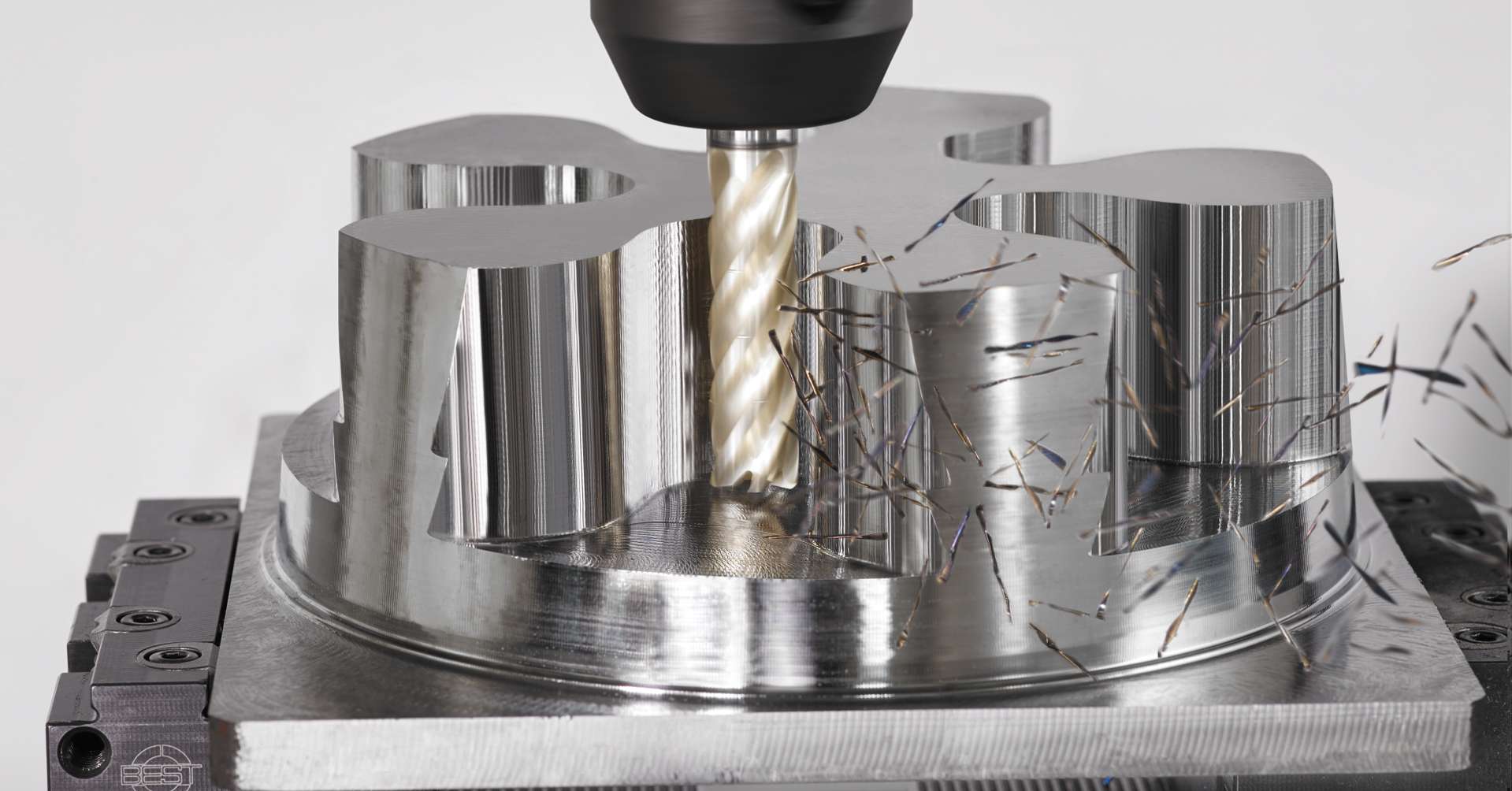

The first cut in this video is a full slotting application—that is, 100 percent of the tool diameter is engaged. Each subsequent cut reduces the tool’s engagement, yet the sound generated by the cutting action is virtually indistinguishable. That’s because cutting parameters have been set with the goal of maintaining the same average chip thickness regardless of radial engagement.
