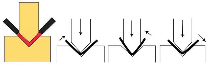

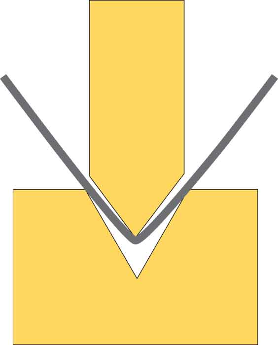

Figure 1 Bottoming and coining aren’t the same, though both stamp the inside bend radius into the material. In coining (left), the punch penetrates to less than the material thickness. In bottoming (right), you have clearance between the punch and die angle. The punch applies force until the material is forced against the die angle, which sets your bend angle.

As odd as it might seem, many engineers, designers, and even operators still do not understand the differences among air forming, bottom bending, and coining, and how each forms the inside bend radius (see Figures 1 and 2).

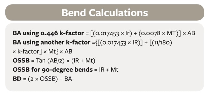

In bottoming and coining, the tooling stamps the inside bend radius into the part, so the bend allowance and bend deduction calculations are based on the nose radius of the punch. In air forming, the inside bend radius is floated as a percentage of the die width—roughly 16% for cold-rolled steel, 20% for stainless (hence the name “20% rule”). If you base your bend calculations on the wrong processes, your parts won’t be correct.

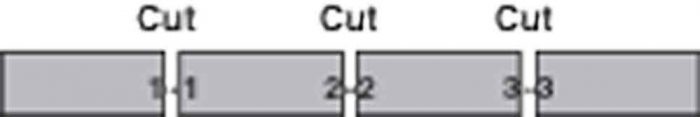

Second, you need to mark each cut so that the tools can be reassembled in the same way they were originally cut. For example, if you cut a long tool into two segments, you can label “1” near the cut line of each piece. When you reassemble them to bend a large part, you just match the “1” on one segment to the “1” on the other segment (see Figure 3). This also ensures that your tools face the same way in the press brake and avoids mismatch and alignment issues between punches and dies.

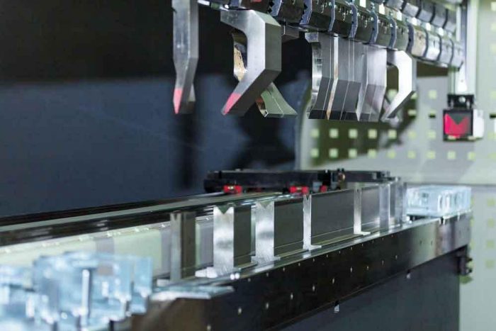

Precision-ground planer are tools in a planer profile, but ground toward the center to a very tight tolerance. Like true precision-ground press brake tooling, they are reversible, great for staging setups, and fit in both modern and older press brakes. Because of the manufacturing accuracy—typical tolerances are from within 0.0004 to 0.0008-in.—they can be readily mixed and matched, and tool direction is not an issue. They’re manufactured in sections or full lengths of approximately 3 ft.
True precision-ground press brake tooling, like precision-ground planer, is ground toward center and manufactured to the same very tight tolerances. Both punch and die profiles of precision-ground tools are different from those of planer tooling and are substantially more versatile (see Figure 4).
You need precision-ground tools to get the most versatility from a modern press brake. Again, that’s because they’re ground toward a center point instead of from an X-Y coordinate. This allows these tools to be mixed and matched and face opposite directions in a single holder. Depending on the brand and style of tooling, some will even mate perfectly with other brands of tooling.

Figure 3 Labeling the cut lines on planer tools helps avoid mismatch and alignment issues when the tools are reassembled.
