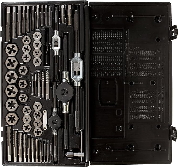

Hanson-Tap Plus Die 25Pc Set
Order Now
The Hanson tool and die sets are known for their ergonomic handles that allow more control and comfort when threading. The taps and dies in this set are self-aligning to ensure a straight tread every time.

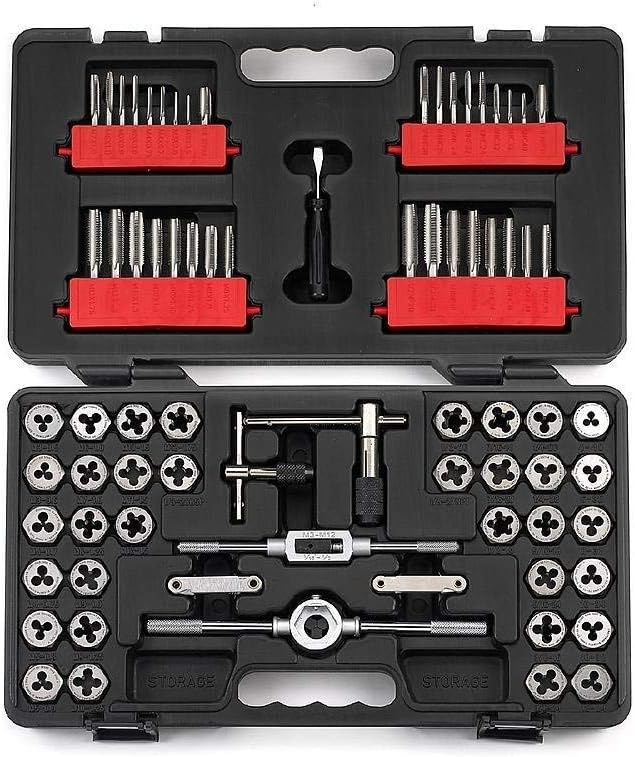

Vermont American 58-Piece Professional Tap and Die Set
Order Now
Each high carbon steel tap and die in this set achieve maximum corrosion resistance with precision cutting performance. All the taps in this set are plug style and have the recommended drill size laser marked on the side for convenience and practicality.

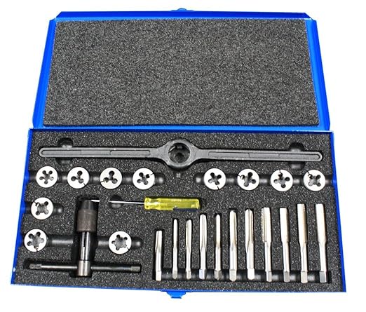

Morse Cutting Tools Fractional Tap and Die Sets
Order Now
The Morse tap and die set comes in a protective metal casing and contains 1/4 to 1/2 NC & NF HSS plug taps, 1/4 to 1/2 NC & NF carbon steel 1″ OD dies, a #3 die stock, a #4 “T” handle tap wrench and a screwdriver.
Greenfield Threading Tap, Drill and Round Die Set
Order Now
The Greenfield tap and die set features HSS taps and carbon steel dies. The set includes round adjustable dies and plug hand taps. These tools measure in imperial units.

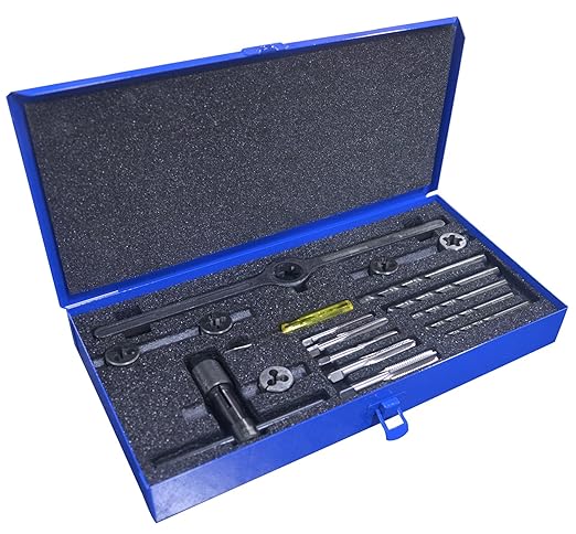

Craftsman Tap and Die Set
Order Now
This Craftsman combination carbon steel set will help you work with damaged nuts, bolts, and threads. Taps and dies made of hardened, precision-ground, and polished carbon steel surfaces to make chip removal easy. There is also a rust-resistant satin finish for smooth cuts with less friction.

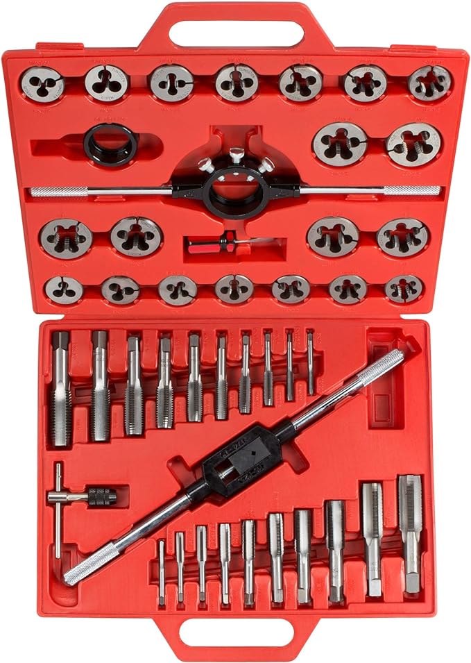

Tekton Tap and Die Set
Order Now
This tap and die set is made of tungsten alloy high speed steel and is desired for its ability to start a thread easily, whether that be cutting new material or chasing lightly damaged threads. With proper technique and the right lubricant, these taps and dies will cut mild carbon and alloy steel, stainless steel, cast iron, aluminum, brass, and bronze.
