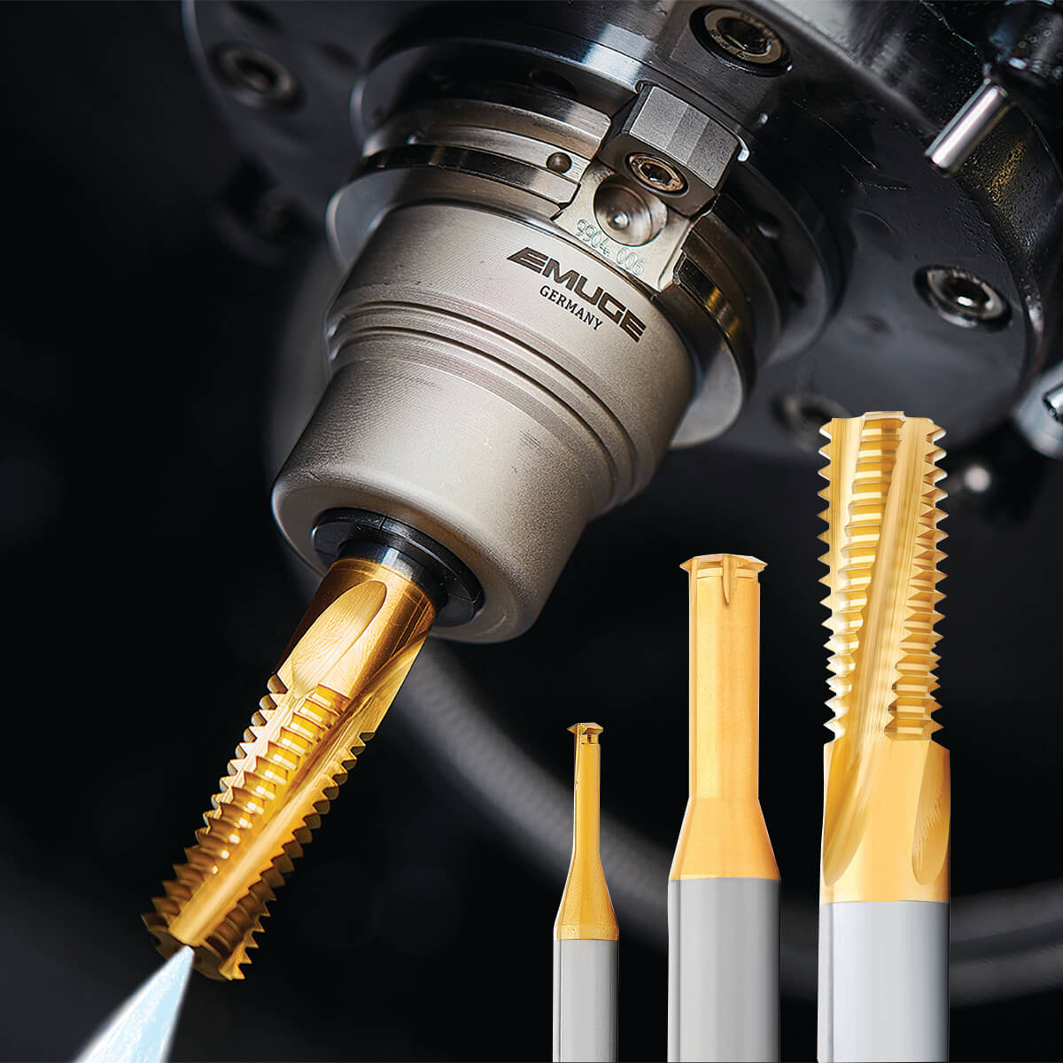

Holemaking is said to be the most common of all machining operations. Putting threads in those holes comes in a close second. For many decades, cut taps and then form taps were the only tools available for threading operations, but CNC programmers, machinists, and manufacturing engineers now have a more flexible and accurate way to generate internal threads. It’s called thread milling, a rotary machining operation that uses a milling cutter with a single V-shaped tooth or a series of such teeth to cut thread forms. Needless to say, EMUGE-FRANKEN USA thread mill product manager Marlon Blandon has plenty of advice about this underutilized and often misunderstood thread-making alternative.

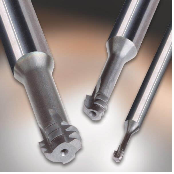

Q: What about single flute vs. multi-flute or full profile thread mills. From a productivity perspective, isn’t the latter of these the clear choice?
A: It really comes down to economy and versatility. Because you can cut any pitch thread with a single-flute thread mill, shops don’t have to stock as many tools. They can also just leave that tool set up in the magazine and call it up whenever they need to make some threads. That said, a multi-flute tool is much faster. Instead of making a couple of dozen passes with a single flute tool, one with the complete thread profile can produce any thread in two passes or less, geometry and material permitting.

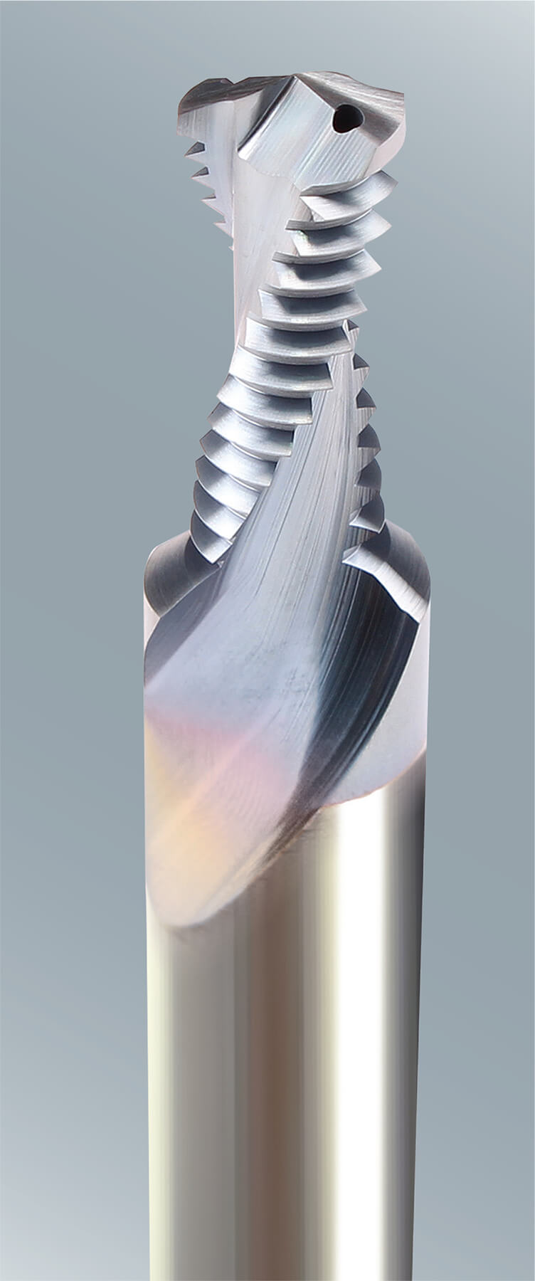

Emuge ZGF-S-Cut Thread Mills have multiple teeth, the first acting as a rougher and the next two teeth performing finishing. By dividing functions into three cutting edges, speeds and feeds can be increased, and threads can be produced in a single pass. A 10° left-hand helical flute form and chamfer geometry combine to optimize chip evacuation in the forward direction and add strength to the cutting teeth for enhanced tool life and process security. And for increased tool strength, Emuge ZGF-S-Cut Thread Mills have multiple flutes.
Q: What do you mean by that last comment, geometry and material permitting?
A: Two things, actually. The first is that most full milling section thread mills—ours included—are designed to cut thread depths to twice the tool diameter. Given the high cutting forces encountered with thread milling, that’s about all you can expect in terms of threading length for a full profile tool. In addition, materials such as Inconel and hardened steels might require an extra spring pass or two to compensate for tool deflection. On the other hand, single-flute tools support much deeper threads, although with a longer cycle time.

A: There are several. With thread mills, we can combine drilling and even chamfering operations in a single tool, as with our BGF Thriller. And I already mentioned a thread mill’s greater versatility, but since you can easily offset the tool for wear and deflection, you also have better size control. It’s much easier to get to the bottom of a blind hole with a thread mill, tool life is generally better, and like I said earlier, tough or hard materials are not a problem like they are when you tap. In fact, I spoke to a customer the other day who accidentally heat-treated some parts to 65 Rc before cutting the threads. Without a thread mill, those parts would have been scrap. Add to that some of the new tool coatings and geometries that we’ve introduced recently and you’ll find that, given the right toolholder and proper CNC programming techniques, thread milling is often the preferred choice for all but very high production quantities.
