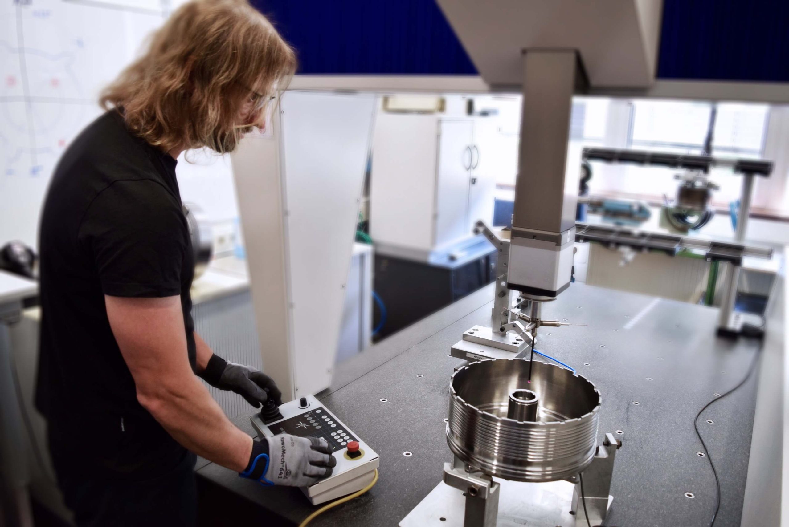

Complexity is something of a hobbyhorse at Bharat Forge Daun: The company, based in the heart of the Eifel region, around 50 kilometers from Koblenz, produces rotationally symmetrical series components as a contract manufacture as well as tools and moulds, which are then used by the forging experts at Bharat Forge CDP and Bharat Forge Aluminiumtechnik, for example. This means that challenges like difficult surfaces and positional arrangements are common. “Extreme accuracy requirements in the micrometre range are always part of our work,” says Christoph Steffens, Head of Mechanical Engineering at Bharat Forge Daun, summarizing the initial situation. “In this context, we monitor the processes very comprehensively, carry out many measurements and even accompany the component development on request – so that the production of the component runs efficiently. We offer this expertise on the market for sectors such as the automotive industry, general mechanical engineering and the production of agricultural machinery.”

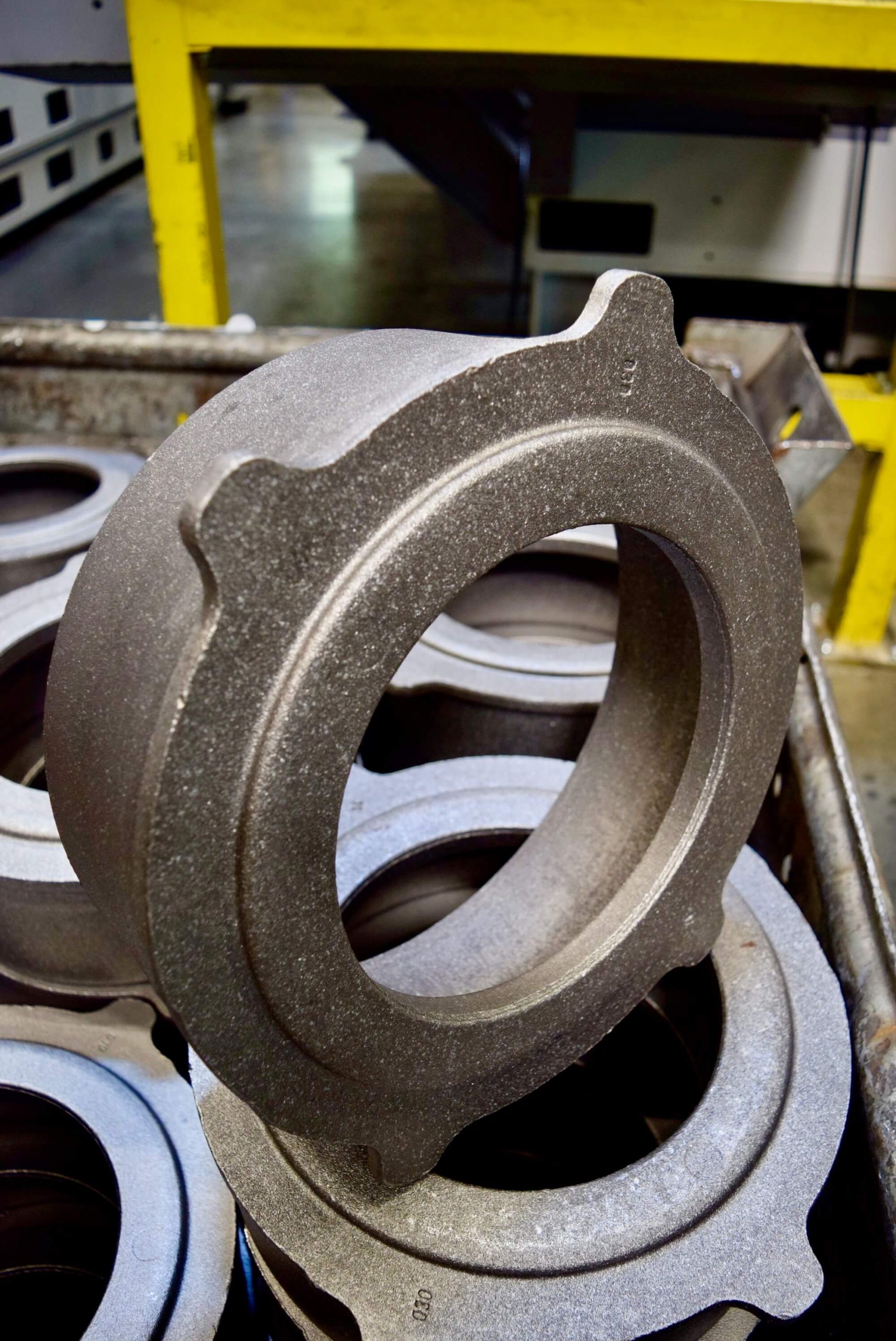

The blank is a forged steel component
A stator housing used in the hybrid drive of a large German automotive company shows what this means in concrete terms. Even at first glance, it is clear that its pot-like shape and various geometric details are sophisticated. What’s more, the blank is a forged steel component – a rarity in this field of application. Its material properties are an additional challenge for the south-west German machining experts. In addition, the client has continuously increased the required quantities over the years (and will continue to do so). So how do you combine accuracy, efficiency and process reliability in this environment? Bharat Forge Daun’s answer has a lot to do with EMAG’s mechanical engineering components, as the specialists have been relying on EMAG lathes for some time.

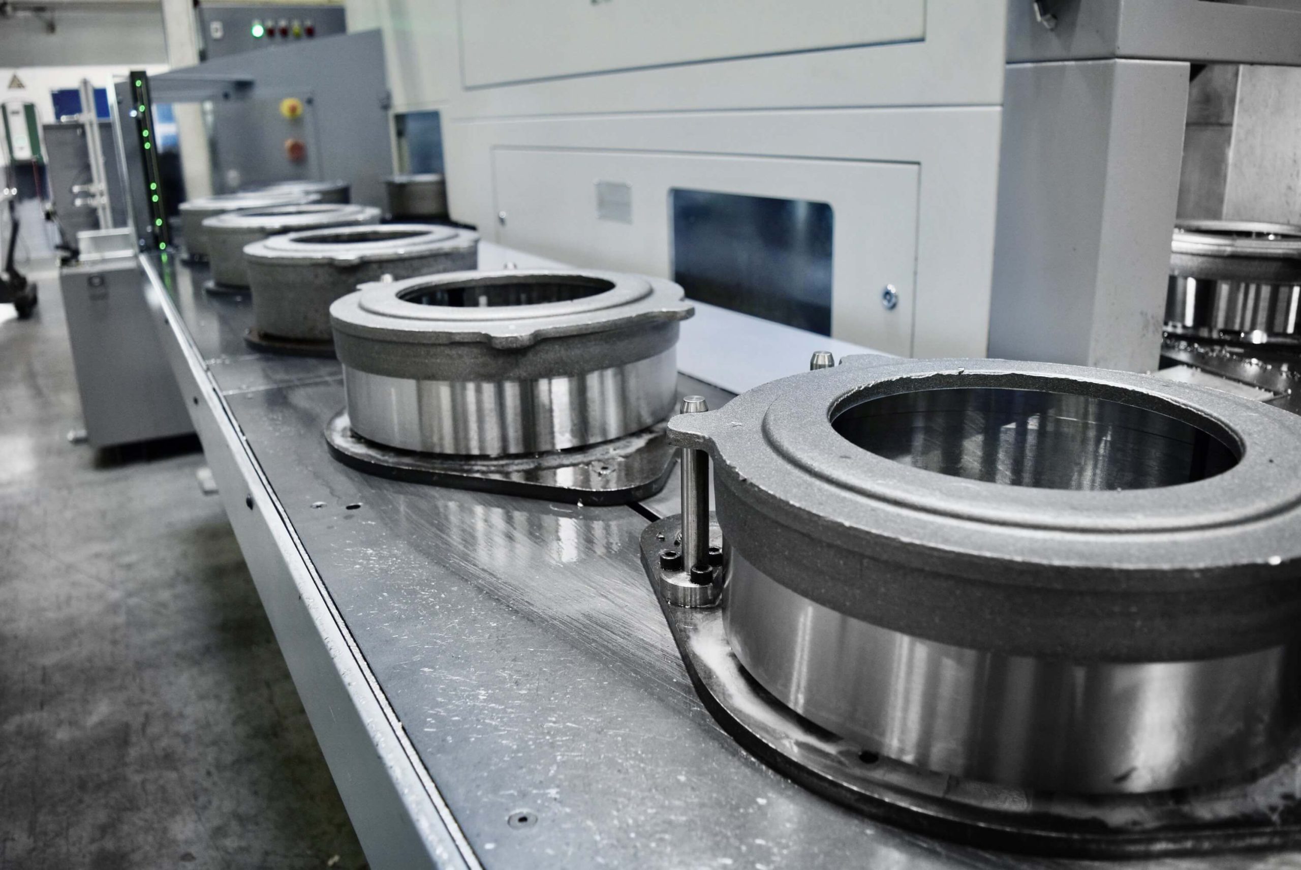

The circulation belt of the VL machines also serves as a parts store
Vertical design with decisive advantagesĀ
The vertical design of these solutions played an important role in the investment decision. The horizontal machine from another manufacturer had caused some difficulties in the past. For example, annoying chip clusters regularly formed, which had to be removed manually two to three times per shift. “It was therefore obvious to us that we should carry out these processes in machines with a vertical design, because their unhindered chip flow prevents many disruptions. Our objective was to achieve maximum process reliability,” emphasizes Steffens. The decision in favor of EMAG was also based on existing know-how: The machine manufacturers used examples from other customers to show how stator machining is carried out in their machines – with low non-productive times and high-precision handling processes. Integrated automation including a pick-up spindle and lateral conveyor belt ensures fast processes, while the stable base body made of the polymer concrete MineralitĀ® stands for quality in turning and milling processes.

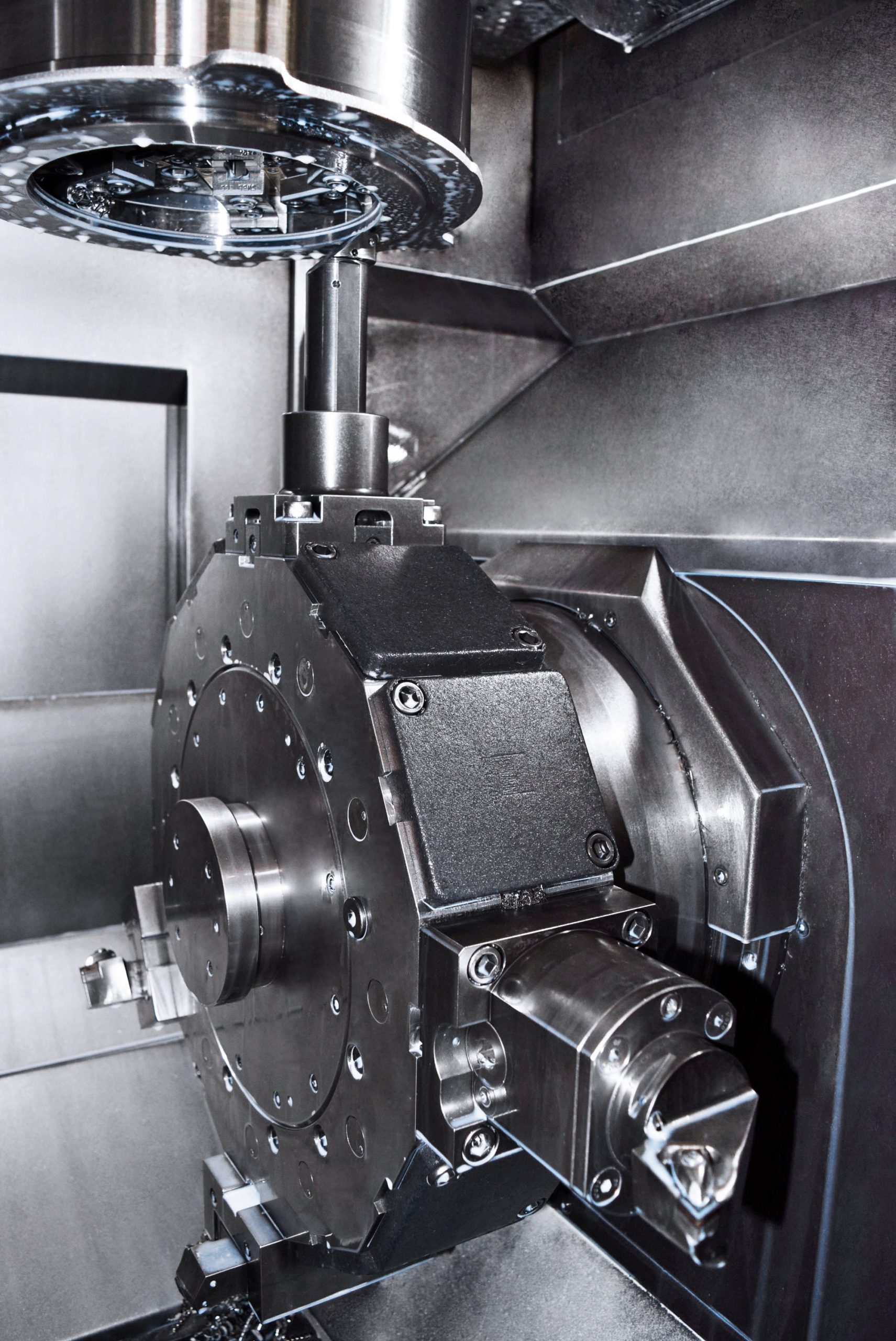

Work area of the VL 8 at Bharat Forge Daun

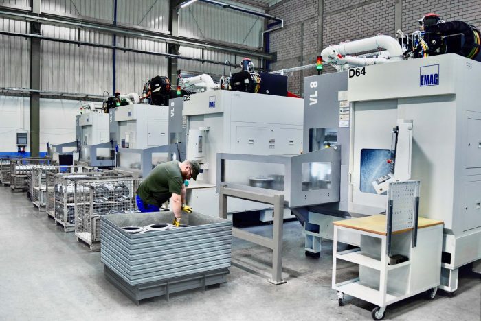

Four VL 8s from EMAG carry out the rough-machining processes on the component
