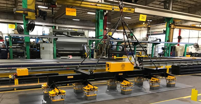

A magnetic lifter removes a cut deck plate from the plasma cutting table.

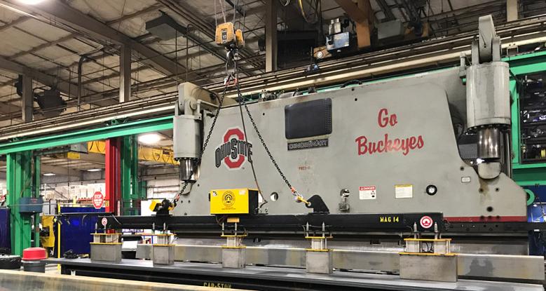

Employees used a combination of vacuum lifters and manual techniques to move sheets and plates through cutting and bending. This included a 100-ft. plasma table and a 600-ton press brake used to form the U-shaped ribs. Vacuum lifters work well in a variety of manufacturing environments, of course, particularly those that involve nonmagnetic material. But Mettler’s vacuum hoists needed to lift heavy loads. It took more than 30 seconds for suction pressure to build, and the suction pads had to be replaced frequently.
So in late 2017 the company replaced the vacuum-based system with magnetic lifters from Industrial Magnetics. The magnets help lift long steel rib parts to and from a roller ball table in front of the press brake tooling. After the first flange is formed, workers pull the piece out, reset the backgauge, and form the second flange. On the first part of a new batch, brake operators use a test jig to ensure the bend angles are correct.
The external bend angles are slightly less than 90 degrees, giving the ribs an ever-so-subtle trapezoidal shape after they’re welded to the scale’s deck plate. After inspection, the magnetic hoist grasps the ribs by the bottom of the channel and stacks them on wood blocks, where they’re moved to welding.
The roller ball table is made of magnetic material, which demonstrates a key benefit of magnetic lifting: the circuitry can be designed to match the thickness of the load. In the ribs application, the load is comprised of long, 3/16- to ¼-in.-thick material. In this case, the magnetic circuit was designed to penetrate deep enough to hold and lift the 3/16-in.-thick material used to make the rib, but not so deep as to pull against the roller ball table itself.
A magnetic hoist places a blank that will be formed into a U-shaped stiffener on the press brake.
“You can design the [magnetic] circuit with different shapes, sizes, grades, and arrangements of magnetic material to achieve the required magnetic circuit performance for an application,” said Collins McGeorge, director of sales at Industrial Magnetics. “For example, you can configure a circuit that offers a very strong surface hold, and yet is not a deep-reaching circuit. This allows you to pick up only the top sheet from a stack of metal, even if it has been treated with a sticky, oily coating.
“This was the case in one of Mettler’s applications,” McGeorge continued, “and because the magnetic circuitry [was designed] to reach only so deep, the magnet could eliminate the need for an air knife and other more manual separation methods.”
The ability to integrate magnetic tooling into a lift-assist is another benefit that’s put into play at the plasma table, where a separate magnet lifts steel plates onto the table and then removes cut pieces from the nest.
“The magnet is able to pick up an individual blank sheet from the stack and load the plasma,” said Brandon Koch, manufacturing engineer at Mettler Toledo, who has been highly involved in the Columbus plant’s recent improvement efforts. “Then, after cutting is complete, it’s able to simultaneously pick up the separate nested parts and release them individually in different locations. Overall, we’ve been able to reduce the number of hoists at the plasma by 35 percent.”
Koch added that the number of gripper tool changes (compared to previous lifting methods) at the plasma table fell by 25 percent. And the number of hoists overall, for both the brake and plasma system, has fallen by about 24 percent.
By early 2018 lifting efficiency was critical because by that time the operation had transferred all of its previously sheared work to the plasma cutting table. Managers decided to remove the shearing process altogether, which freed up valuable floor space for the company’s next improvement: robotic welding.

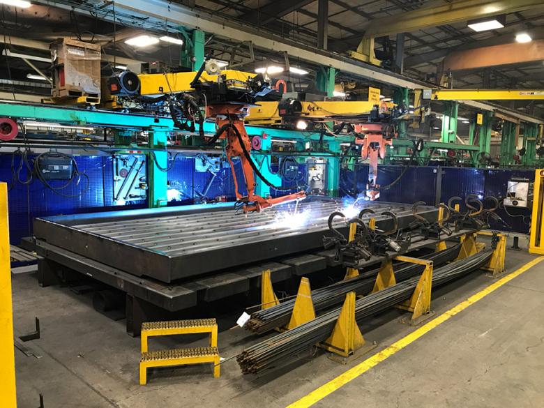

Mettler Toledo is no stranger to welding robots. Robots mounted overhead perform the linear welds that connect the ribs to the scale decking. Each scale module has about seven ribs, which adds up to a lot of welding. The product mix is too large and variable for a hard fixture, of course, so operators lay out the ribs onto the deck, tack them, fixture them, then run the robot.

Mettler Toledo is no stranger to robotic welding. For years the company has robotically welded stiffeners to scale deck plates.

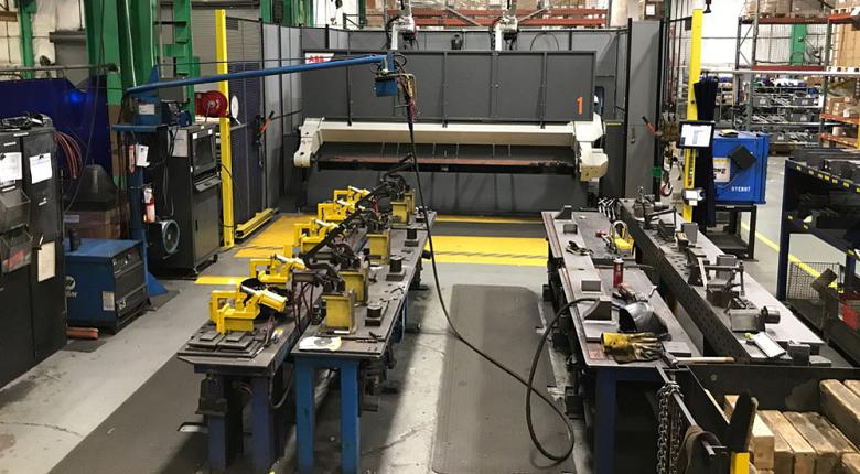

Of course, welding and robot programming technology has evolved. First, engineers found that pulse welding (GMAW-P) could reduce problems with workpiece distortion. Combine this with a large copper heat sink on the fixturing table, and engineers found that distortion could be virtually eliminated. Working with Wolf Robotics, Mettler installed a robot welding cell that not only controls distortion of those end plates, but also takes weld programming and simulation offline.
Now operators receive a blank end plate and place it in one of four adjustable jigs, which together account for all the base plate designs for all the scale platforms the plant produces. They then arrange the smaller components and tack them in place, at which point they fixture the assembly onto the table. The robot touches off the wire tip to verify the part position, then commences welding.
The robot takes between 15 and 18 minutes to complete the welds; again, these are big parts, some as long as 11 ft. 10 in. long. At this production rate, an operator usually can finish tacking the next job before the robot finishes welding.
Most significant, the end plates themselves rarely need straightening. “Operators bring the plate to the straightening press only once in a blue moon now,” Koch said, adding that “they’re now able to get far more than 90 percent of the products off the cell without having to straighten them.”
The previous manual operation produced just eight to 10 end plates over an eight-hour shift. “With this new robotic cell we were able to double production,” Koch said. “So we can now do 16 to 20 end plates per shift.”

Jigs are set adjacent to the end plate welding cell, where welders tack components in place before loading them onto the fixture table.
