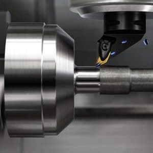

PrimeTurning was introduced by Sandvik Coromant, Fair Lawn, N.J., as a totally different way of performing turning more efficiently and productively. In PrimeTurning, the tool enters the component at the chuck and removes material as it travels toward the end of the component, bringing with it its own set of interesting programming challenges.
One is the application of small or shallow entering angles and higher lead angles that create thinner, wider, curved chips that spread the load and heat away from the nose radius. The result, said the company, is both increased cutting data and extended tool life due to increased feed rates. In addition, because cutting is performed in the direction moving away from the shoulder, there is no danger of chip jamming, which can be a problem in conventional turning. Entering angles of 25–30º are used to maintain chip control and tolerances.
Programming is widely recognized as a key to unlocking the potential of PrimeTurning’s processing capabilities and is available now. For example, CNC Software Inc., Tolland, Conn., developer of Mastercam CAD/CAM software, worked with Sandvik in developing programming for PrimeTurning using the principles of its Dynamic Motion engine to produce toolpaths that can drive the tool’s motion. Industries likely to benefit the most, according to Sandvik, are aerospace and automotive manufacturers, where it is necessary to perform external turning operations in large production runs or where multiple setups and tool changes are required.
Toolpath programming is a key to unlocking the potential of PrimeTurning’s processing capabilities and is readily available now. (Provided by Sandvik Coromant)

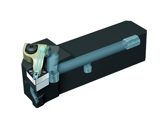

For machining stainless steels and superalloys such as Inconel or titanium, Walter USA LLC, Waukesha, Wis., has introduced new chipbreaker geometries with precision-guided coolant jets, according to Sarang Garud, product manager. These geometries work in conjunction with through-coolant holders to target the coolant jet directly at the cutting zone in a precise manner. This precision-guided cooling is achieved by the top clamp of the toolholder, which also acts as a coolant nozzle. The coolant exits the coolant nozzle (top clamp) onto the rake face of the insert with high pressure.
“The new ISO turning insert geometries are shaped such that the features on the rake face of the insert act as coolant channels, which further guide the high-pressure coolant to target the cutting zone. This leads to a superior cooling of the insert edge, increasing tool life up to 100 percent or more,” said Garud. Additionally, coolant is also delivered from the clearance face for additional cooling of the cutting edge.
“The clearance face blast of coolant with high pressure also acts as an extremely efficient method of chip evacuation,” Garud said. “For maximum impact it is best to use Walter’s through-coolant holders; however, a substantial benefit can also be realized by using just the precision-guided geometry inserts, which are ISO standard.”
Most of Walter’s turning geometries are less than four years old. “Some of the latest geometries, such as MS3 for medium machining and RM5 for roughing of superalloys as well as stainless steels, feature the precision-guided coolant geometry,” he said.
Walter’s precision through-coolant holders provide high-pressure coolant for both rake and clearance face cooling and chip evacuation. (Provided by Walter USA)

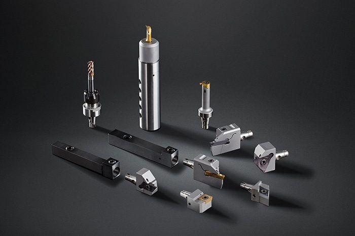

Horn has entered into a partnership with another German company, W&F Werkzeugtechnik, a supplier of quick-change toolholders, to provide a complete solution for Swiss-style machines, covering everything from the spindle to the tool cutting edge. Horn’s cutting tools will be utilized in the pockets of the quick-change tooling heads on a single stick tool or a round shank.
Horn’s quick-clamping system for Swiss-style lathes is a complete solution, covering everything from the spindle to the tool cutting edge. (Provided by Horn USA)
The quick-change tools with W&F’s solid, one-piece stick tool design can be mounted into the machine or the gang plate of a Swiss-style machine. The heads are interchangeable with ISO-style turning inserts, a specific Horn insert or a triangular lay down threading type tool.
“It’s a rigid system, with coolant-through capability and it answers a need with today’s skills gap of having to teach operators how to change a tool correctly, especially in a Swiss machine,” said Sedesky. “It’s as simple as removing one screw, removing the head, indexing, tightening down and locking in place. Operators no longer need to bring the tool down to a touch-off position once the initial setup for that tool position has been completed.”

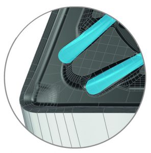

Jet guiding geometry using a coolant channel targets the coolant directly at the cutting zone. (Provided by Walter USA)
