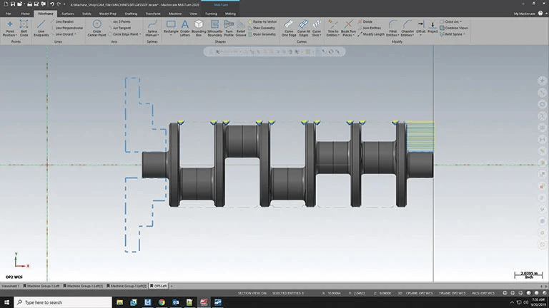

A crankshaft for GK Machine’s GK H9 Tree Digger, programmed in Mastercam.
“We ran it at an sfm of 800 or 381 rpm and a chip load of 0.030″ [0.762 mm] per revolution with a depth of cut of 0.090″ [2.286 mm],” Houdyshell continued. “When finishing we ran it at 477 rpm at 0.030″ depth of cut and 0.015 ipm for the finish pass.” It now takes GK Machine just over one hour to complete the entire process—from preparation to finishing.
