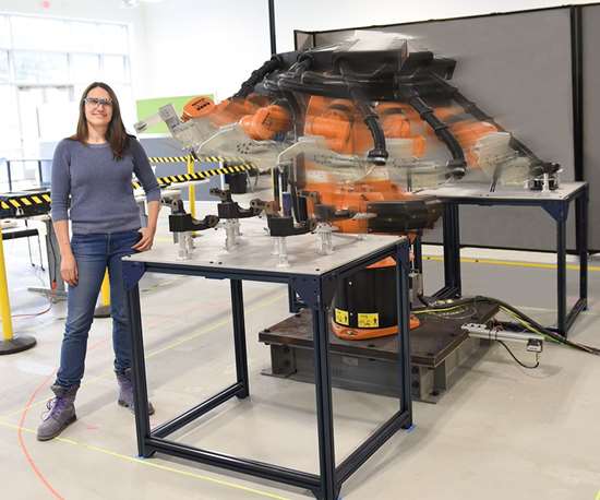

No employees were harmed in the making of this photo. New technology using vision and AI can make any robot collaborative, its developers say, eliminating the need for guarding around automation. Relevant robot safety standards already address it. Veo Robotics’ Gwenn Ellerby stood close to the robot for this photo.
Dr. Sobalvarro is one of the cofounders of Cambridge, Massachusetts-based Veo Robotics, a company that has been working to develop a collaborative robot or “cobot” system based not on force and speed limitation—typical of cobots in use today—but instead on speed and separation monitoring achieved reliably using AI and advanced vision technology. Veo’s “Freemove” system can make any robot collaborative, he says, providing the robot with the ability to operate close to a person without threat to that person’s safety. In fact, during my visit to Veo’s headquarters, I saw demonstrations involving standard industrial robots from brands I recognize. Existing robot safety standards, including ISO 10218, ISO/TS R1506 and IEC 61508, all recognize this system’s approach to realizing operator safety, and Veo expects to have a commercial version of Freemove for production facilities on the market by the end of the year.

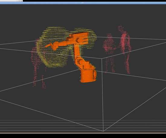

The Freemove system uses machine vision to locate objects it recognizes, such as the robot, as well as occlusions that might represent the presence of a human. The system responds to the latter by slowing or stopping the robot to avoid potential harm.
Observing Occlusions
Dr. Sobalvarro explains how the system relying on this sensing technology works. Veo’s collaborative automation employs four or more vision cameras mounted high above the robot that have overlapping view fields. Each camera repeatedly sends infrared flashes to map every object in its field of view by means of the IR reflection. The resolution of the cameras developed by Veo is fine enough to distinguish a human finger at 10 meters. Thirty times per second, the collaborative system maps the vicinity of the robot by combining all the cameras’ data. Within this combined field, he says, the system is looking for occlusions.
That is, the system is looking for every volume of space that it cannot see because something is blocking its view. Any occlusion a little larger than a loaf of bread, or bigger, is assumed to be able to contain a human (meaningpotentially a very small human), and analysis of these occlusions is used to detect safety concerns. Phase transitions logged through the 30 samples per second track the progress of any occlusion. If the course of movement of an occlusion can provide clearance for a human to have entered the work zone and come within range of the robot, then the space is considered “infected” by the occlusion and the system responds accordingly. From this occlusion’s current position, the Freemove software then compares future states based on possible moves of the robot and possible moves of the suspected human at a presumed (fast) speed of 2 meters per second. If the event horizons of these two actors lead to any possible state in which the human comes in contact with the robot, then the robot is slowed down or brought to a stop.
