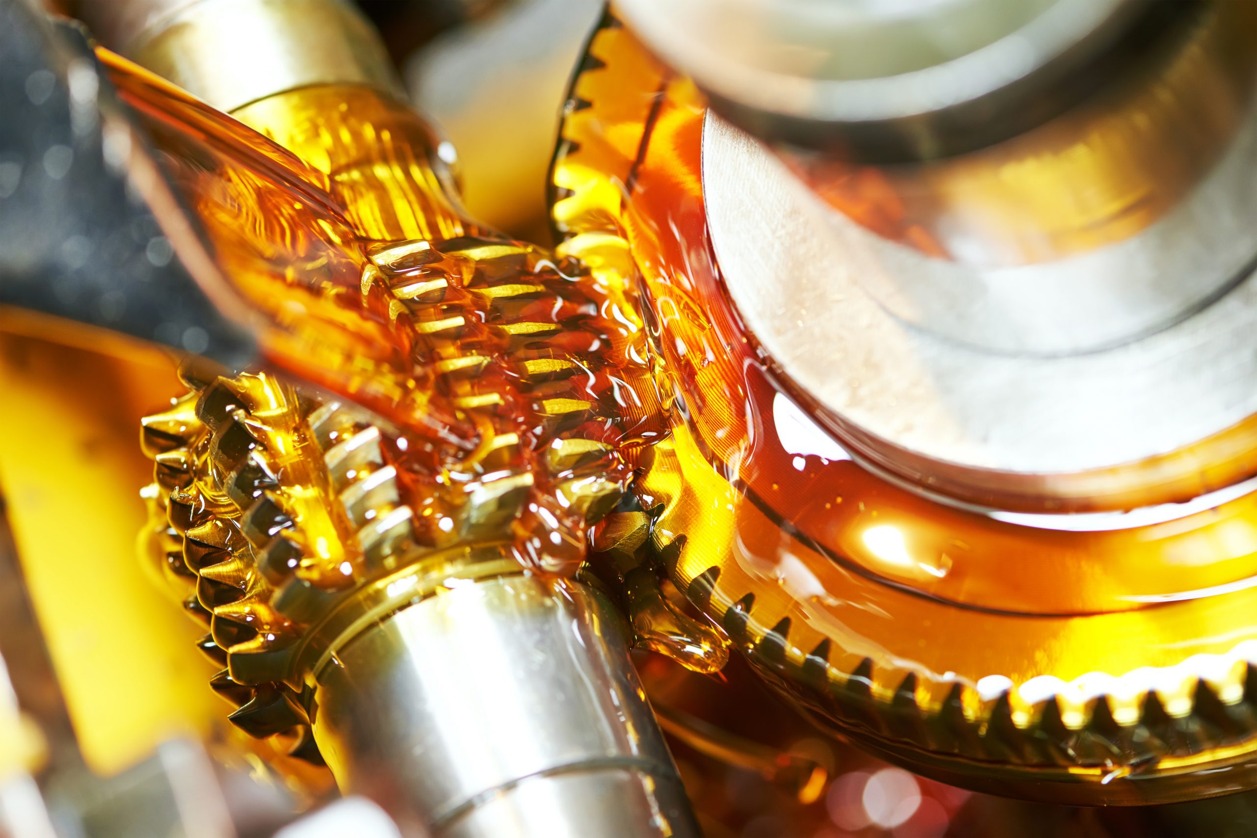

InvoMilling is the name of a proprietary gear milling process developed by cutting tool manufacturer Sandvik Coromant with the cooperation of machine tool builder DMG/Mori Seiki. This process enables a five-axis multitasking machine to produce gear-tooth geometry with off-the-shelf tooling. By virtue of new programming software, the tool path, not the shape of the cutter, determines the gear profile. Because a tool path can be reprogrammed quickly, the same cutter can produce an unlimited number of gear profiles within a certain, but rather wide, range. No additional cost or added time to change from one profile to another is involved.

The name InvoMilling represents a new concept in involute milling that is an alternative to the specialized hobbing process. It is a combination of slot milling and multi-axis turn-milling. Simultaneous motion of the X and B axes or with the Y and B axes enables the milling cutter to follow an involute path. Simply changing the tool path results in unlimited gear shapes producible with the same cutter. Sandvik Coromant has developed three disk cutter sizes (CoroMill 161, CoroMill 162 size 4 and CoroMill 162 size 6) to cover the range from module 2 to 12 or 12 to 2 DP (diametral pitch). Gears with any helix angle—both involute and noninvolute profiles—can be produced with the same tools.

InvoMilling involves several machining steps. In the first step for an outer spur gear, for example, the disk cutter performs like a slot miller to create a groove in the axial direction on the workpiece, forming the tooth space. Next, B-axis rotation of the cutter enables it to machine the geometry of root and protuberance at the bottom of the tooth space. In subsequent steps, the gear wheel rotates in coordination with radial plunging of the cutter to turn-mill the upper and lower gear tooth profiles. Chamfers on the gear tooth’s OD can also be added. Developers say gear quality of DIN6 or AGMA11 can be achieved using involute milling, with a 2 µm Rz surface finish on gear flanks. Leaving stock for finish grinding after heat treating is an option when gears of higher quality and finer surface finish are required.
