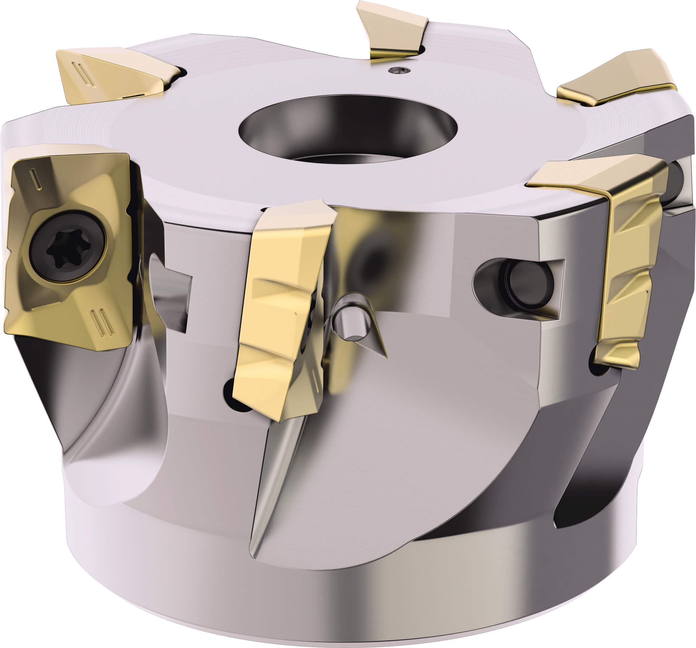

Seco has introduced two new chip splitter milling inserts that lower the stress on both the machine and cutting tool for improved milling process stability. The Turbo 12 and 18 chip splitter inserts for the company’s Turbo cutters – available in five grades for both square shoulder and helical milling cutters – significantly reduce chatter, vibration and stress on manufacturing equipment.
Turbo 12 and 18 chip splitter inserts 2
The Turbo 12 and 18 chip splitter inserts incorporate grooves on both of their cutting edges to minimize chip size and reduce cutting forces without reducing cutting data and depth of cut. By keeping chips as small as possible, shops lessen the risk of chip jamming, which improves process security and allows for more effective machining of deep pockets.
