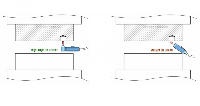

Angle vs Straight
There really are no pros and cons to each type of die grinder because there is literally no functional difference. Here is a bit more about the minor difference in structure.
Angle die grinders are built with a right-angle structure, so that the die grinder itself is perpendicular to the body. The point? They are perfect for conditions where a straight die grinder cannot fit. So, if you are working on a uniquely shaped part, or you need to bend in the workpiece, an angle die grinder is the right tool for you.
Straight die grinders are completely straight. The die grinder itself sits atop of the body creating one straight line. This style of air grinder can be a bit long, so they are best for setups that don’t require a tight squeeze.
The images below will better depict the concept.

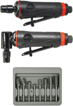

Astro Pneumatic Tool 3pc Die Grinder Kit
This set includes a lever throttle for feathering control, a rib textured handle which provides a firm grip and a rear exhaust air flow system that directs air away from work surface. Additionally, the increased motor size provides more power to make work much easier.
