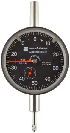

Brown & Sharpe 14.82022 Dial Indicator
The Brown & Sharpe dial indicator reads to 0.001”, with one revolution of the dial being 0.10”, and the total available measurement being 1.0”. The ball contact tip reaches into the workpiece to make accurate measurements of turned, milled, and ground parts, for tool setting gauges, fixtures, and inspections. The racks and bottom bearings are made of stainless steel for corrosion resistance. The central lug back can be rotated 90 degrees for vertical or horizontal use and the dial face is 2 1/4” in diameter.

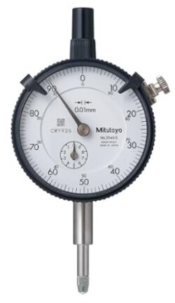

Mitutoyo 2046S, 0.01mm X 10mm Dial Indicator
The Mitutoyo dial indicator has a stainless steel 8mm stem, lug back, and hardened steel spindle for quality and sturdiness. The indicator features a hard coated crystal for scratch resistance and technology for improved resistance to dust and water, making this tool great for a variety of shop environments. It also has a graduation of 0.01mm and range of 10mm.

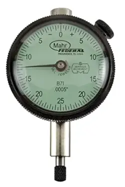

Mahr Federal B7I AGD 1 Dial Indicator
The Mahr Federal dial indicator is used to measure dimensional deviations. It has a measurement range of 0 to .75″, graduations of 0.0005″, an accuracy of ±0.0005″, and a range per revolution of 0.050″. The dial is light green for easy reading and includes inch recognition with a contrasting hand, for readability. he dial is balanced with a reading of 0-25-0, for comparative readings.

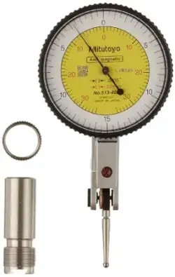

Mitutoyo 513-406-10E Horizontal Test Indicator
The Mitutoyo dial test indicator features a .079″ carbide contact point. Uusers have expressed high praise about this tool for its smooth use and accurate readings. This test indicator has graduations of .0005″/0.01mm, a range of .030″/0.7mm, and a dial face of 0-15-0/0-35-0.

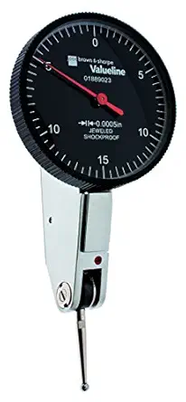

TESA Brown & Sharpe 01889023 Dial Test Indicator
This Brown & Sharpe dial test indicator is a lever-type indicator with a 1.5″ dial diameter, 0.0005″ dial division, 0.030″ range, 0-15-0 marking, and a black face for clear readings. This dial test indicator measures with +/-0.0001” accuracy making it both reliable and affordable. This model also features a dovetail mount.

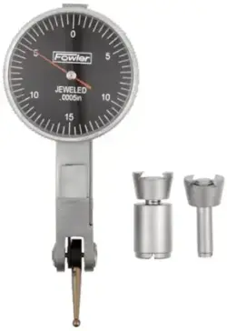

Fowler 52-562-778-0 Dial Test Indicator
This test indicator includes bidirectional constant clockwise rotation, automatic reversal, three dovetail mountings, jeweled movement, two dovetail clamps and a molded case. This test indicator has a range of 0.030”, dial reading of 0-15-0 and graduation of 0.0005”.

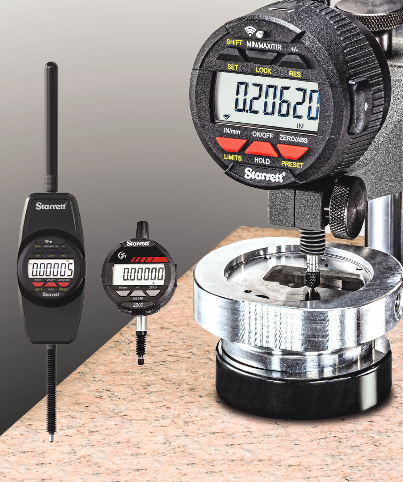

Digital Indicators
Dial indicators are available with digital readouts too, although most machinists prefer the analog dial. If you are a digital tools advocate, Mitutoyo has a great option:
Mitutoyo 543-783B Absolute Digimatic Indicator

Of minor concern when setting up a test indicator is the orientation of the contact arm to the work movement, and is specific to manufacturer and even model. Some provide optimum accuracy when positioned at 90 degrees to the work; some specify that they are calibrated at a 15 degree angle. The difference in reading is usually insignificant, but is measurable (“sine error”).
its actually a cosine error and only applies to test indicators that have the lever arm for measurement.the 15deg is the angle between the lever arm and the surface being measured. if the angle is greater than 15 degs, the length of the lever arm is foreshortened to the point that it affects the measurement. compute the cosine of 15 deg=.966, its pretty close to 1. that value times the length of the lever arm is the foreshortened length which is less than the the calibrated lever arm length.
